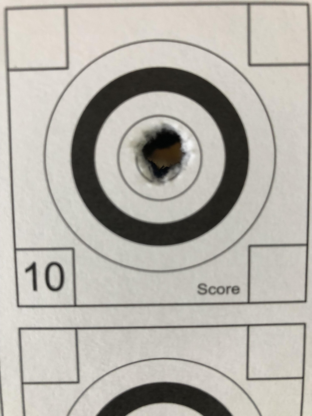

I only build competition guns, so the group sizes and numbers must be representative of what you will encounter in a match situation. Most guns will print a good 5 shot group. Very few will print a good 75 shot group. That’s the difference between an average gun and a competition gun. Competition guns must do what you expect on demand every time.
Most American FT matches are 60 shots. So a FT gun should be able to shoot at least that many shots that go where expected. Like Will said...what good is a great 5 or 10 shot group if you’re going to throw a flier every 15.
Here is a 75 shot group at 25y with a 20fpe FT Carbine. This is a full full.

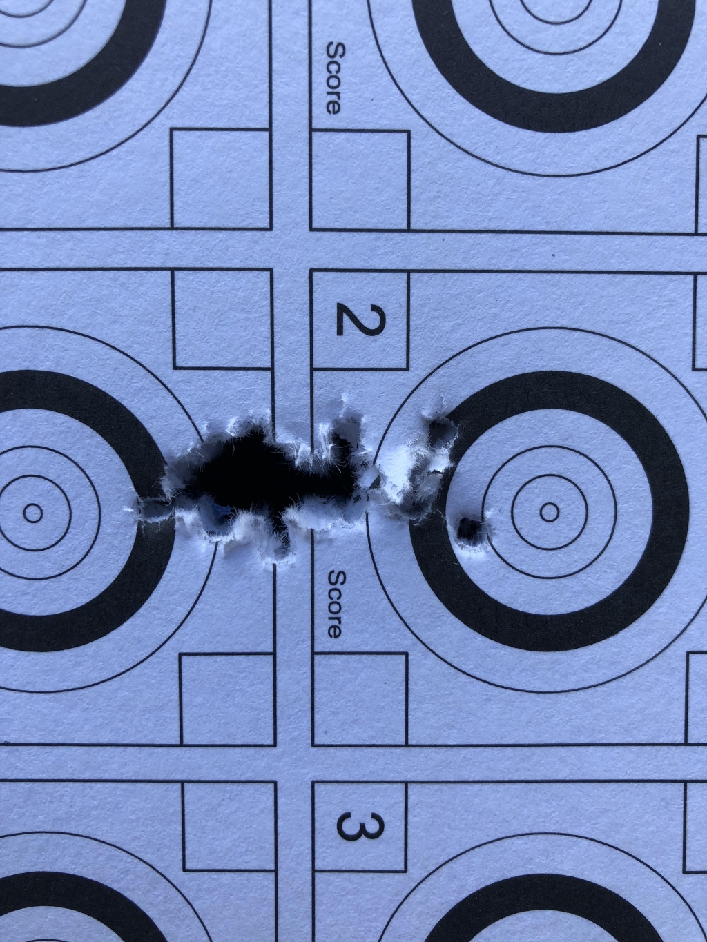

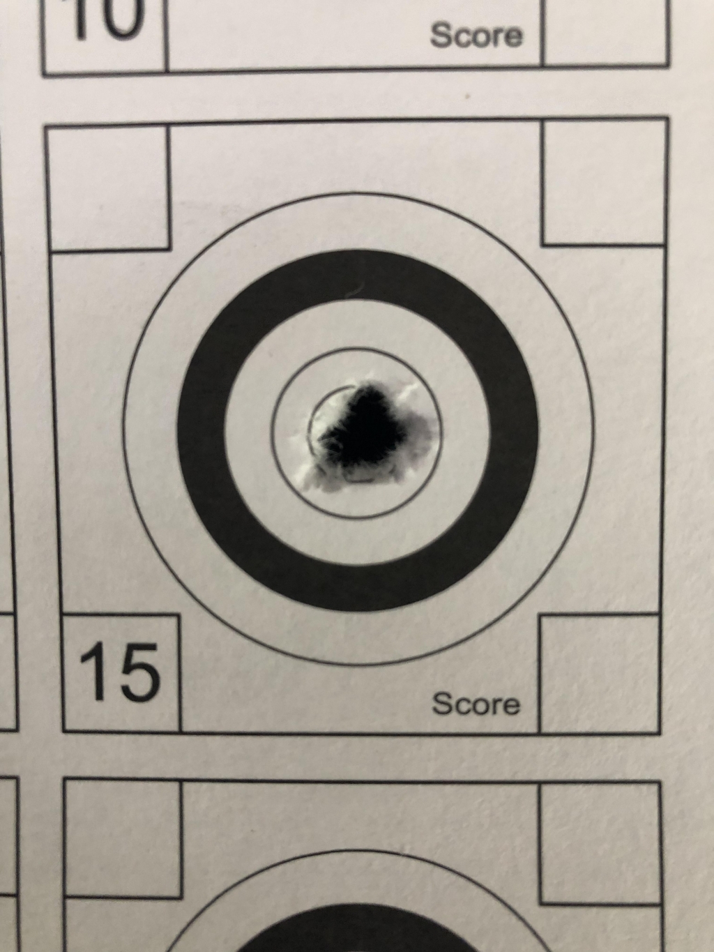

Here are some groups on 12fpe 15” FT Carbine rifle leaving my shop today. This rifle has a titanium shroud/brake combo on it that is new for me. The 25y group is 125 shots at 25y indoors. The 55y group is 75 shots in 3-5mph wind. I did not attempt to hold for the wind. Just held on the bull to the right. The 55y target was standing up sideways.
This is what I expect when everything is working harmoniously.
Mike
I’ve seen so many people post a five or a ten shot group and call a couple fliers their fault. If you are going to do that what’s the point. Just shoot the three and put your gun away.
