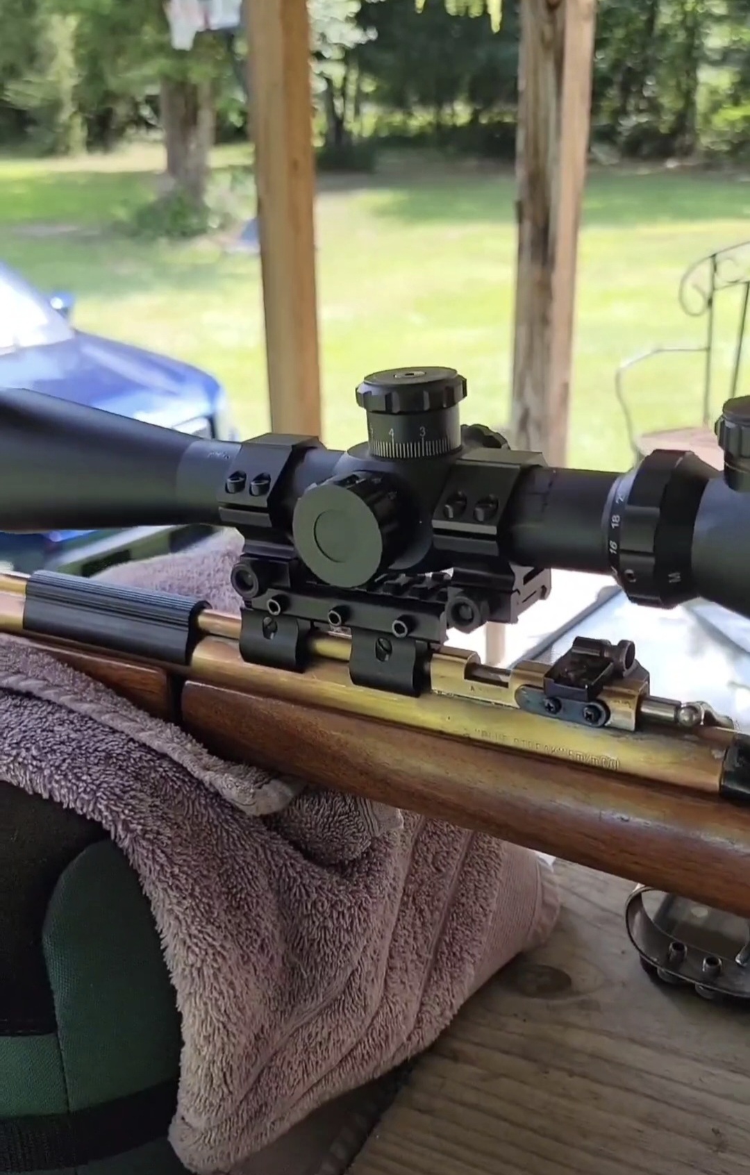

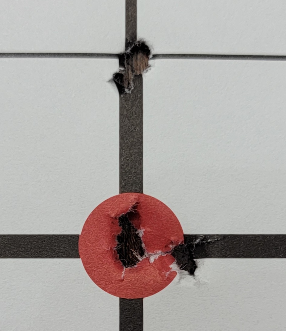

Mine is a Sheridan and I don't experience windage changes from plinking to full hunting loads.
It only has elevation changes with different power settings.
This was zeroed for four strokes at thirty yards. The flyer is an accidental five stroke shot that gave me one inch elevation at thirty.
1972 Sheridan Bluestreak, JSB 13.73, scope is an Aim Sports, 6X24X50.
