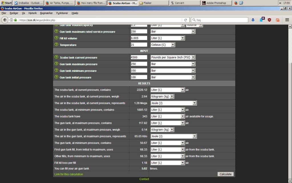

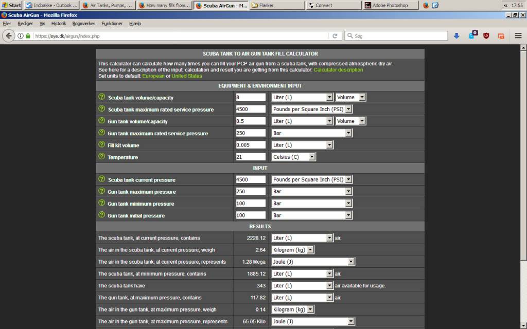

Is the 88cft the volume of air in your tank at 4500psi or is it the actual volume of the tank???
If it is volume of air then your tank is @ 8 liters in internal volume and the result is something like this given the FX tank is 500cc:
And the result is 5 full fills and then down from there.
