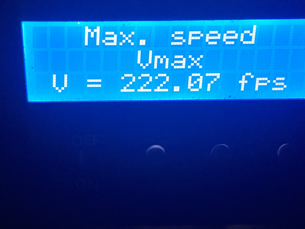

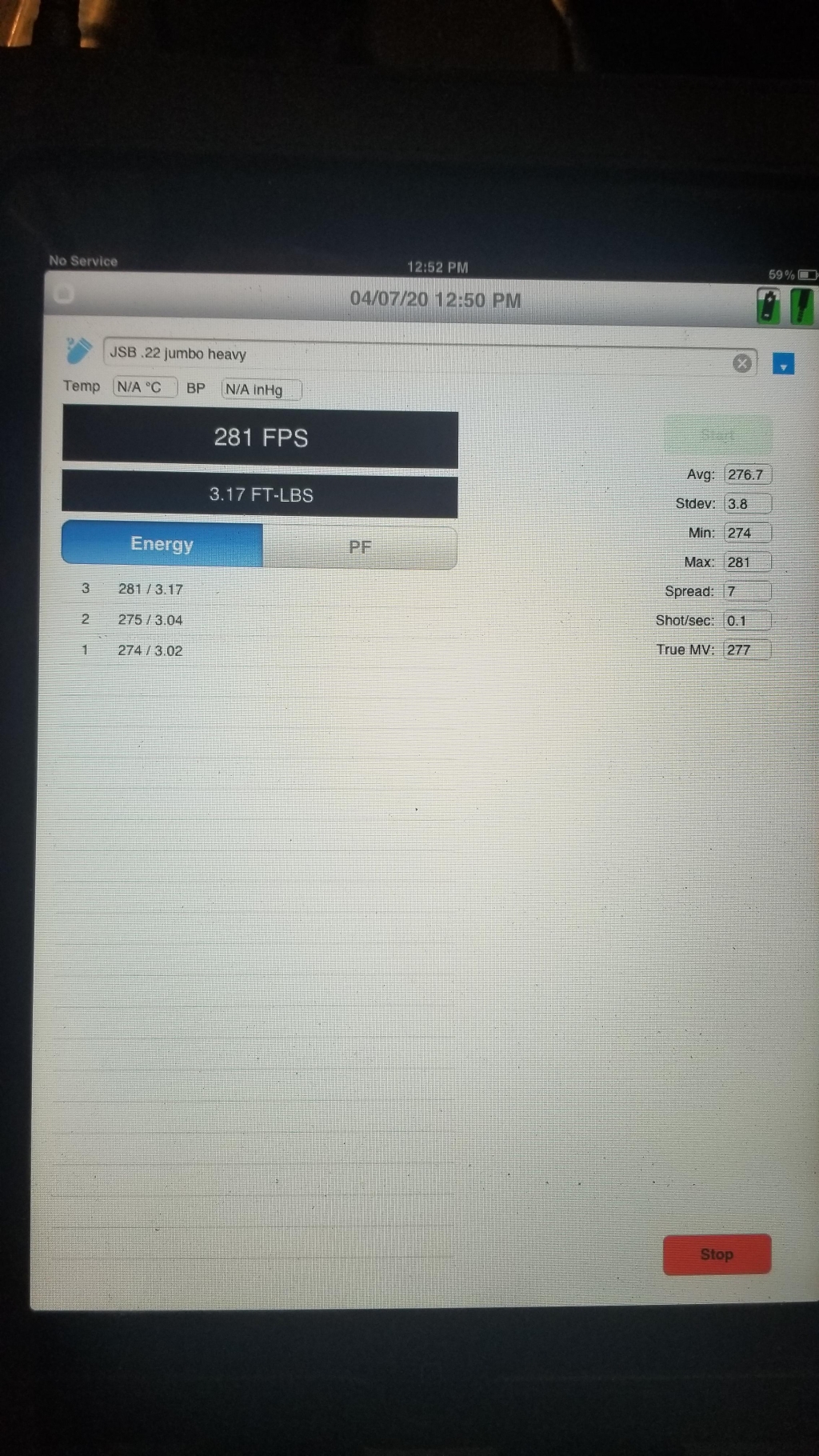

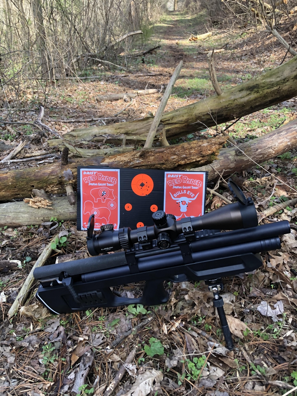

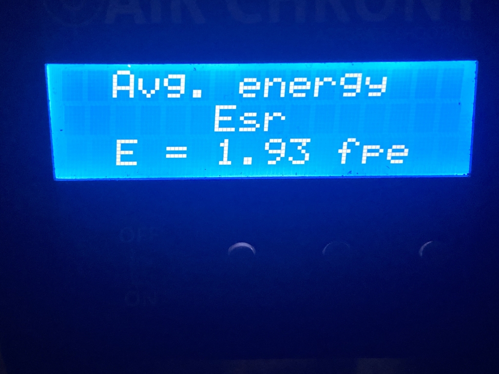

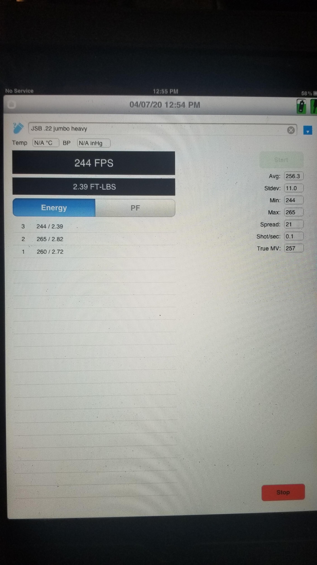

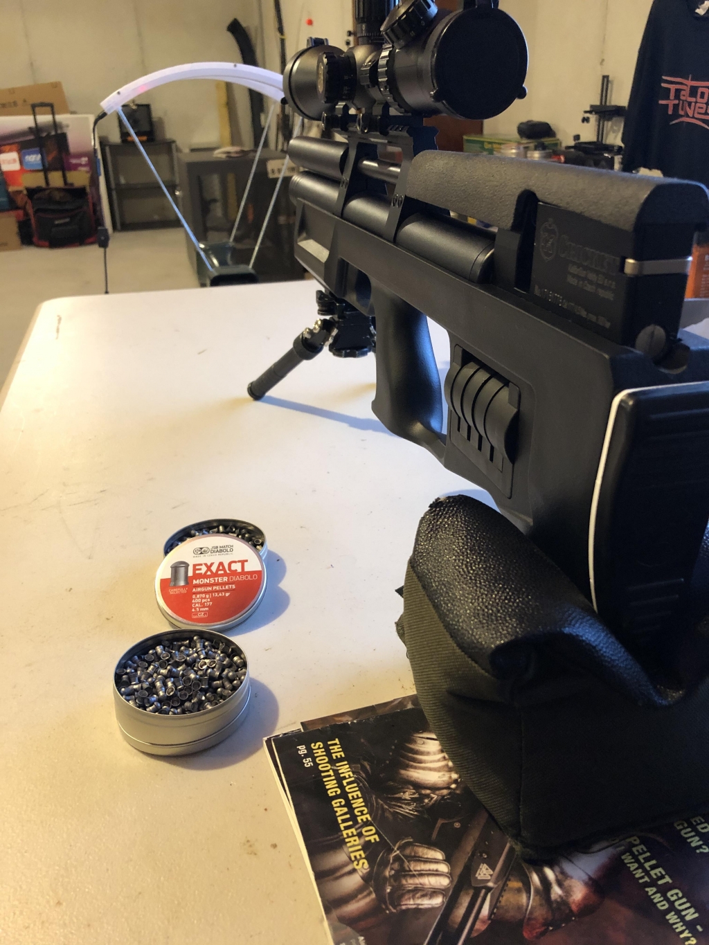

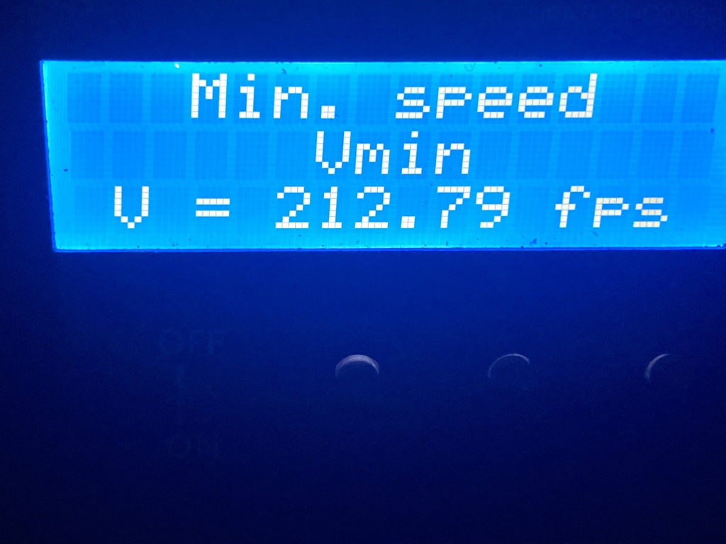

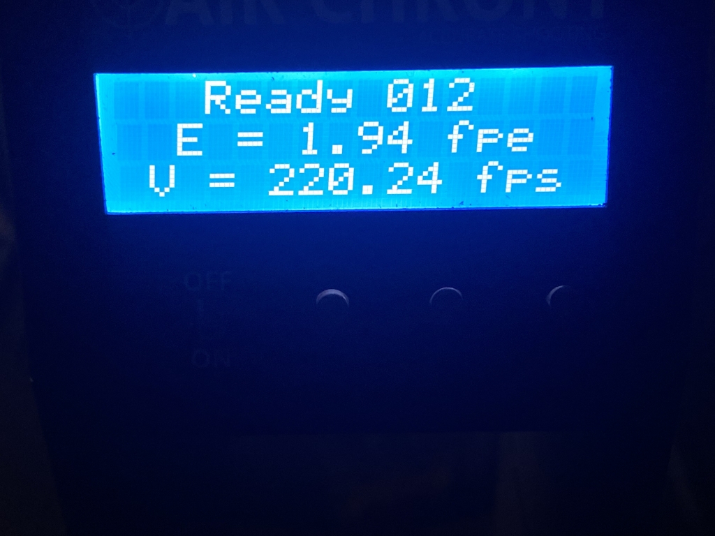

Looking pretty good for a plinker at 15m considering that was without the benefit of a scope. The 220fps sampling tips a hand to vertical stringing but it’s too few to draw a firm conclusion.
I honestly didn't realize how bad the drop was until I punched the numbers into Strelok. It's kind of weird shooting close range like this and having serious hang time before impact 🤣
