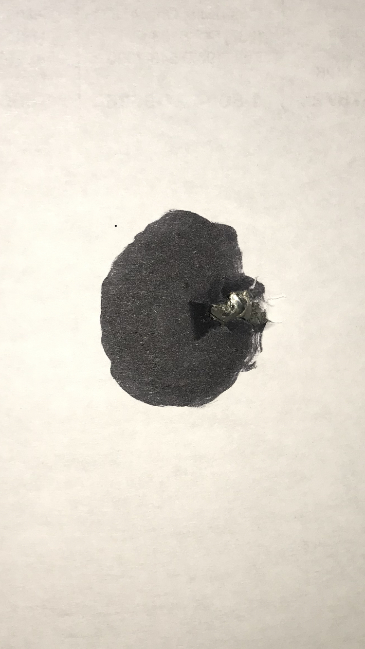

Meisterkugeln and Hobby are one hole in the basement. FTT all head sizes are slightly smaller groups. JSB jumbo express 14.35 are like a scattergun. JSB rs are one hole with a random 1” flyer here and there. Crosman hollow points are one hole with crazy flyer every now and again.

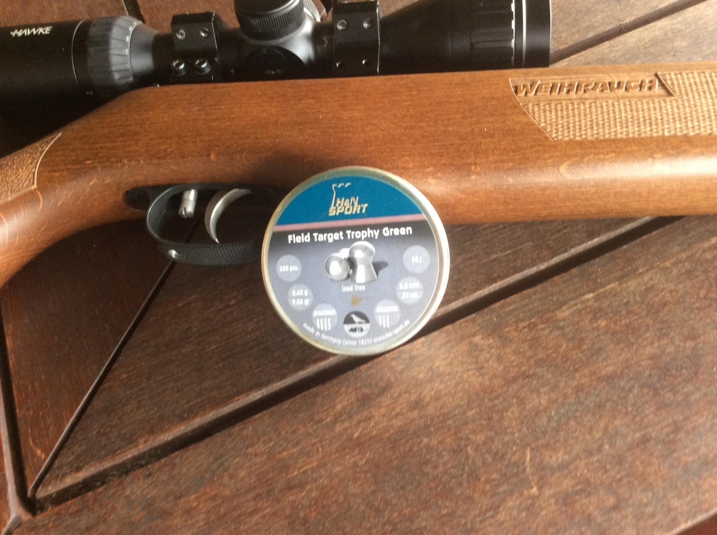

I read that article as well. I shoot the 9.56 and 12.65 Greens in my HW50S and Hw77. The author said take this with a grain of salt and pure speculation that the greens would damage the barrels. These pellets in my two rifles produce the best accuracy and fps in both my rifles so I’m staying with them until a more scientific answer is available. I also figure if the greens do damage the barrels I’ll be long gone by then and not worried about it or maybe run a few lead pellets through them after they have there turn on rotation.

If you get the chance try the 9.56 Ftt’s, they are the most accurate in my HW50S. At 35 metres they will go through both sides of a pellet tin where as the lead FTT 14.65 will barely go through one side. I don’t think you will be disappointed. Also there is imo no difference in discharge noise between the two pellets. I suppose it would be equivalent to a 177 HW50S shooting a 10 grain pellet. Let us know how they go.

I got some predator got 11.75 but no 9.56 ftt they are out of stock at pyramid air. Aoa had the ftt greens in stock but wanted too much for shipping. The Gto’s shot great. I had to clean the barrel and remount my scope because it was moving and only had time to shoot 5 pellets but they were the best group I shot in my life I think. Just kinda stacked on top of each other in the pellet trap. Thanks for recommending the lead free. In April I’ll order some 9.56 ftt greens when they are back in stock.
