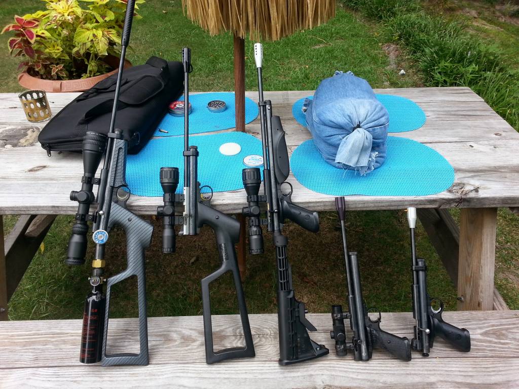

Jim Giles of Crooked Barn fame recommended max 14.5" bbl for stock gun. My collection of CB's . +1 on what Nervous trig said.
