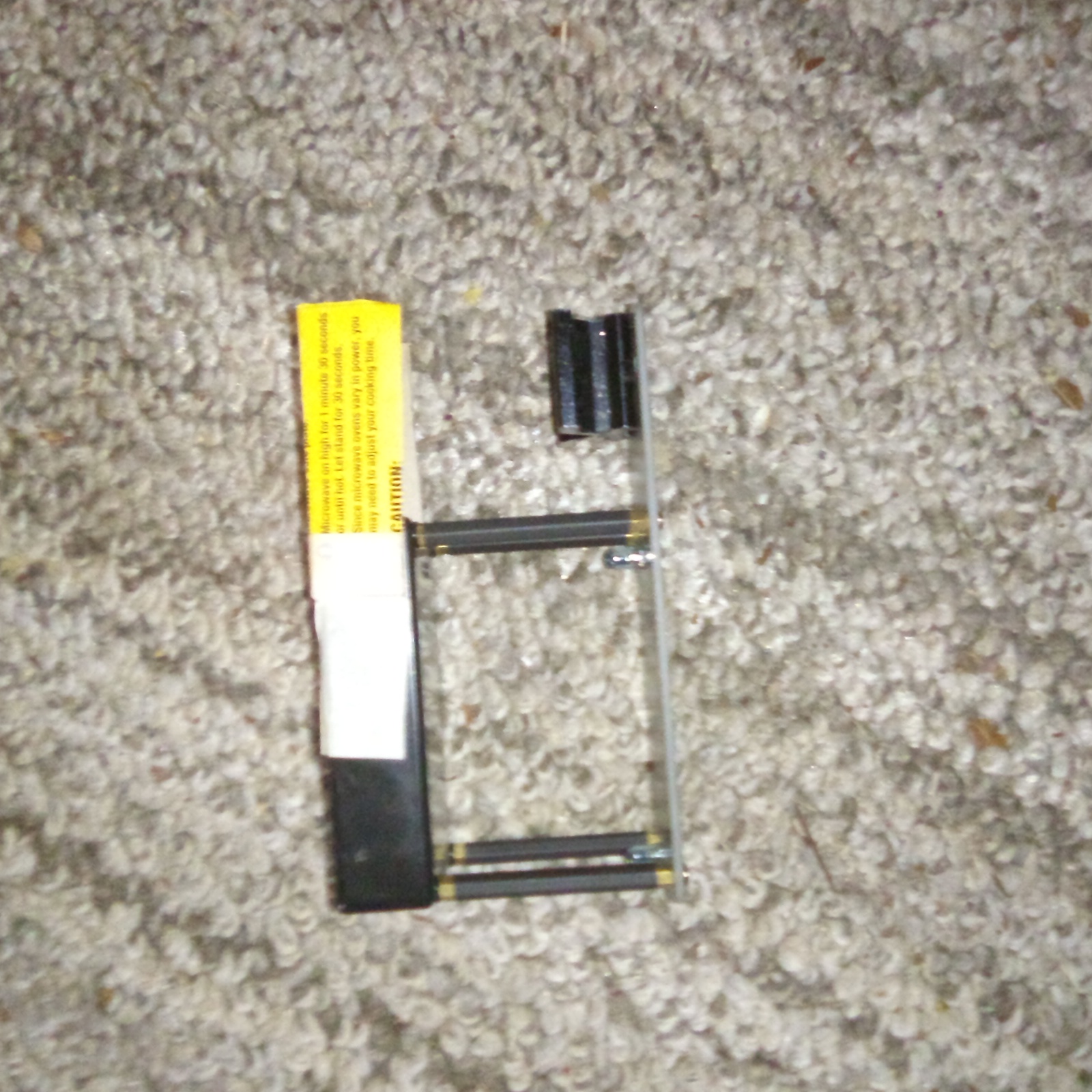

I had an Alpha and was a bit of a pain, then a Caldwell and I liked it better, got a cheap 50 bucks Amazon one about a year ago and that little thing is wonderful, works in any contitions and the numbers match the Caldwell
This is the one:
