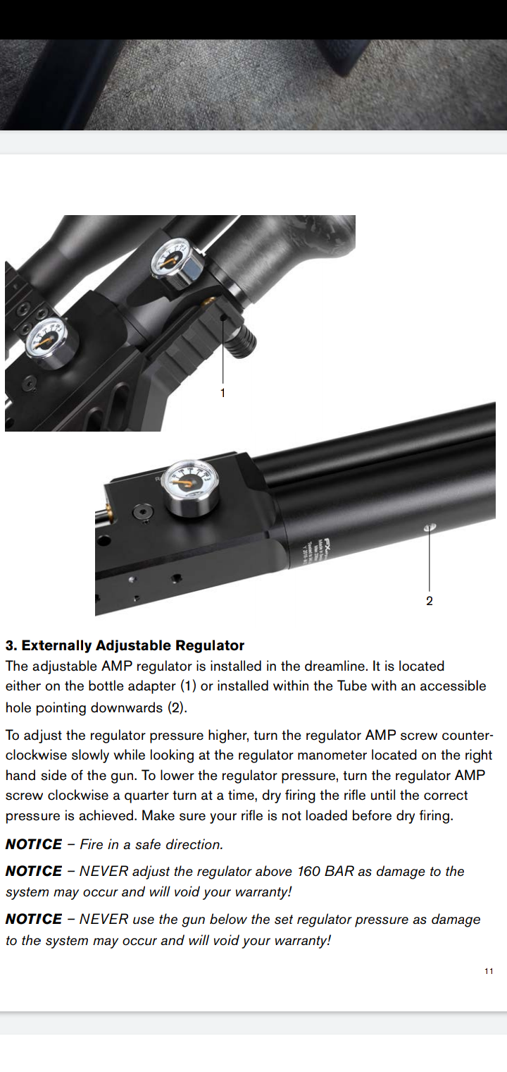

Tuning How high can you adjust the AMP reg on FX guns?
Don't go over 170 bar. That is from fx usa. Some ppl will push it over 170 but can damage the reg. Why anyone wanna go that high beats me. 150 is where I set mine and is plenty of power..
"Why anyone wanna go that high beats me."
Because everyone is different.
Lol im not planning on pushing it to 170 bar, but maybe around 160 for my dreamline to get a little bit more speed out of slugs for straighter shooting.
Seems FX has said to 170 is OK in at least one email. Maybe 160 is stated elsewhere. 150 as plenty? Probably for some. Probably not for others.
