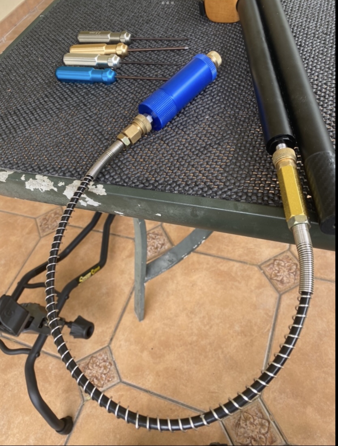

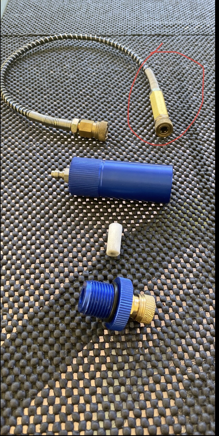

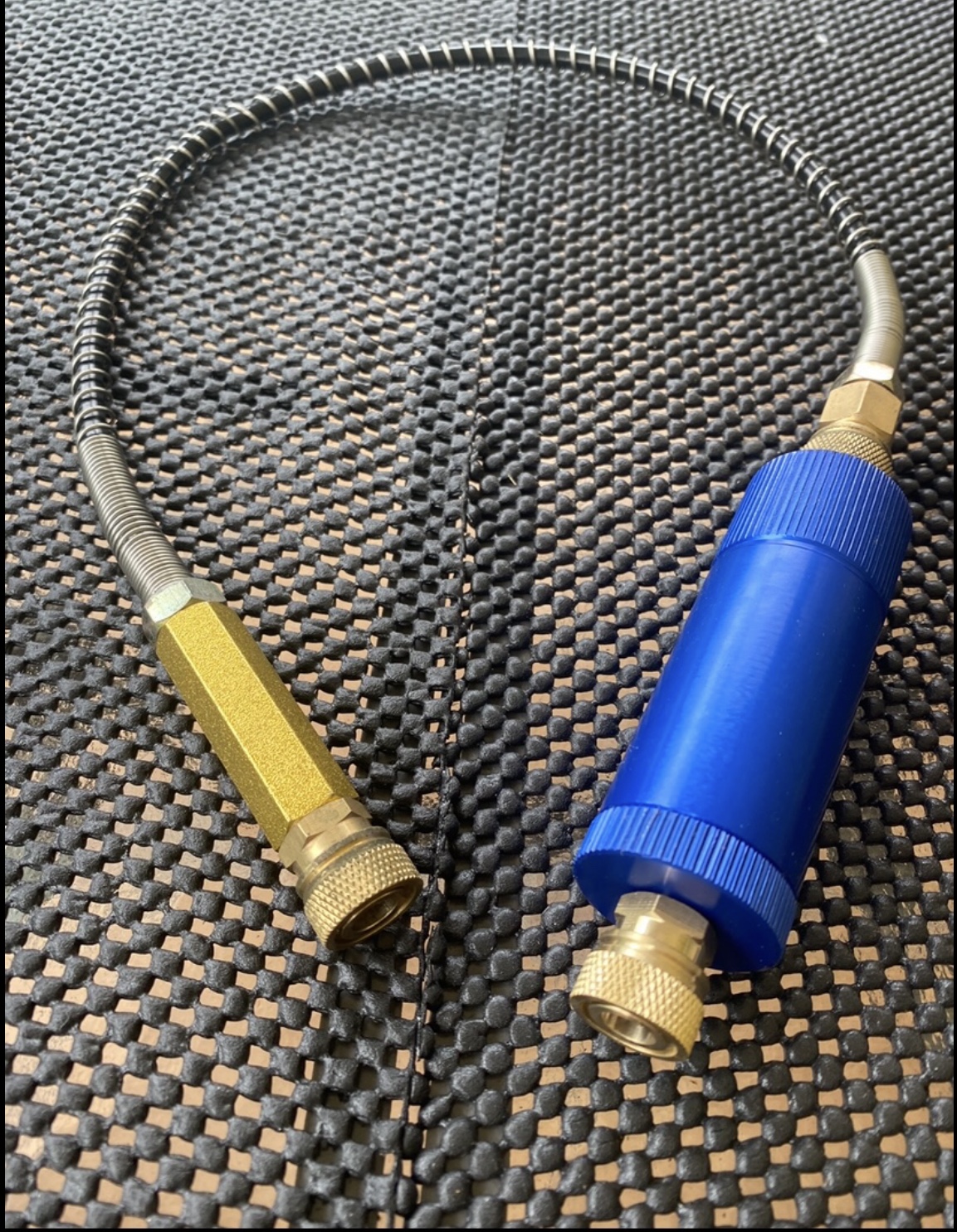

You only need to add this water/oil separator to your compressor. I use two with mine to be in the safe side
Thanks Ray. The white filter looks like an expendable that you would replace periodically. How long do they last? Do you need to drain and dry the metal housing after each use? Where might I find the type you are using?

I think the built in separator/filter does a decent job, but I added on the same inline filter that Ray_PR did.
They are cheap enough and it is just that extra bit of protection with no real downside.

I have no experience with that pump, I use a YH. But if you can arrange the air hoses so they flow back to the pump and then open the bleeder every few minutes it will reduce the separation whatever filter you use has to do. I just did a 20 minute run on my YH today to fill my 45 minute SCBA tank from 3000 psi to 4000 psi. I vented every 5 minutes. A noticable amount of water came out each time. I have the cotton filter that came with the YH and a separate unit I have color changing beads in. I replaced the cotton filter (I got a bag of 100 pretty cheap from allibaba) and checked the beads. They are still orange, haven't turned black yet. After 4 or 5 runs like this. I got maybe one drop of water out of the cotton filter. I live in SC where it is pretty humid. I could reuse the cotton filters after letting them dry out but they also get a little oil contamination on them.
The blue one in the picture already posted looks like the one that came with my YH. Something like that and a bag of the cotton filters it uses should be enough, I think. I would check the filter after each run to see how much water it is catching. If you do and it is staying dry, then you could back off to checking after more runs.

I bought a fill set for my SCBA tank from Joe B. and am very happy with it. I'm also sure it is possible to make an inexpensive chinese made moisture filter fail. But I own two and if I compare the wall thickness they have to the air chamber on my PCPs it is hugely different. The moisture filters are probably a lower grade of aluminum but still the wall has to be at least 5 times as thick. I do not worry about them at all. I lost an O-ring in one but that is the only bad thing that has happened. My black extra filter on the YH came with a couple plastic cartridges. I took out the charcoal and whatever else they had inside and fill the space with color changing beads. My extra one stored on a shelf in a zip lock bag had picked up enough moisture the beads need dried or replaced. The cartridge in the filter is still mostly orange showing it is not loaded up with moisture.
