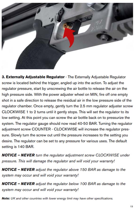

To degas your Impact,
turn the regulator screw out [counter clockwise] slowly until' you hear the air start hissing out..
Don't remove the screw.. Loosening it a bit will do the trick. [2.5 mm sized allen]
It is strongly recommended Not to fire these rifles with little to no air pressure..
That can potentially damage components.

So you must remove the bottle AND degas reg pressure to lower reg pressure?
Correct. If the bottle is on - It is constantly feeding psi to the gun/reg. So it has to be removed first.
Even after removed, there will be residual air in the system [on the regulated air side]
That air has to be bled out also. [So no air pressure will fight against the reg components/system]
I've always dry fired my impact to remove pressure and lower reg BUT was wondering if that was necessary.
FX / Ernest Rowe / Etc. all warn against doing this - As a precautionary measure.
You can 'dry-fire' with regular pressure or low-ish pressure, but not with no pressure.
Simply loosening the reg adjuster screw or the reg gauge will bleed air out of the system..
There's no need to risk potential and preventable damage when loosening things is so effective and simple..
So lowering reg pressure could damage the gun even with bottle removed?
With the way they've designed things, they don't advise adjusting the reg screw 'in' / 'clockwise' aka lowering it
while there is any air pressure in the system. So again, yes. No tank doesn't mean no air pressure,
IF there is still residual air / air-pressure on the reg-side.

https://fxairguns.com/wp-content/uploads/2019/02/Fx_impact_manual_ok.pdf
That's the only 'manual' that FX has given us to go by.
It's the one I had burned into memory..
Especially this 'warning section'
I can't trust my new guns, their gauges, their regs [at the moment]
so that led me not to trust the claim that the new AMP reg wouldn't die if I adjusted it 'down' w/ pressure in the system..
I've been forced to take the 'better to be safe than sorry approach'.
**SIGH**
Sam -
PS: It was said NOT to go below 100bar on the reg.
My Impact showed up with the reg needle pined to like 80bar - hence wanting to bring it up to at least 100bar..
That's what got me started with this whole mess..
**SIGH**
Sam -

The rules of the pre-MK2 talk about the old regulator in the Impact. If you're applying the rules from the old reg onto the new one you will have issues, if you degas the gun that often you will most likely cause leaks then complain about FX some more. I've seen lately some .22's with the power plenum coming with the reg set below 100 Bar. I personally wouldn't shoot it below 100 but having the reg set below is still having a positive effect of efficiency. I.E just because the reg is below 100 bar doesn't mean you have to shoot it that low. :) That "manual" is for MK1 Impact and reg rules do not apply.
The Impact is constantly evolving platform and its up to you to make sure the rules you're following and telling others to follow are correct or you're just making a simple thing more complicated for others as well as yourself. There's people here more than happy to jump on the FX are poop guns bandwagon as you've seen even if it is coming from a place of ignorance.
If you're not happy with the Dream-tac regulator send the gun back. I have been playing with the AMP regulator for 10 months now up and down under pressure and have been very happy with it, as have many others. Not many people are replacing this reg with Huma like they did with previous models because they work and they work well. Are there some bad ones out there? Sure, but I think many of the problems with the Impact are user error.

So if you knew that and know that, why are you degassing the gun every time you adjust the regulator? FX know that you're degassing the gun with every regulator adjustment?
The keep it below 150bar on the reg is for the old regulator not the AMP reg but I'm sure you know that also.
