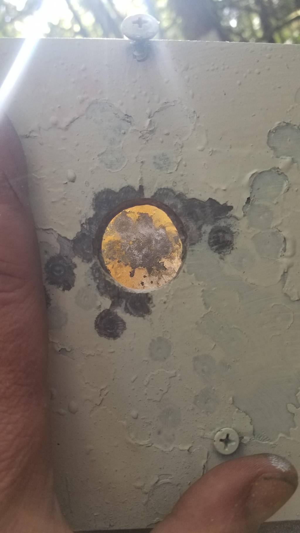

Yeah i just shot some out of a slug liner last weekend. This is at 50m at 940-950 nothing amazing but soo cheap i couldnt resist grabbing a few tins.
This is 28 shots and hole in steel plate is 1 inches
