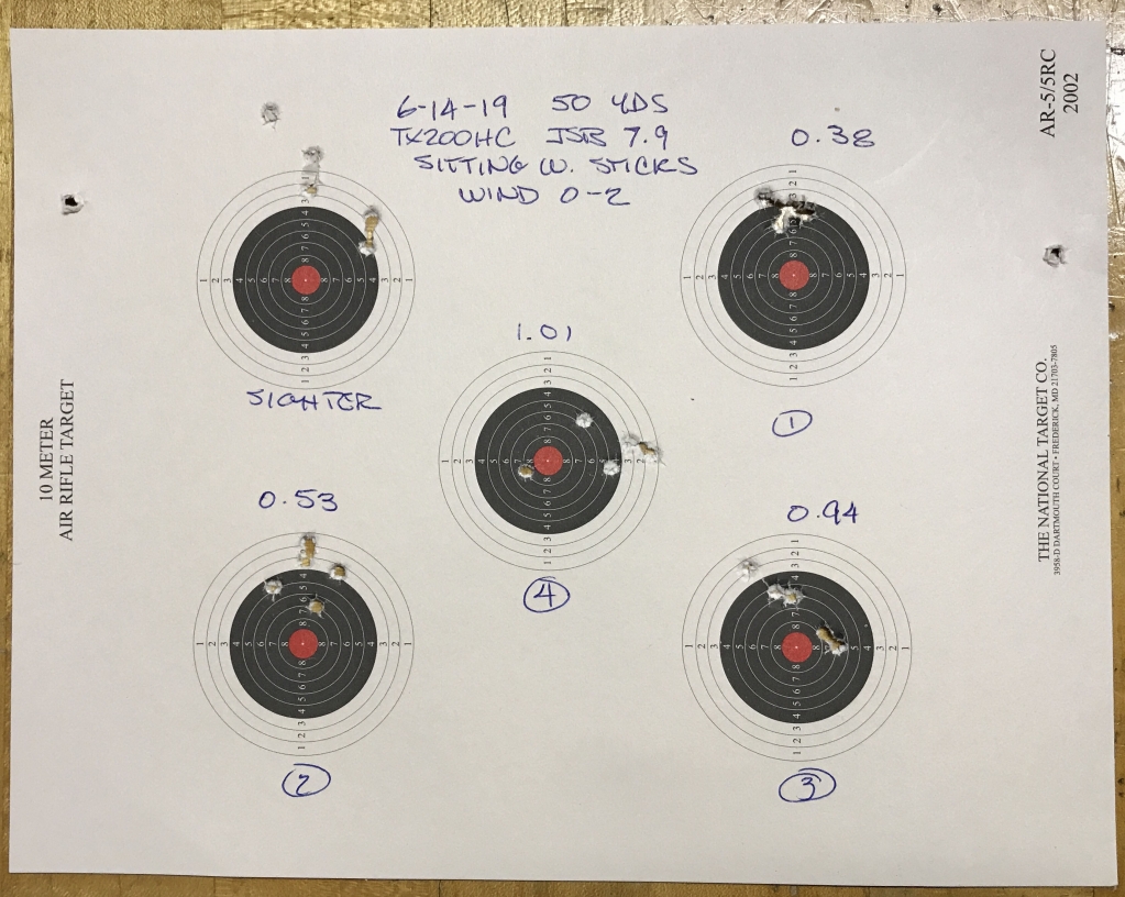

To finish up, here are today's groups from my TX200HC at 50 yards sitting. I got off to a good start, but kind of lost concentration as I went on. Oh well, maybe next time.
