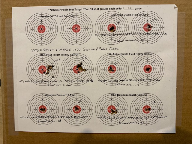

I have a "blend" of .177 and .22 pellets that I test every new rifle with. Invariably, one pellet will way out perform the others. I have attached a test target for a new Weihrauch HW100 I received yesterday that I just put through the test. I have also attached blank targets in both .22 and .177 should anyone find any value in using .

Damn man, that looks a lot like the groupings I got, like center right vs center left.
