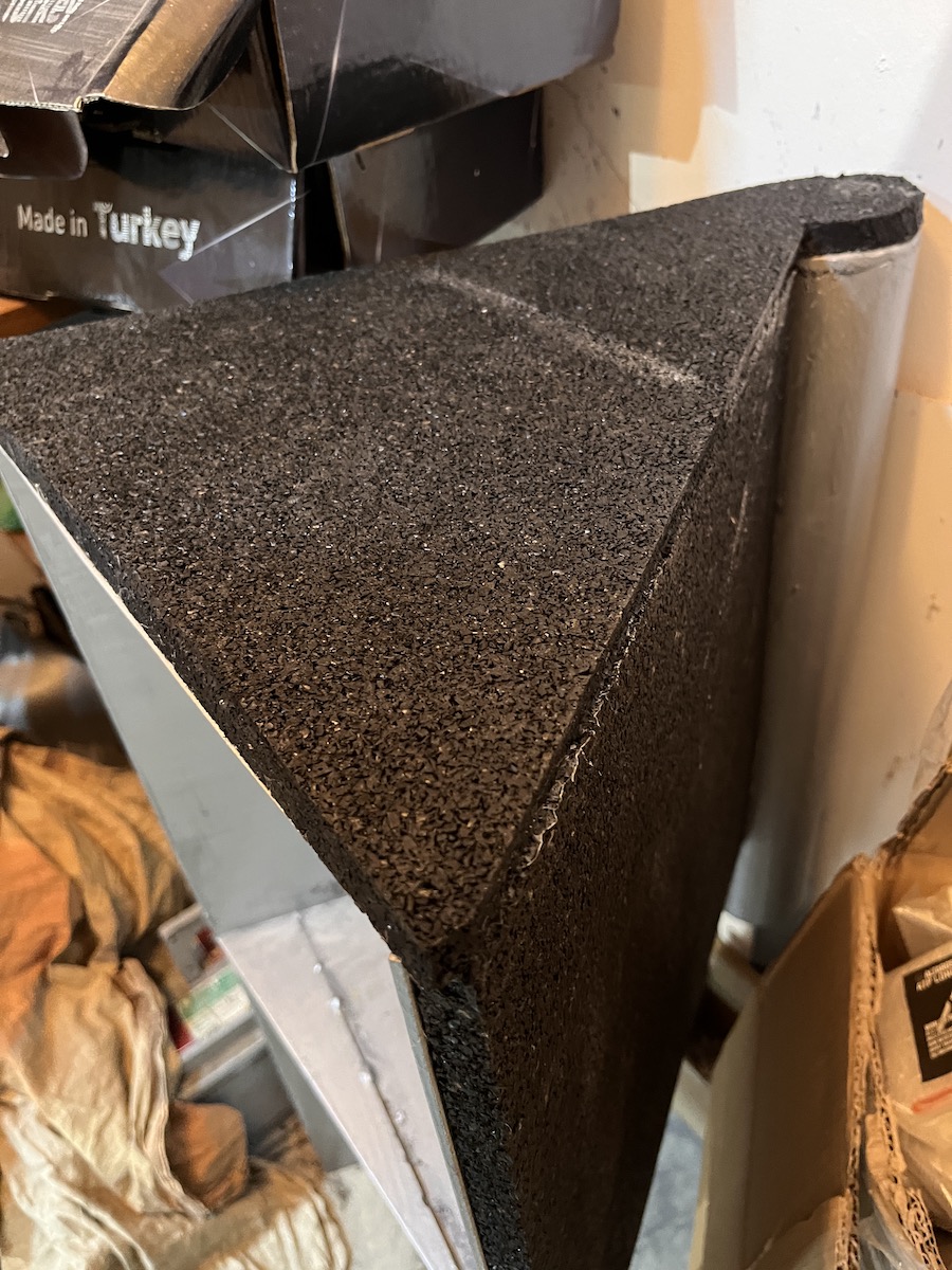

I used something like this one:
20mm thick..
Glued it with spray glue and i can say - it works perfect :) Allmost no noise
Reactions: GeneT
The rubber mat goes on the outside, much like the coating under SS kitchen sinks.
Sorry, I was unclear. I understand that you put the matting on the outside and that was the impetus for my question. I was wondering how well matting on the outside worked since my design is not amenable to interior matting. Your answer was informative. Thanks again,
GsT
GsT
Any time!!
I cannot swear how well it would work in this instance, but I HAVE coated a few things in my life (like a SS sink, and a steel tank) with rubber & adhesive, and it made a big difference. If I were you, I'd try it with some spray adhesive (less permanent), and see if you liked it. Then if it works well, adhere the mats with something like Dicor or marine sealant; spread it on with a spatula, clamp or weight for a few hours, and you'd be in business.

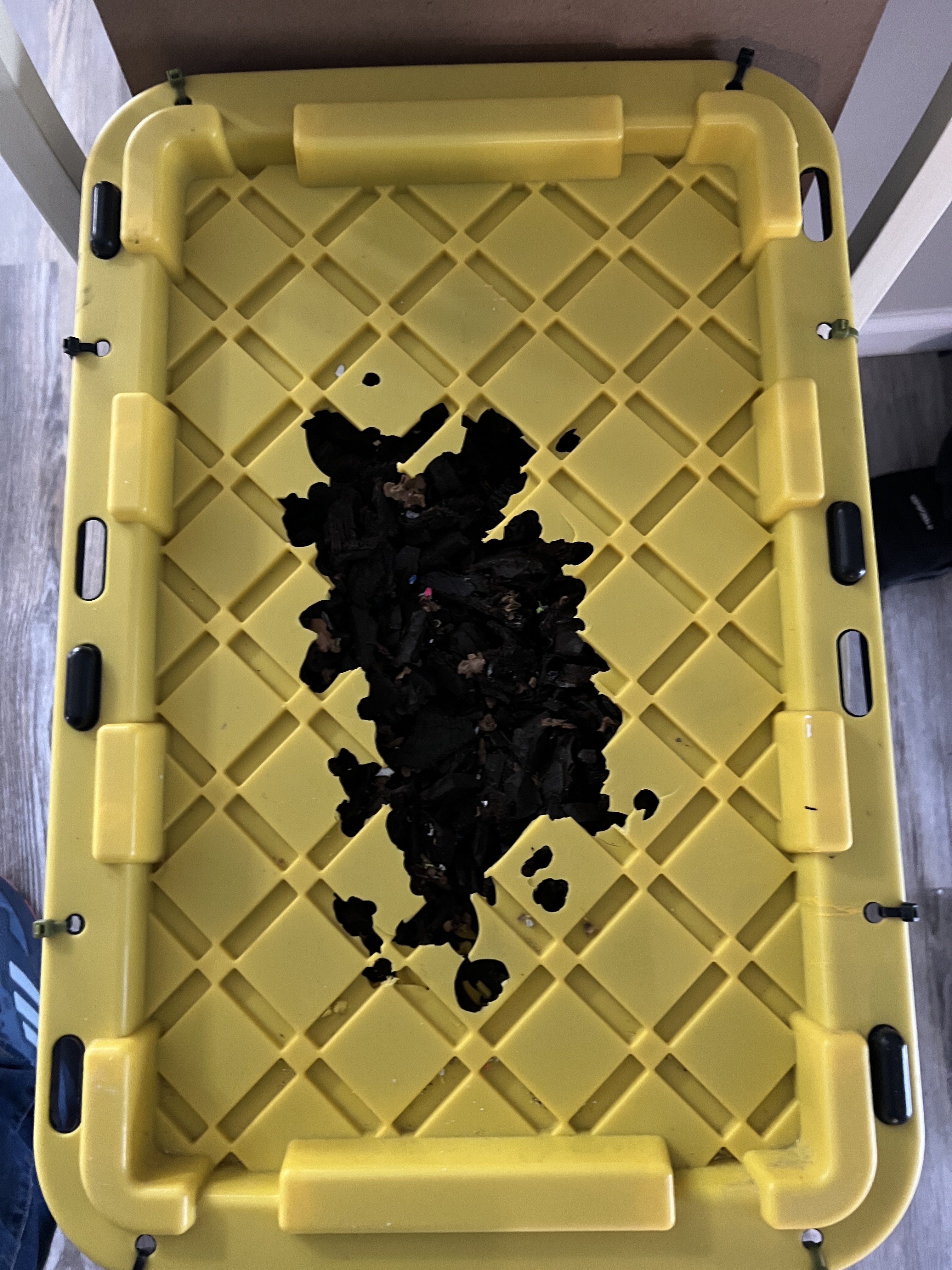

This never actually happens in my experience. The cardboard box ends up needing replacement long before penetrating the mulch is an issue.
