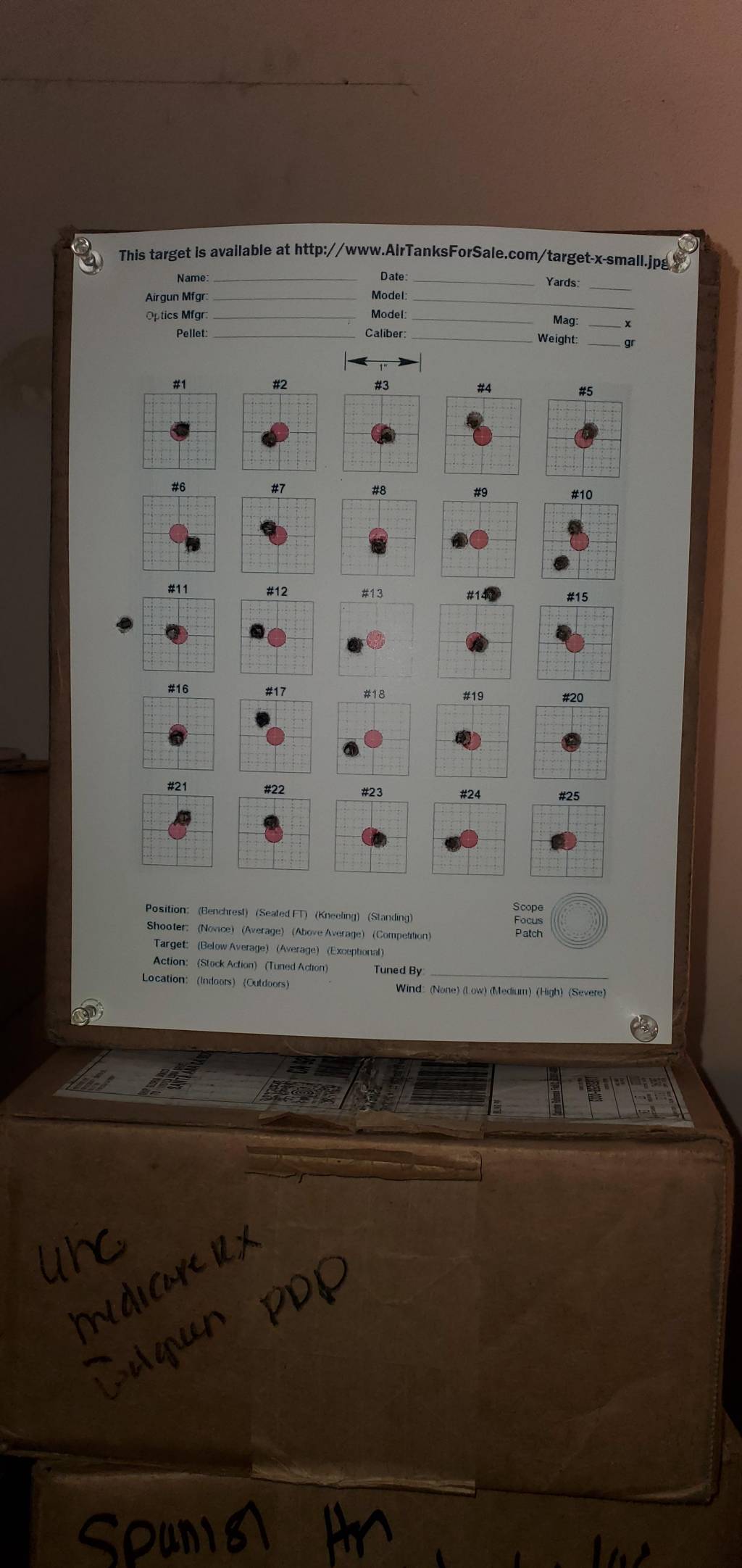

...I will place a 5/8" piece of particle board behind it...ain't shot it none yet...
...methinks I will just leave the mulch in the plastic bag it came in...
...I am using a regular .22 trap now but that is loud and splatters lead...tears up the targets...sprays aboot the room...
...the cardboard/newspaper boxes start to make a mess pretty quiclkly...there is getting to be a bit of confetti aboot the place...
