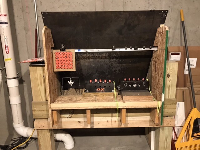

I ordered 12x12 1/4" steel plates on ebay [cheaper in small pieces and able to be shipped] and used construction adhesive to glue them to a wooden backer and put 16 inches of rubber mulch in front of it. I have not heard a pellet get through the mulch, but the steel plates give me peace of mind. Cheap way to make a really solid trap.
https://www.airgunnation.com/topic/homemade-steel-backed-pellet-trap/

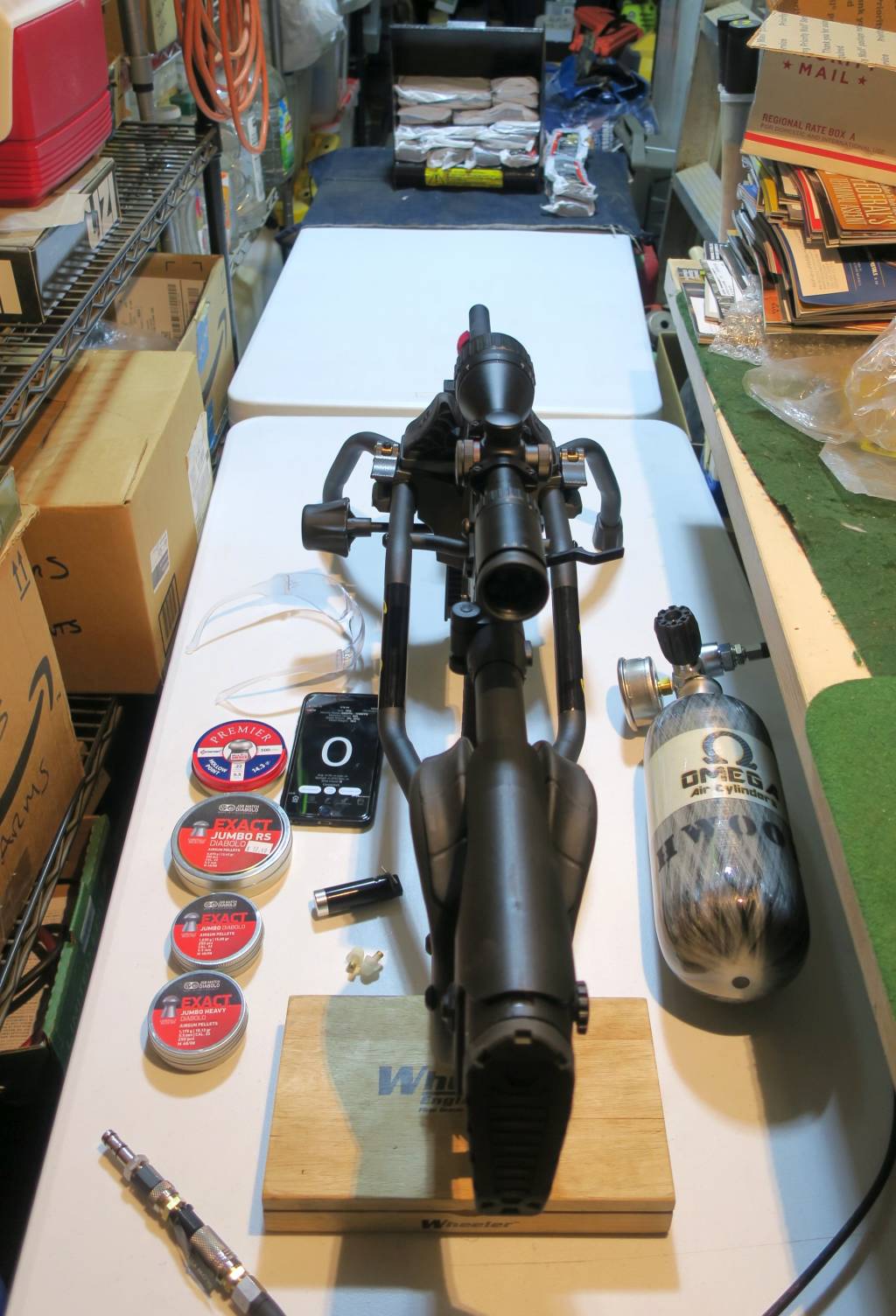

For an indoor target just recently used for chrono testing of a loud gun, I used a rimfire bullet trap filled with duct seal. A few pellets bounced off, but ended up no more than 12" from the front of the box.
