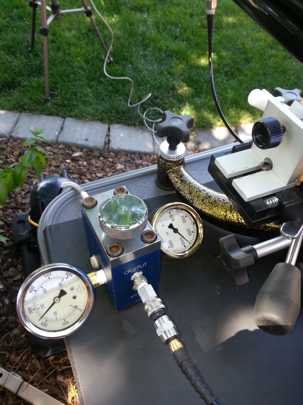

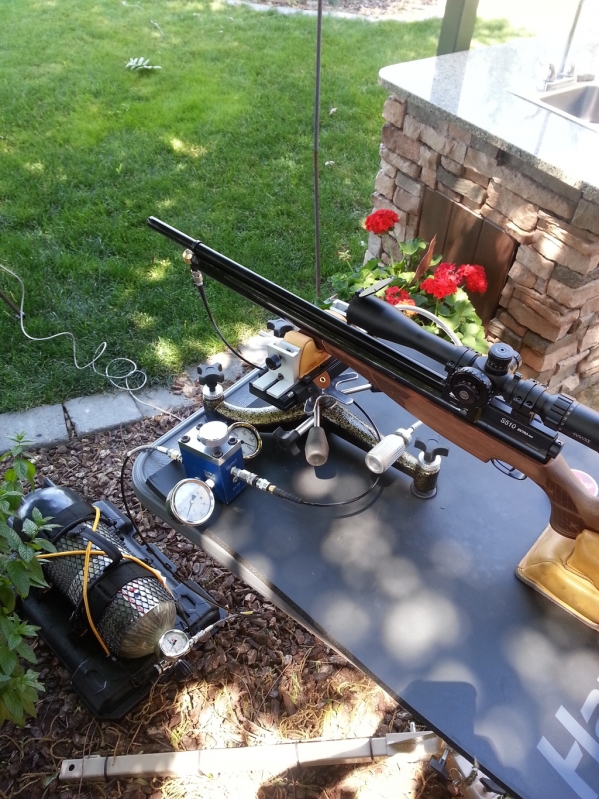

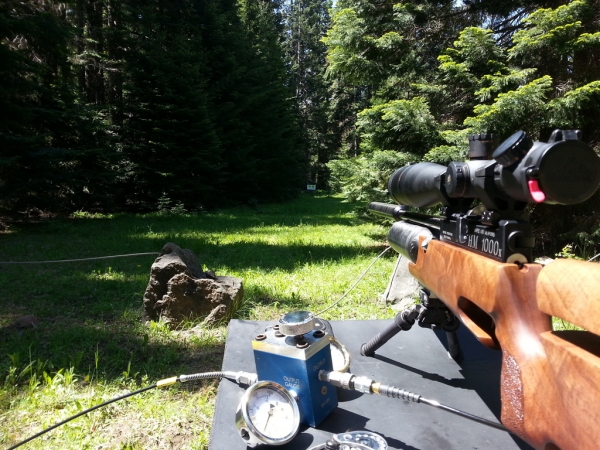

So to tether you need an external regulator. Also two hoses (one on each side of an external regulator). The regulator should at least be rated for higher than your supply bottle. Several types are available. I use the fully adjustable Ninja High pressure Fill Station. It is a set and forget it unit.
If you watch ebay they come up once in a while for a good price. I bought two of them for about a $100 a piece. Whenever I shoot target I use it to take out any shot curve that can happen with different pressures.

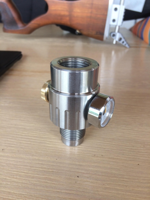

I just happen to have an external reg I bought from Joe Brancato back when I had a 6000 psi tank as my air supply. It isn't as pretty as the Ninja but it works the same. Just dial in the desired output pressure and you are good to go.
