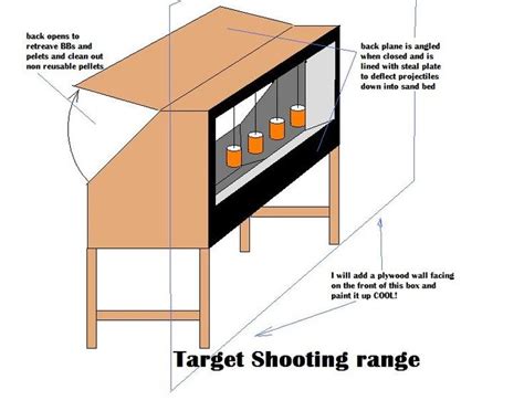

I forgot this one i made like tcarlson77 i stuff it with old folded clothes in the bucket part ..
Also another illustration i had

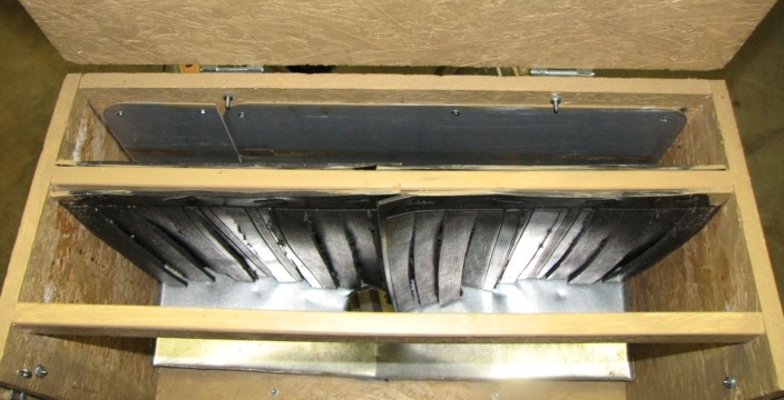

In one of my older target boxes, I used mud flaps cut on a band saw, with an air gap to aluminum plate (old sign of some sort). The flaps not only dramatically slowed down the pellets, they lasted about forever. It's important to cut them, so they dissipate the impact energy by moving slightly. I think a solid mud flap might actually cause a ricochet. I got this idea from the old yellow forum. I would have kept using this box, but even with a few coats of paint, the OSB board swelled and fell apart after a winter.
