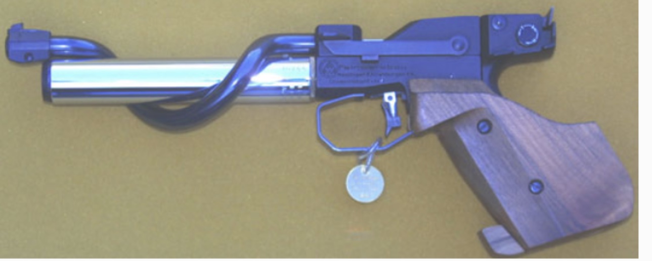

But on the extreme non-straight end, as bucketboy's example illustrates, the fouling a helical barrel would endure must be impressive.
