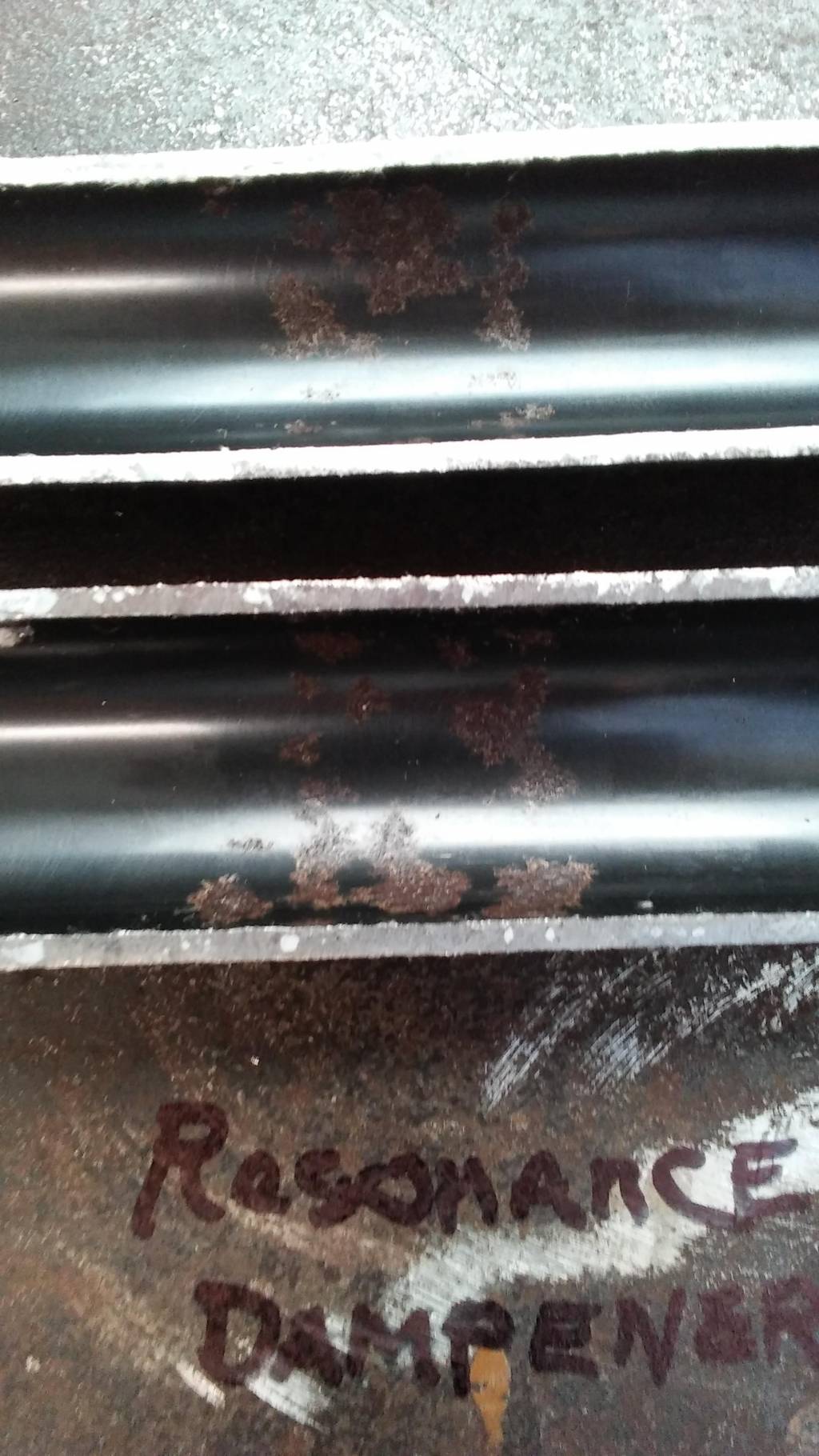

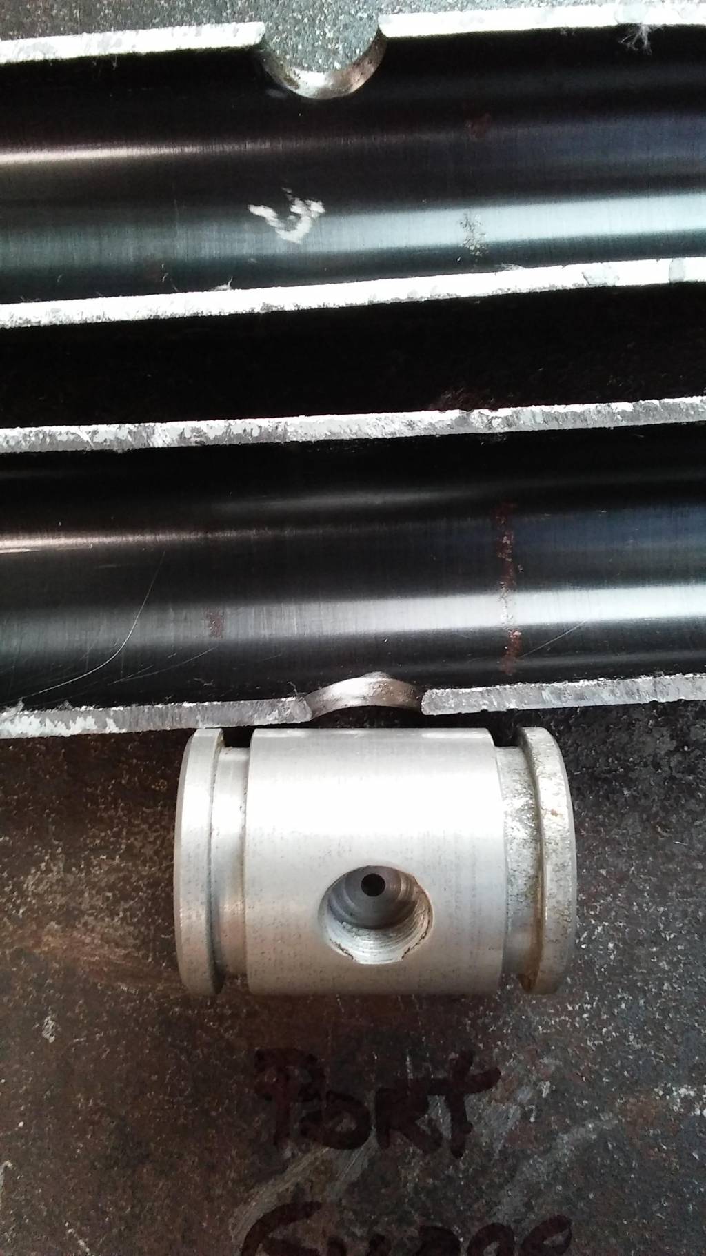

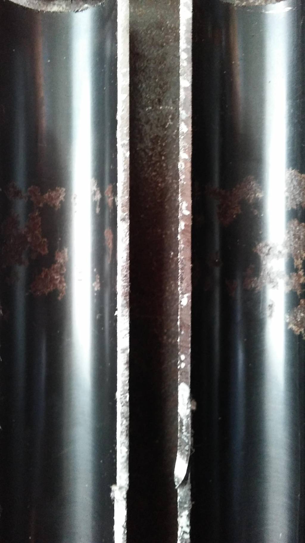

These pics were posted in another thread a while back by member kayaker... Water inside your pcp isn't a problem, till it is. Notice the corrosion on the aluminum part in pics, right in the o-ring groove.
It can damage you air tube , how long I do not know but If you suspect it I would degas & check it .Here's what I found in a m-rod tube (bought at a garage sale)
