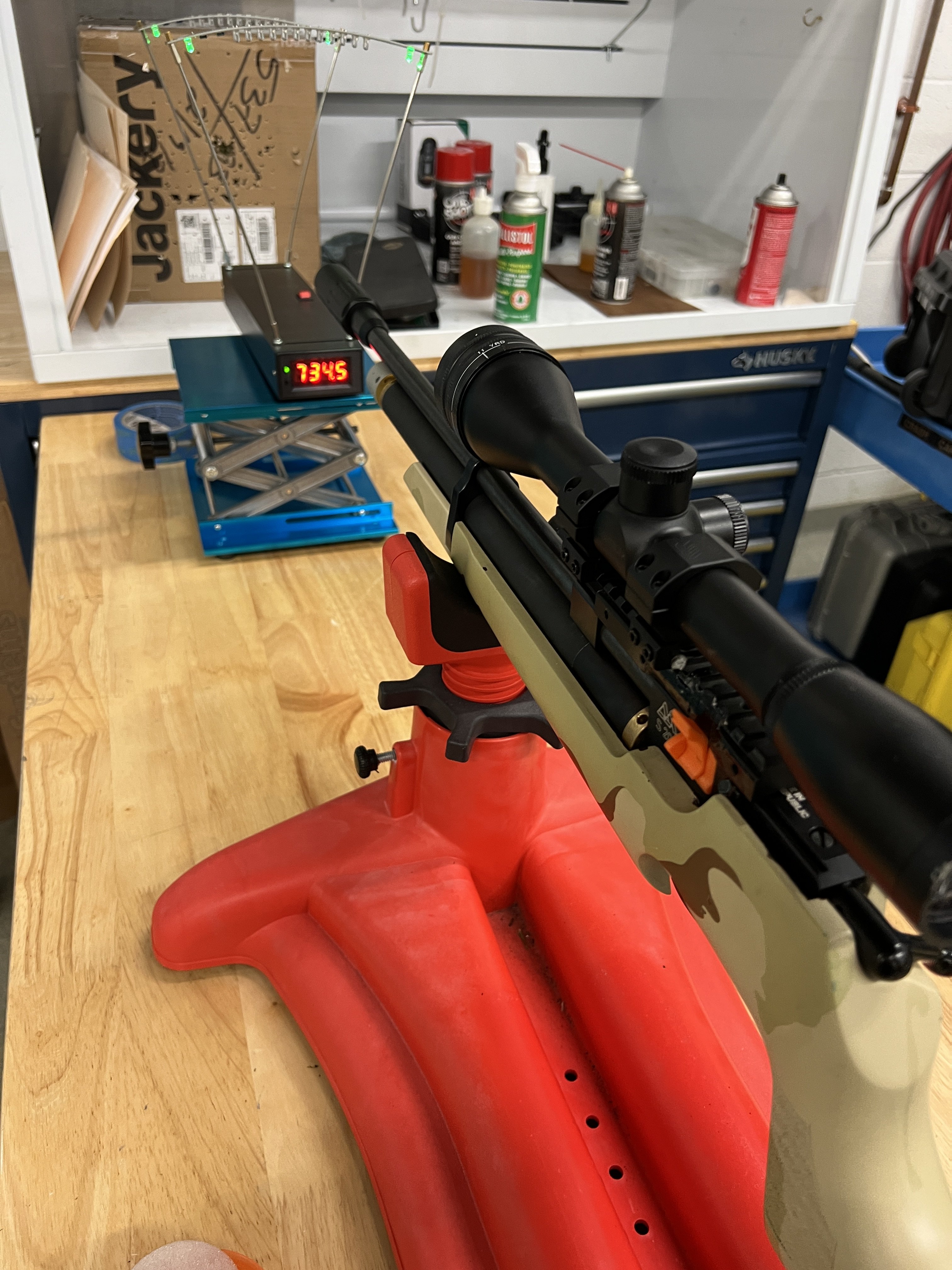

I did a comparison since I have access to a labradar, currently I have the new one on order for work, and they are consistently accurate enough for my needs. I plan on updating that thread when the new labradar arrives.
I currently have 4 different chinese models to compare.
Like Jim, I use mine for tuning. The exact FPS is not important to me. I’m never looking for a specific number, just a sweet spot.
This model is currently my favorite, although it is not the most durable feeling instrument.
