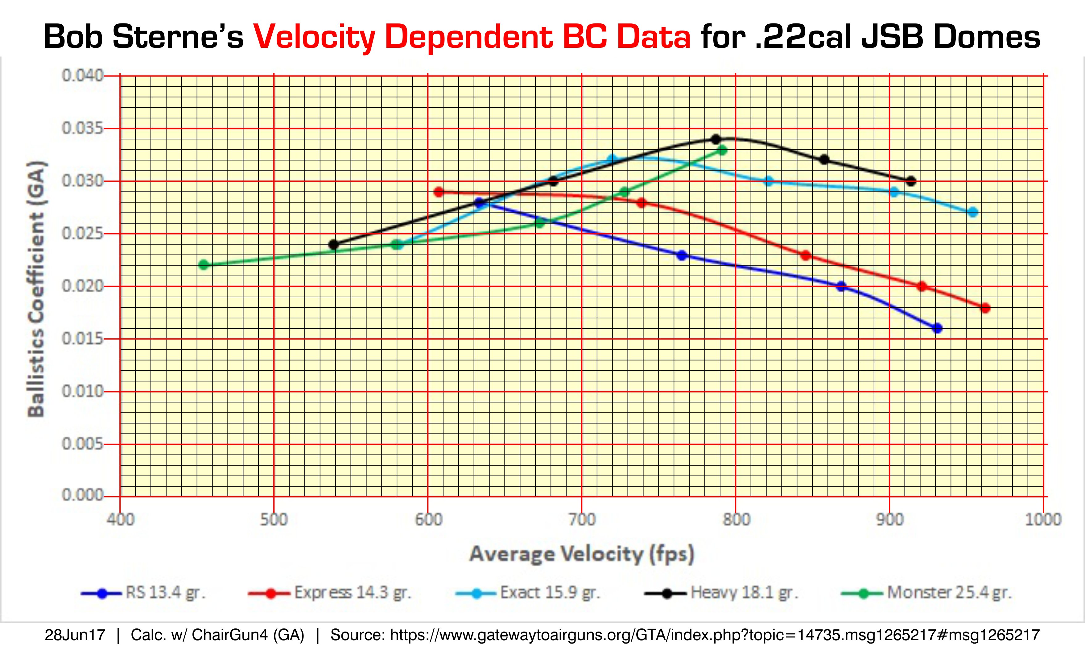

I use it and it’s as accurate as any other ballistic app available. The key to accuracy using it is, you have to enter the data points with some accuracy. Particularly the BC. The app uses a default BC but you need to enter the one for your particular gun and ammo and this requires a chrony and a reasonable distance to shoot.

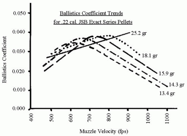

Know the BC of your ammo is determined by your gun and how fast it’s shooting. BC is not a constant value and it varies.
If you use a BC you “found on the web” or a default value, it may not be correct for your gun/ammo thus, the accuracy of the app will be in default.
Chairgun will calculate the BC for you (there is a tab in the app under toolbox / calculation items where you enter the speed of your ammo at the two distances (30 yards apart will work, 50 is better if shooting long distances) and voila! You have an accurate and useful BC. Now also know, any time you change ammo or speed you have to repeat the same steps.
As for the energy part of your question, the default info, providing you are entering a close approximation of the speed, will be accurate enough for FPE.

Ok, so when an ammo has the BC printed on its label, like FX slugs have, is that the given value I should enter in the BC section of the chart?
You might try it and see. Input their stated BC in Chairgun. Making sure your zero is good. use two aim points; one near and the other far as far apart as possible (say, 15 and 50 yards).
Using the aim points as Chairgun suggest (clicks, mildots whatever you prefer) and fire at them. If the impacts are precisely what you used then the BC would be practical to use. If not then you will need to do your own BC testing.
Here’s an interesting read on BC testing from Hardair Magazine.
Reactions: Leon83
always validate your bc.
it may change with velocity so it is recommended to validate you pellet trajectory.
