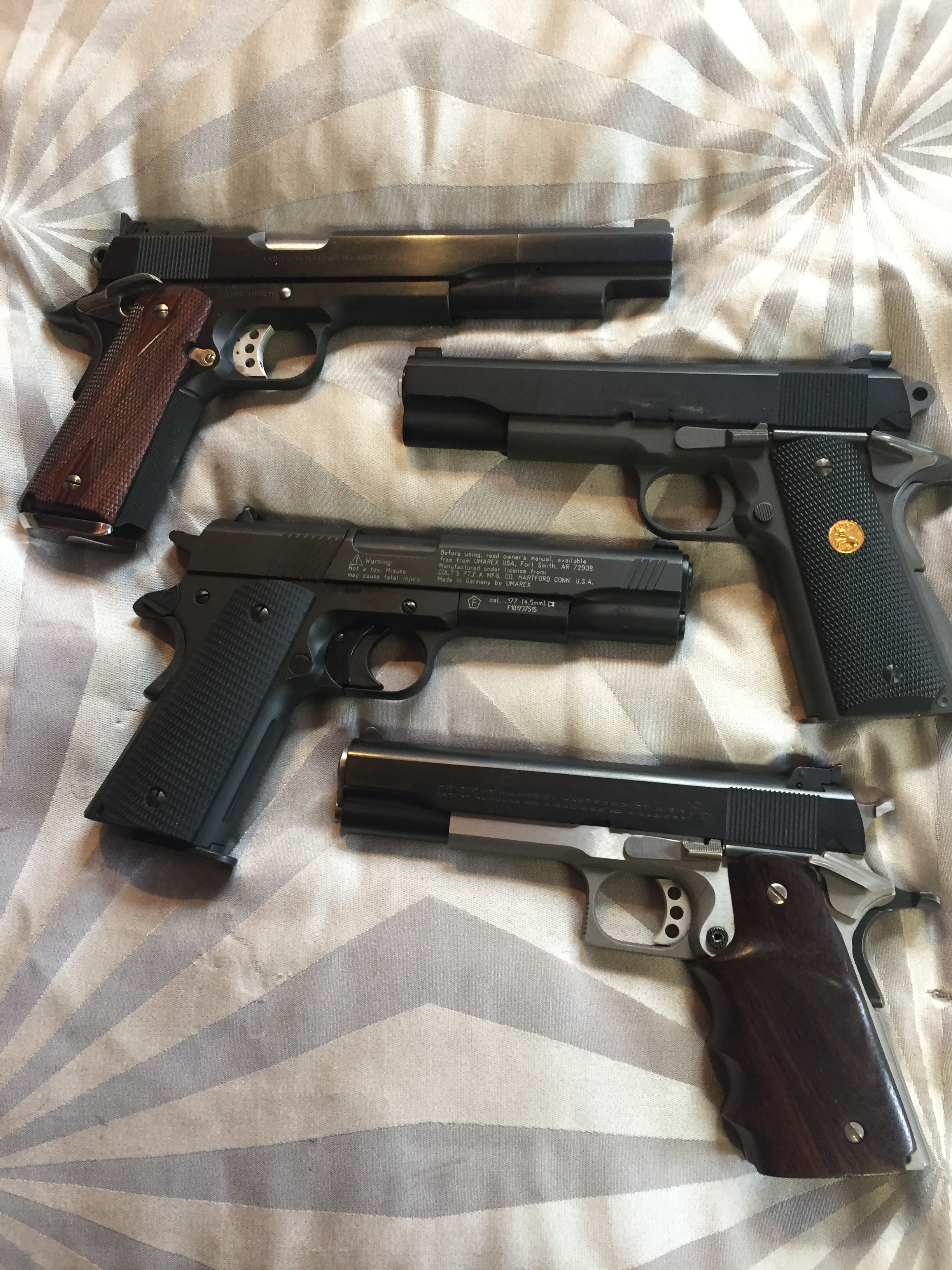

Here are some of mine,I think the green gas ones are the most realistic,in function and looks.
Co2 pellet,I love mine, Colt. As MikeVV says there are some good choices for CO2 .Colt looking .45 bb pistols.
Sig Saur and Colt Umarex are others.

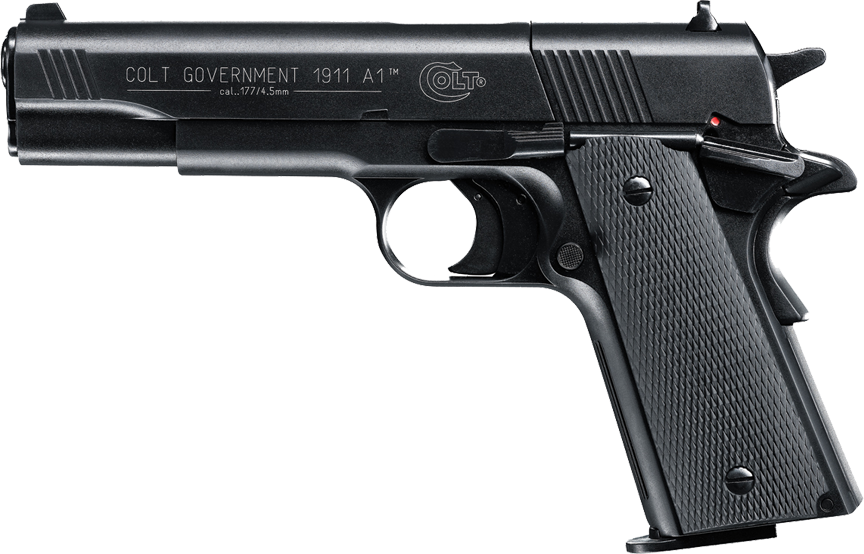

Despite the sorta ugly (double-single action) trigger, I bought the Umarex version that has a round magazine, inserted just above the trigger.
Why this one, purely because of that it shoots pellets (.177), instead of BB's. Rifled barrel and all. I have a similar Walther / Umarex that's pretty accurate, much more so than BB's, and this one's got a longer barrel.

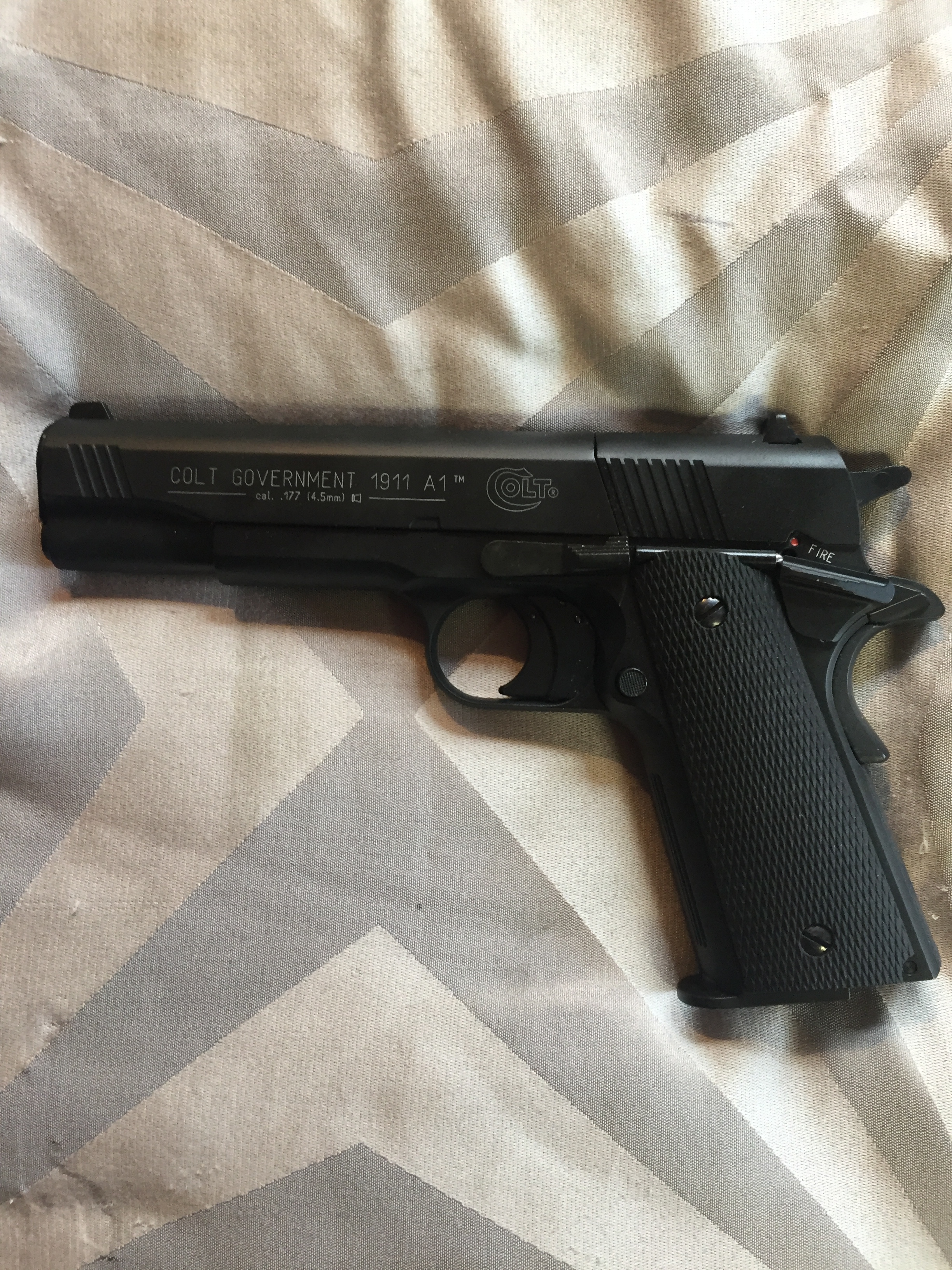

Not aa BB gun. Designed to shoot pellets only, in a round, aluminum magazine. Plus even if you could, I wouldn't want to mess up the rifled barrel, shooting BB's.
Plus the "slide", just sits there..! The only time that the slide moves is when you load the magazine into the breach, and even then, only the front half moves..!
You must be thinking about a different gun. The back half does move, but it's to cock (how do I say loading a pellet???) the gun for single shot, shooting.
Now I need to figure out a way to install some sort of sighting system, other than the iron sights. I have...somewhere, a Picatinny rail as part of the right side grip panel. Hopefully the rear sight moves / is removable. This way I can remove it and install an adapter plate in the rear sight dovetail. This would be better than the grip plate sight mount.
