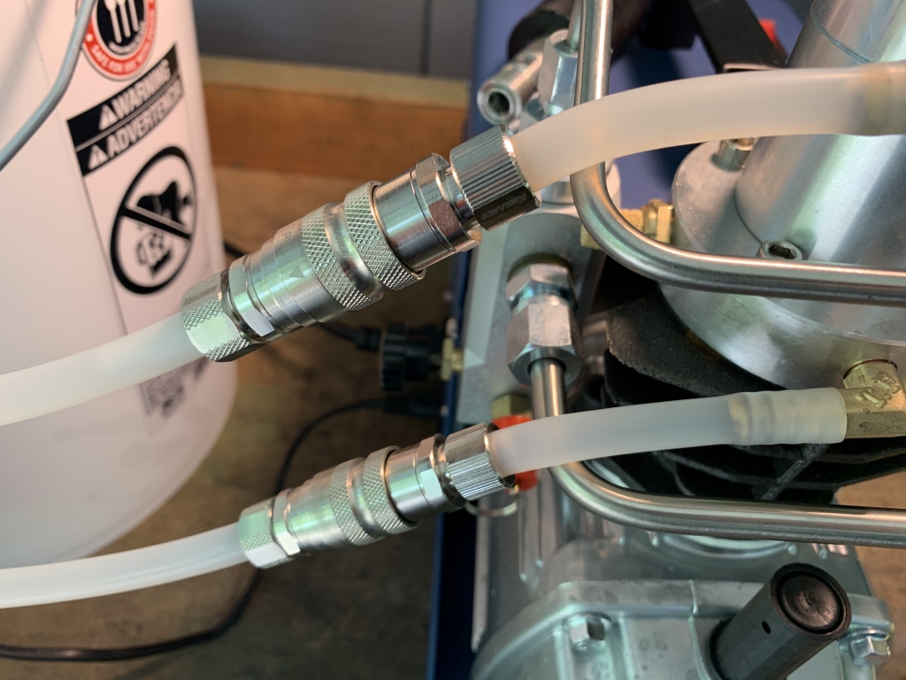

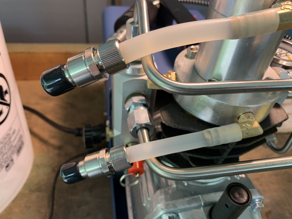

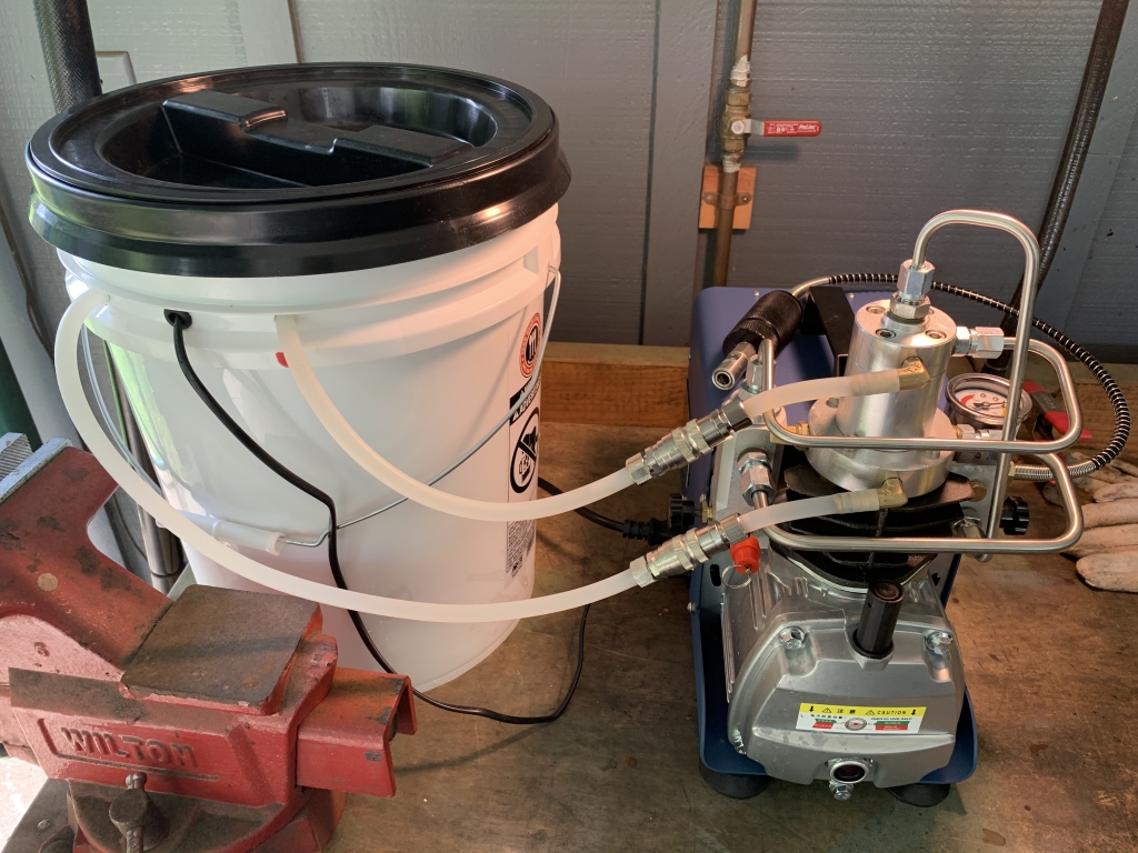

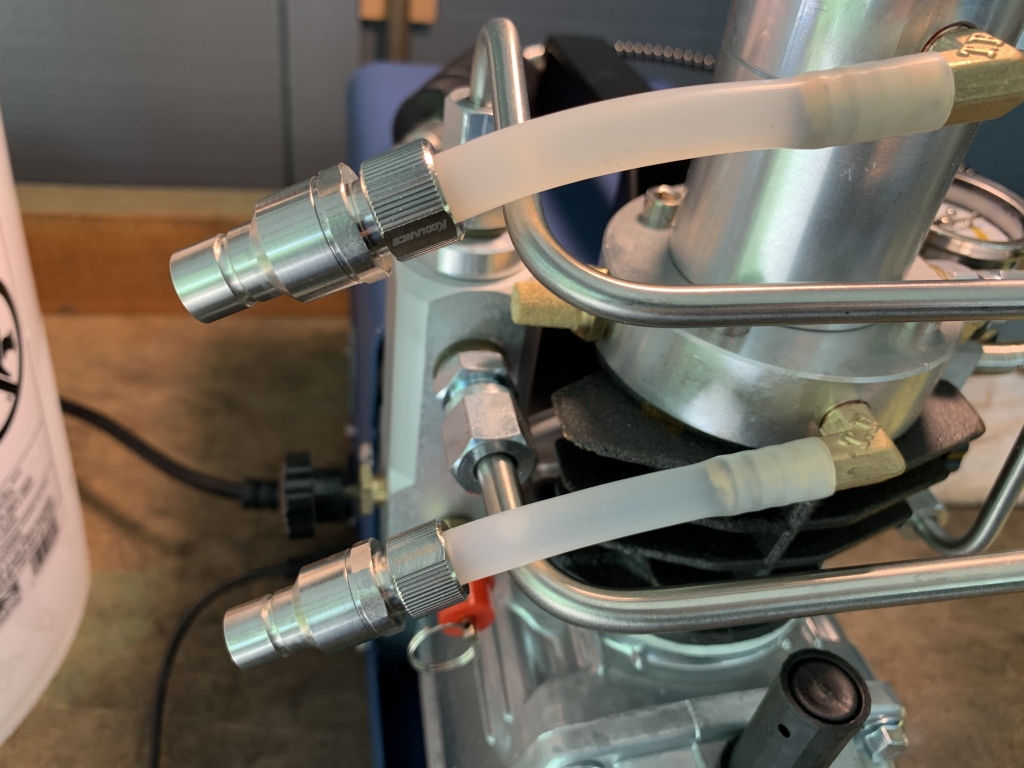

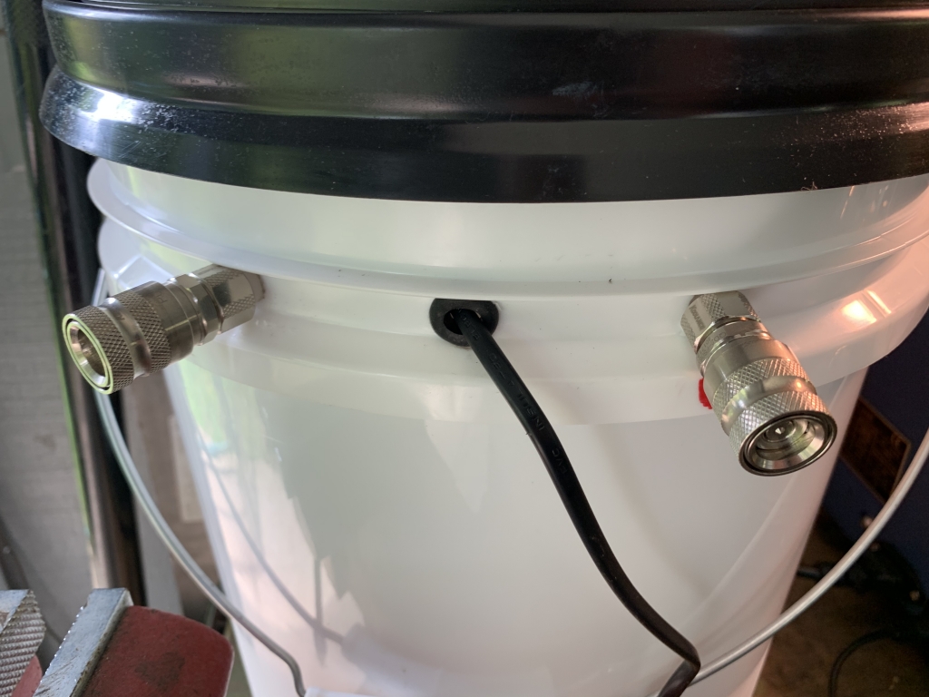

Thanks guys. I'll be using threaded and barbed males on the compressor side and barbed females on the bucket side. I think the silicon hoses should work on the barbs.
Ok guys quick update. Found the right fittings and it’s tits! Bucket stays outside in the carport while the compressor gets locked in the storeroom for safekeeping.
little pricey but worth it to me for a no mess quick disconnect.
Koolance QD2 Quick Disconnect No-Spill Coupling, Female Compression for 06mm x 10mm (1/4in x 3/8in) (QD2-FS06X10)
Koolance QD2 Quick Disconnect No-Spill Coupling, Male Compression for 06mm x 10mm (1/4in x 3/8in) (QD2-M06X10)
