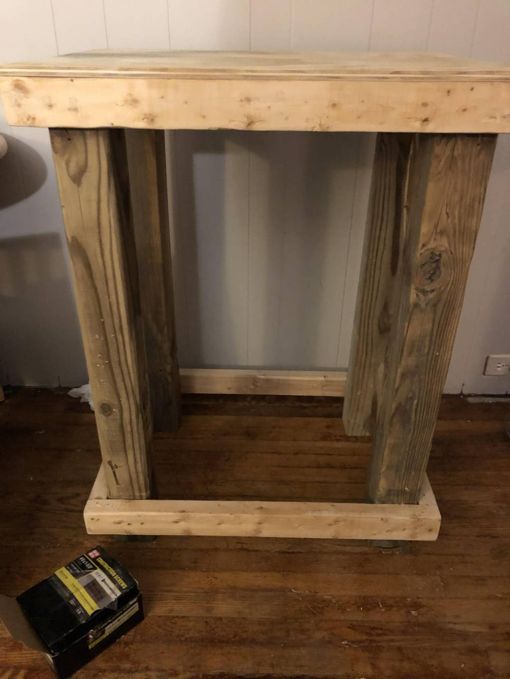

I started with an old table I put together crudely with some scrap ...

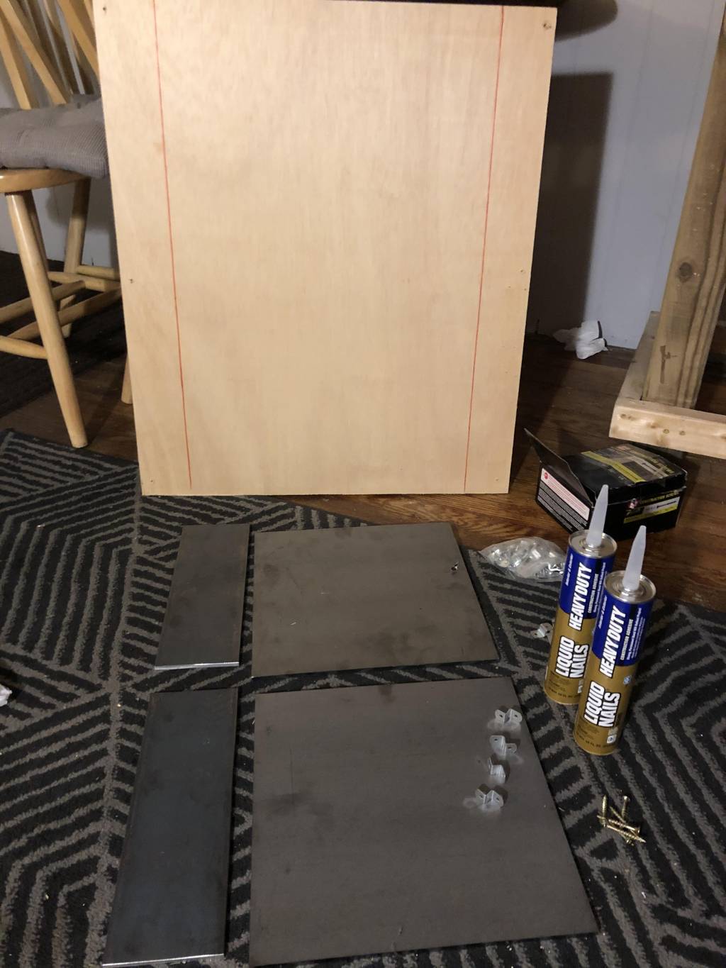

I decided to go cheap and get 1/4 steel panels in smaller sizes...there's a decent price jump above a certain size

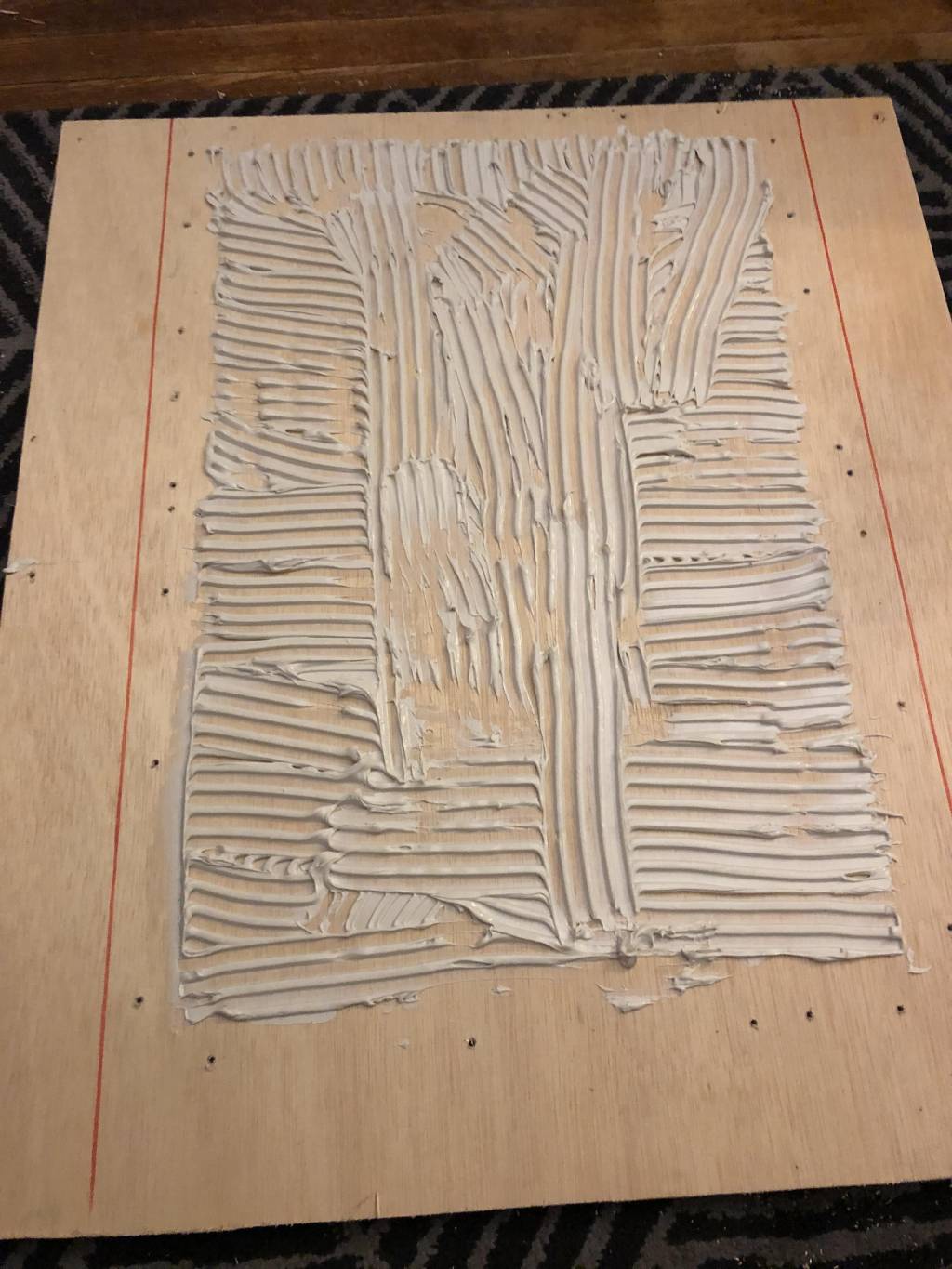

Spread adhesive on 3/4 ply, use a jawn to get it nice and even....

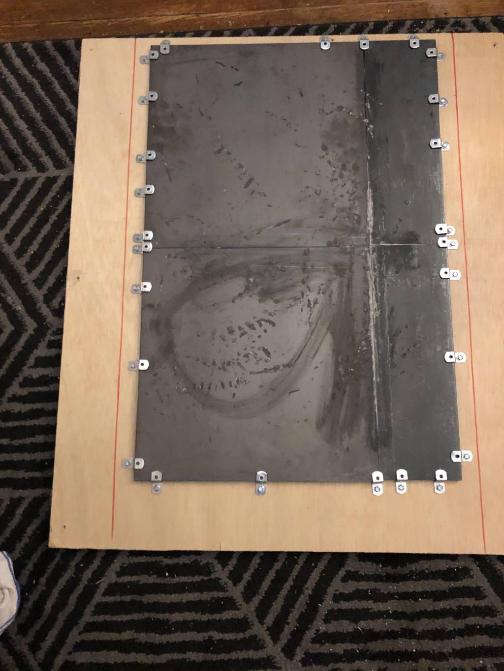

Clean steel plates with rubbing alcohol and set in place like tile, I used some picture frame clips I had handy as well...

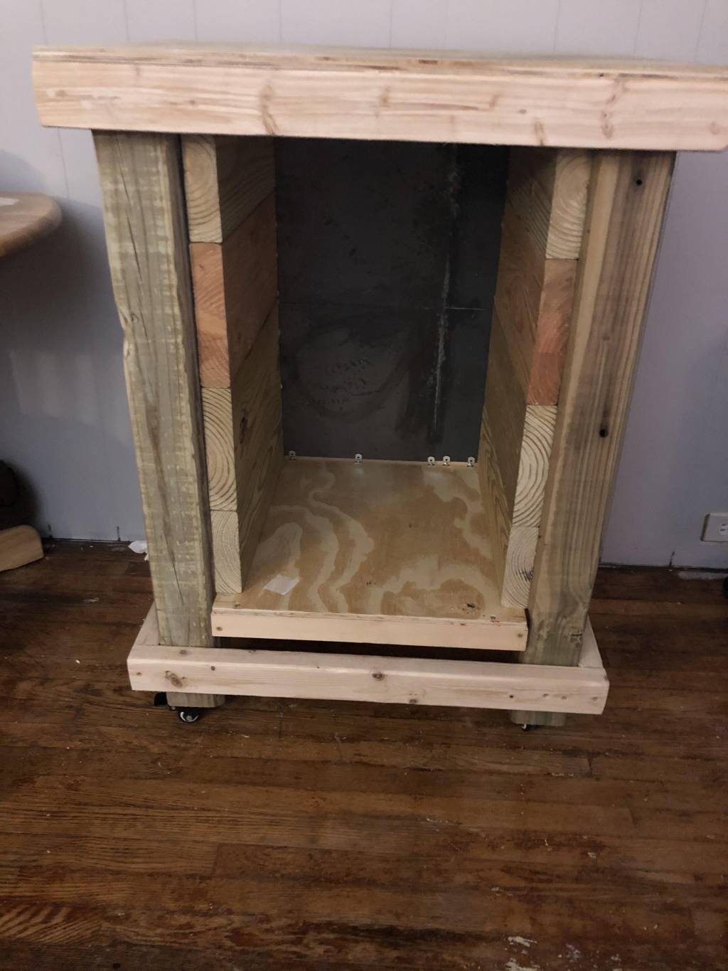

Let it dry overnight, screw into table and add side blocks, also add wheels this bugger is heavy....

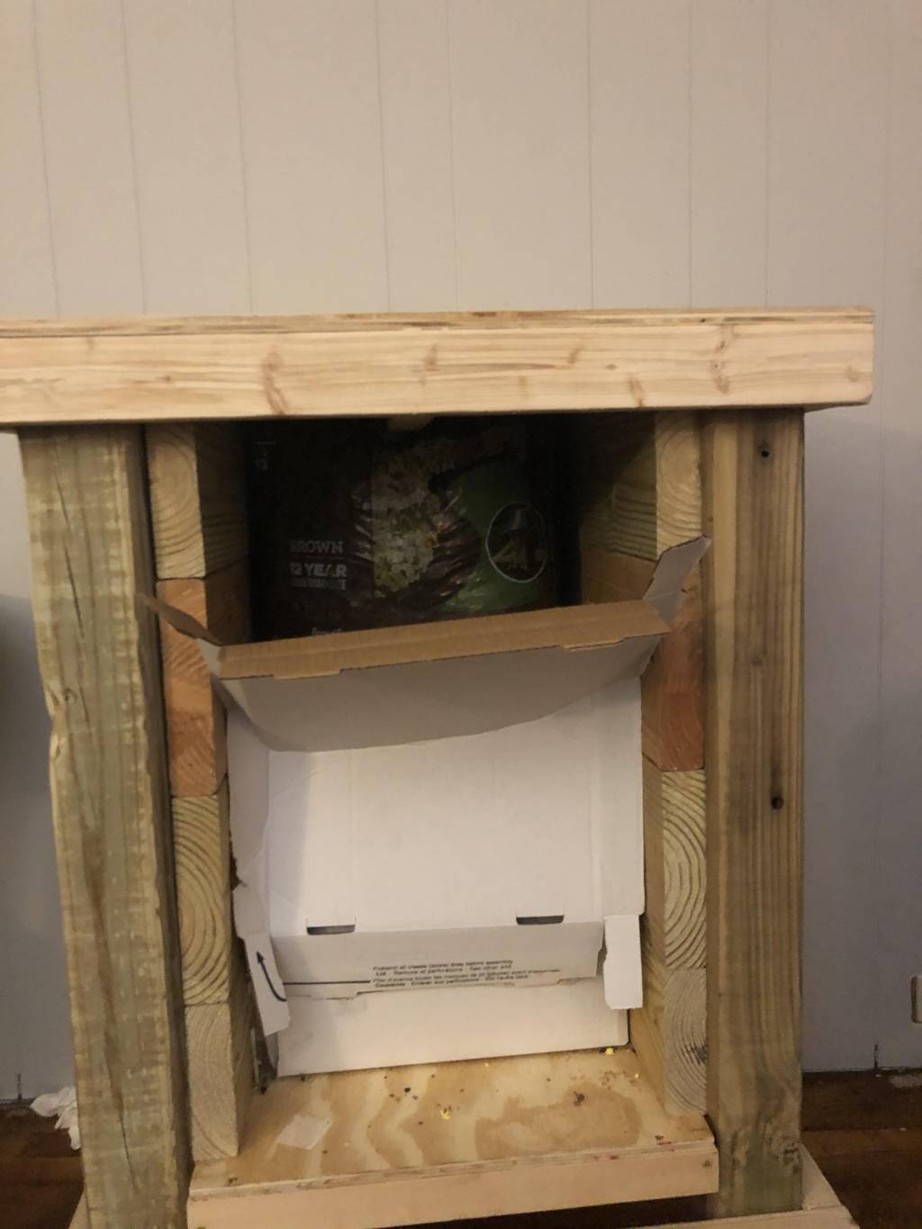

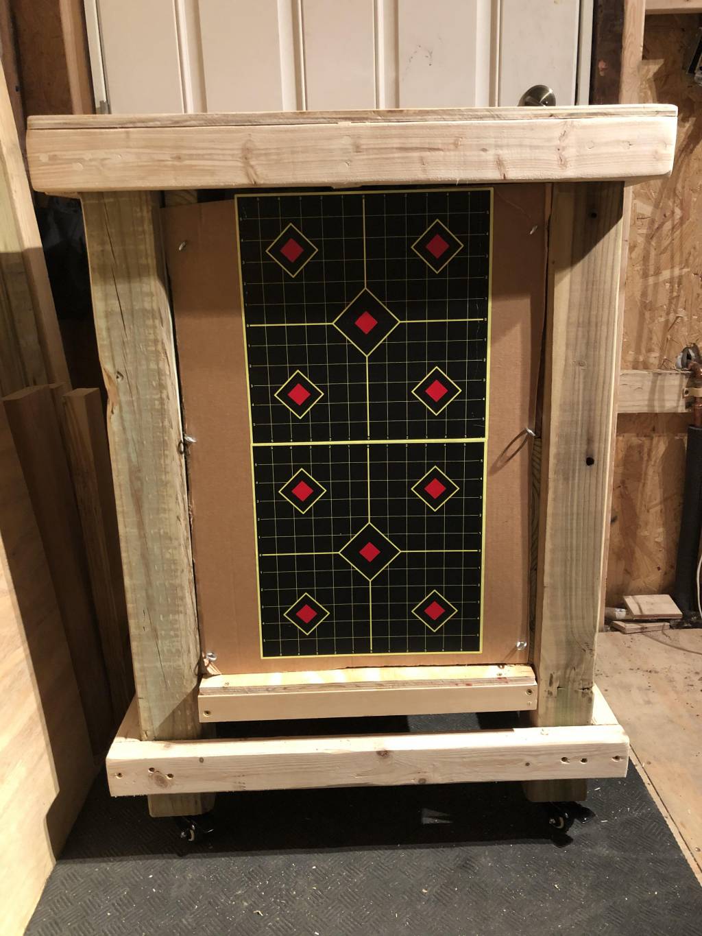

Fill with rubber mulch tightly packed into cardboard....
Add your favorite target ....
Even shooting at 10m can be fun and rewarding...
And remember to be careful....
So far the pellets are getting trapped in the rubber mulch and there is no sound. There is 16 inches of packed rubber mulch in front of that steel. If there is sound, I'll know the mulch isn't settling into the pellet holes- but I know from past experience with rubber mulch that it settles and fill gaps as you shoot. Just give it a good shake from time to time. **BUT I'm not shooting anything over 50 ft lbs so this is all from experience with lower power rifles**
If there were no rubber it would hit with a dull thud, no twag- there's no vibration. The steel is totally bonded to the wood which is secured with 8 screws to the wood frame which has about 80 pounds of material attached to it.
