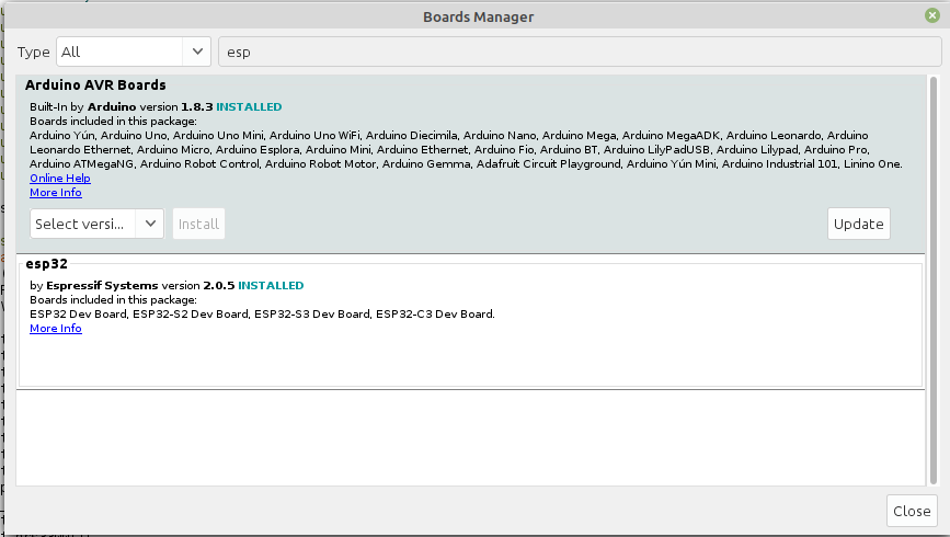

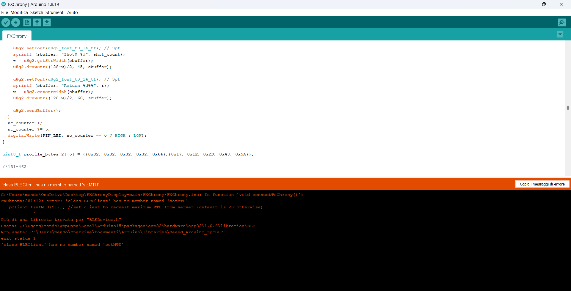

Try Arduino IDE 2.0.3. I think there was an update to the ESP32 files that only works in version 2.0 or higher. And the latest version of the ESP32 board as well from Expressif
setMTU() was introduced in version 2.0.5 of ESP32 board support. Go to Tools | Board Manager, find the "esp32" package and make sure its v2.0.5. If not there's a drop down list of available versionsSorry guys I'm not very practical where I go wrong Thanks

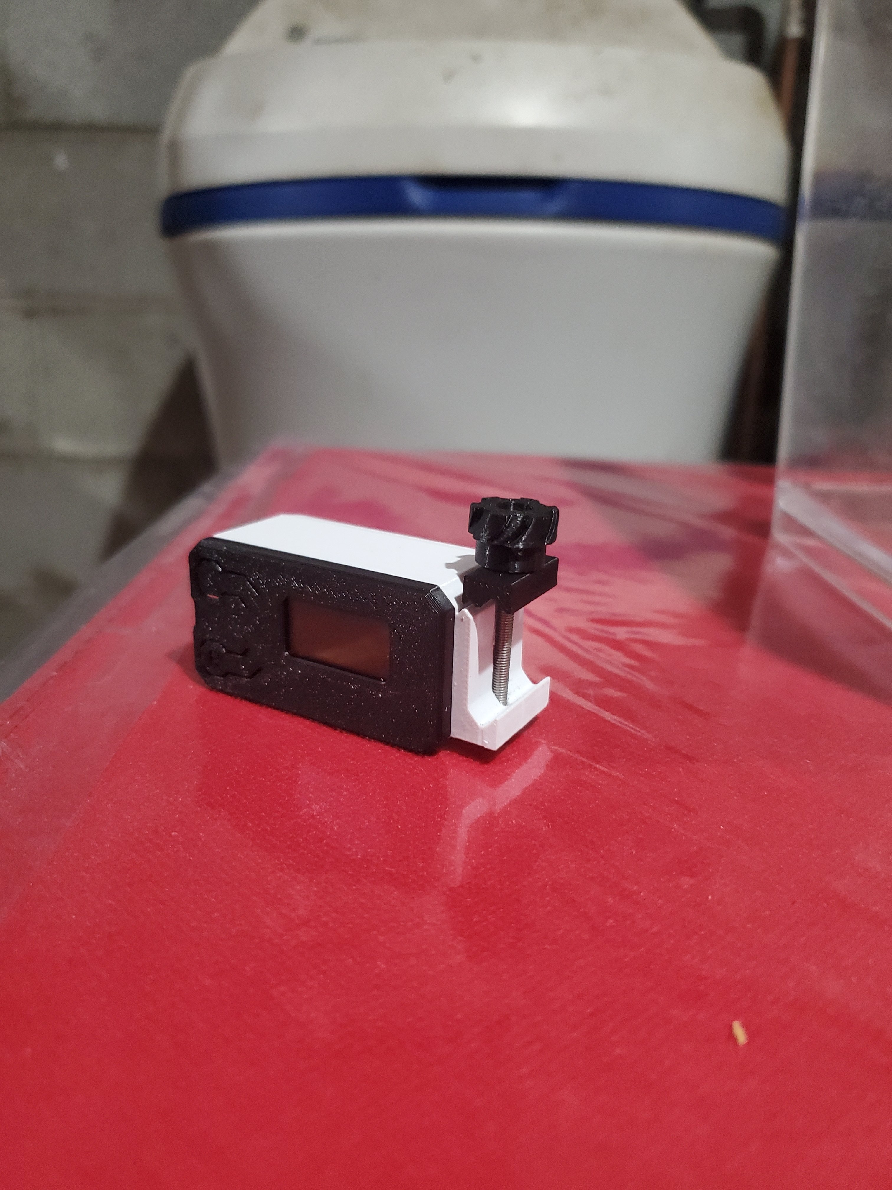

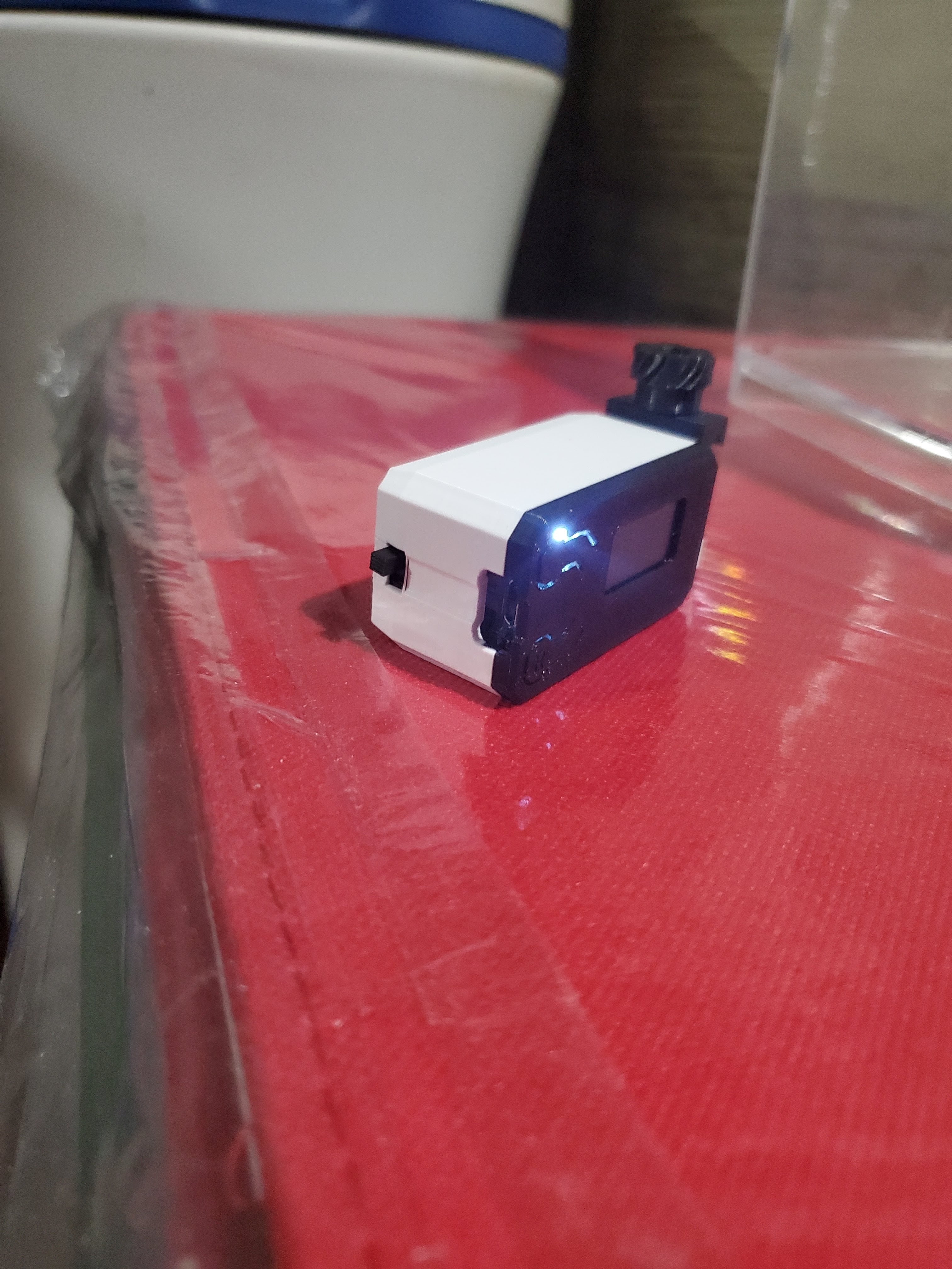

That looks really great and functional! I think it's time for me to invest in and learn 3D printing!I remixed a box to pic rai for the esp32 board to fit a little switch and a 1000mah battery

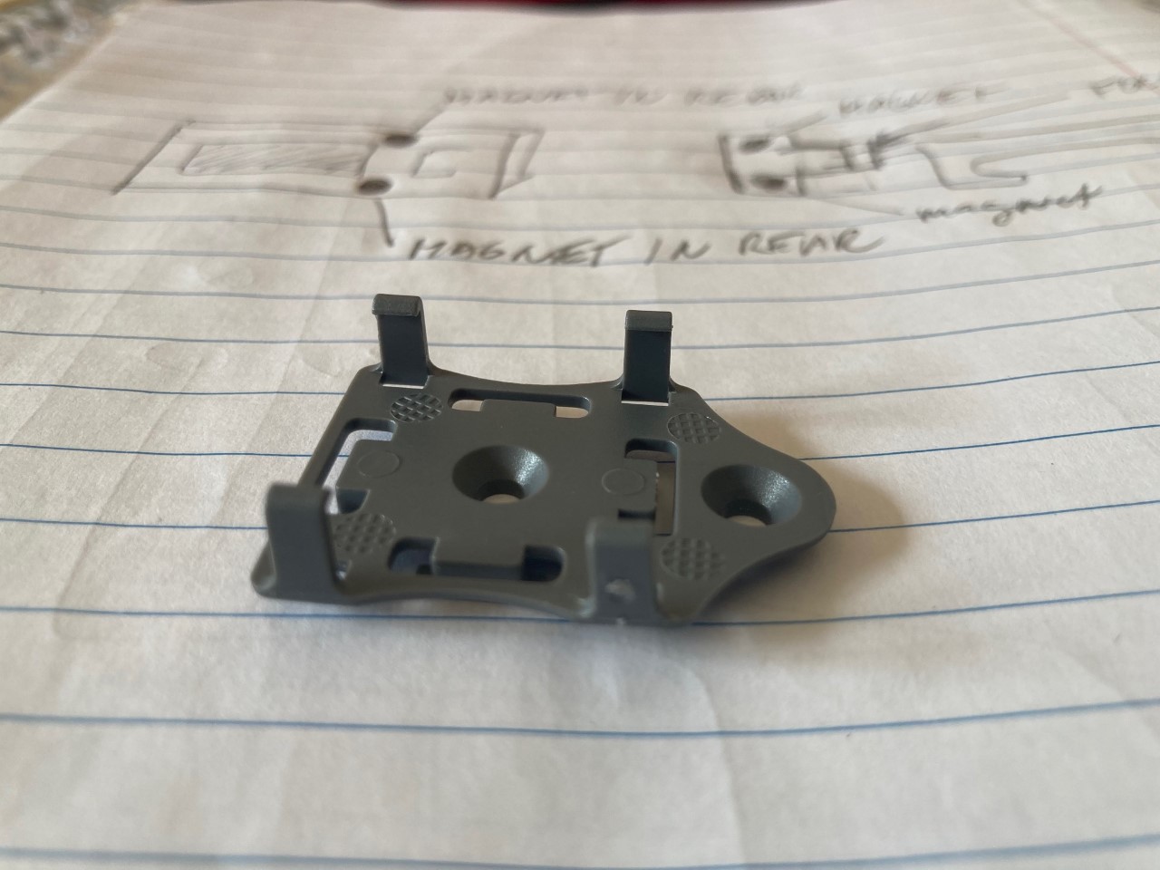

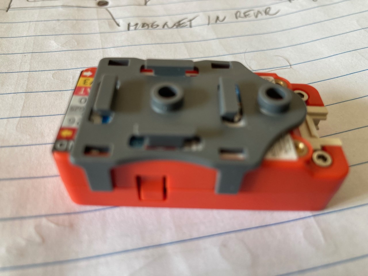

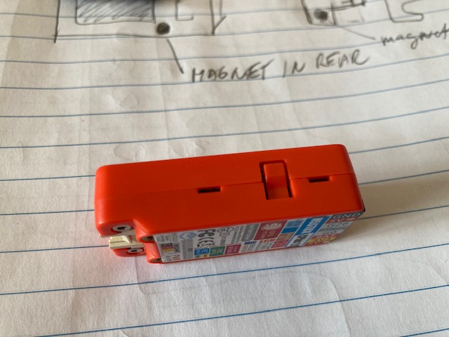

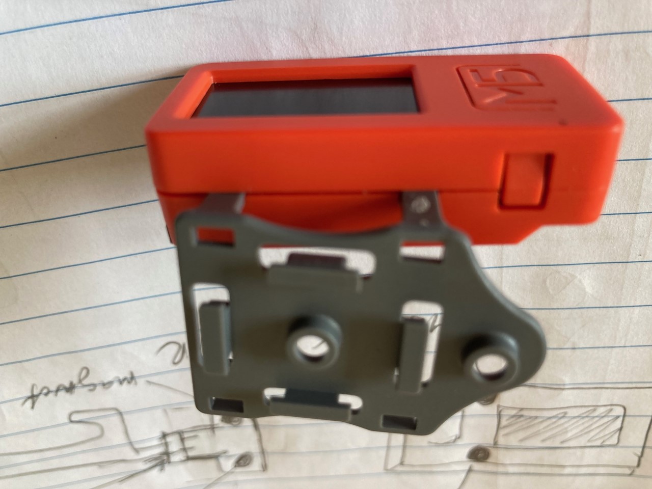

Too easy. Once I get mine, I will finish the design and send you a couple.Yes, it can be as simple as this, with only one folding joint, a short arm of about 1 inch with two magnets spaced to mate up with the tw magnets in the rear case of the M5Stick Plus. The two magnets are located about where I placed that magnetic thumb tack.

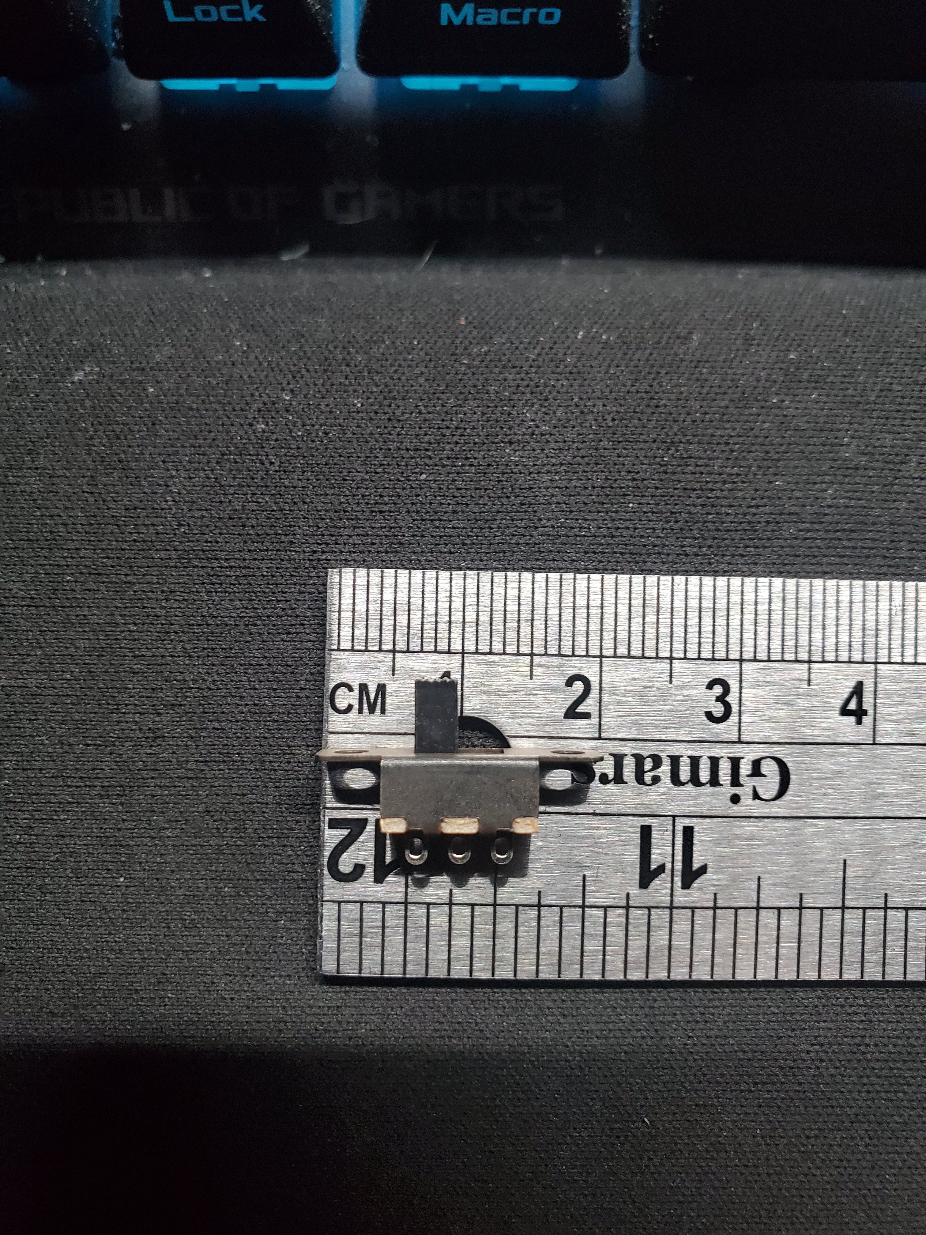

I like that little switch. Where did you find it? Hard to tell online how small the ones on Amazon are.I remixed a box to pic rail for the esp32 board to fit a little switch and a 1000mah battery
https://www.amazon.com/dp/B099N3HFPG?psc=1&ref=ppx_yo2ov_dt_b_product_detailsI like that little switch. Where did you find it? Hard to tell online how small the ones on Amazon are.
That's a lifetimes supply for $8 - awesome!https://www.amazon.com/dp/B099N3HFPG?psc=1&ref=ppx_yo2ov_dt_b_product_details
I've had the sw for ever, These are the same ones I just can't find like 1 or 5

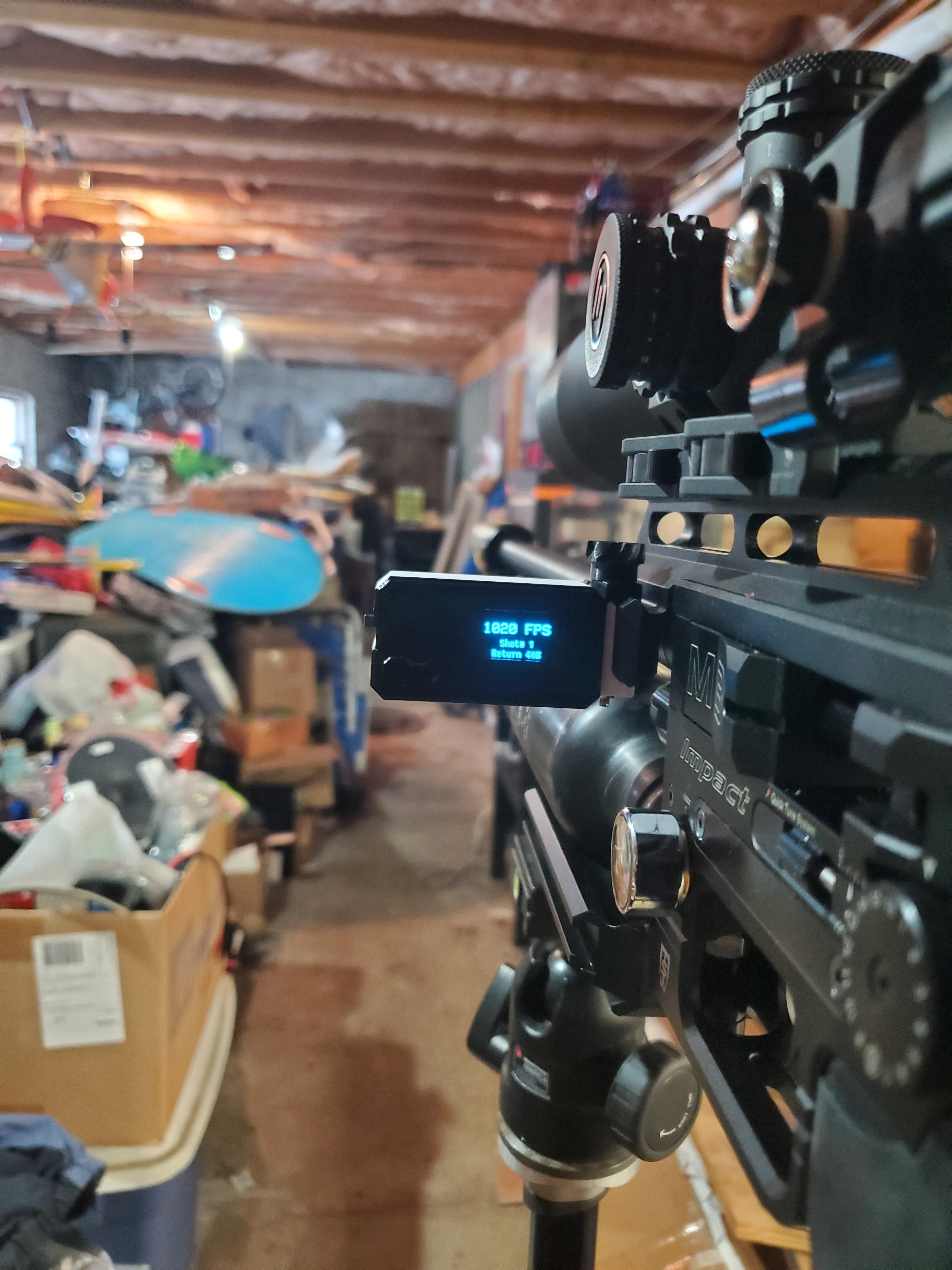

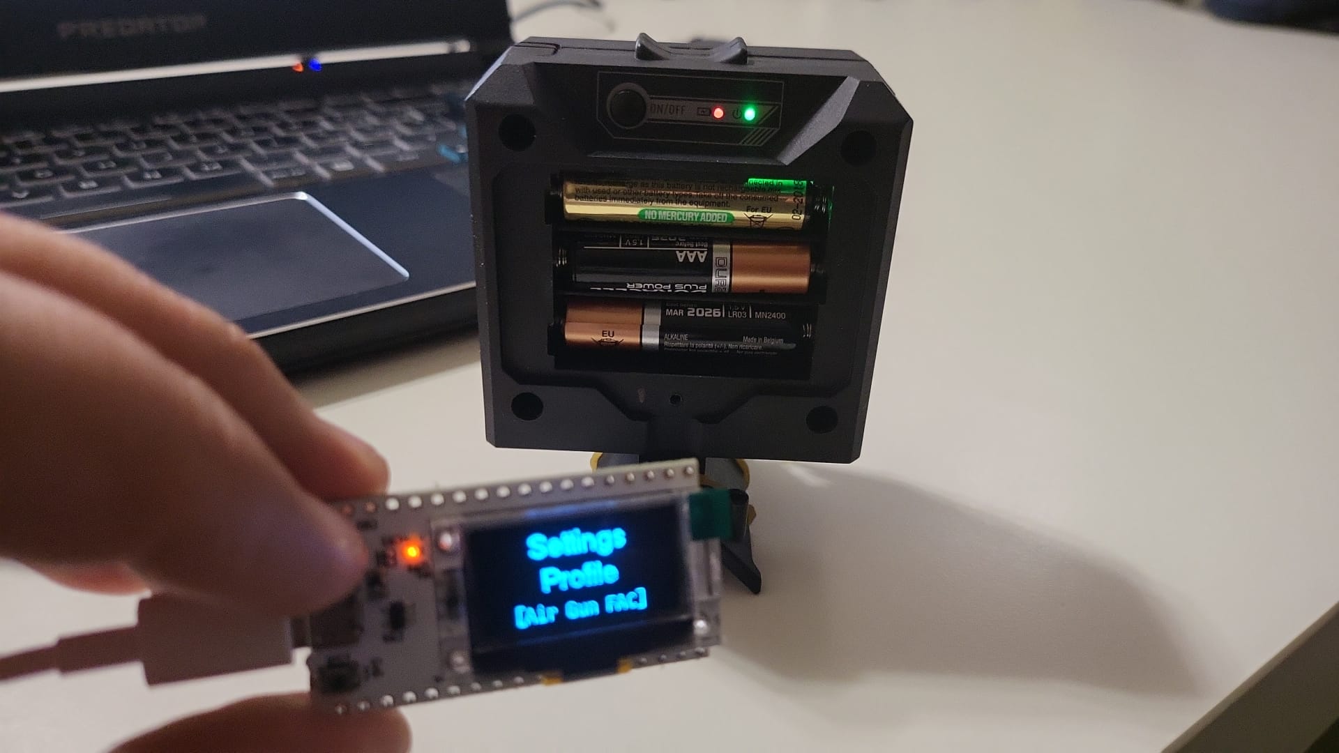

What's final? I will probably add recording shot strings and displaying the Chrony's battery voltage. As and when these get done you will be able to update the device yourselvesETA to a full and final version so we can trade?
2-3 hours? The 1000mAh I linked to is the same size as the PCBGuys how long does it last on with a 250mah battery

Picked up above set today. I must find some time to set up my MacBook. Mounting kits are made of solid plastic, the one in the middle seems the most robust. It should not be a problem to fabricate mounting kit for skilled 3D designer.
