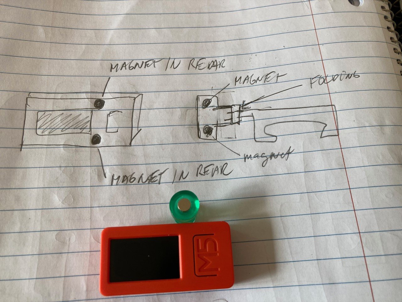

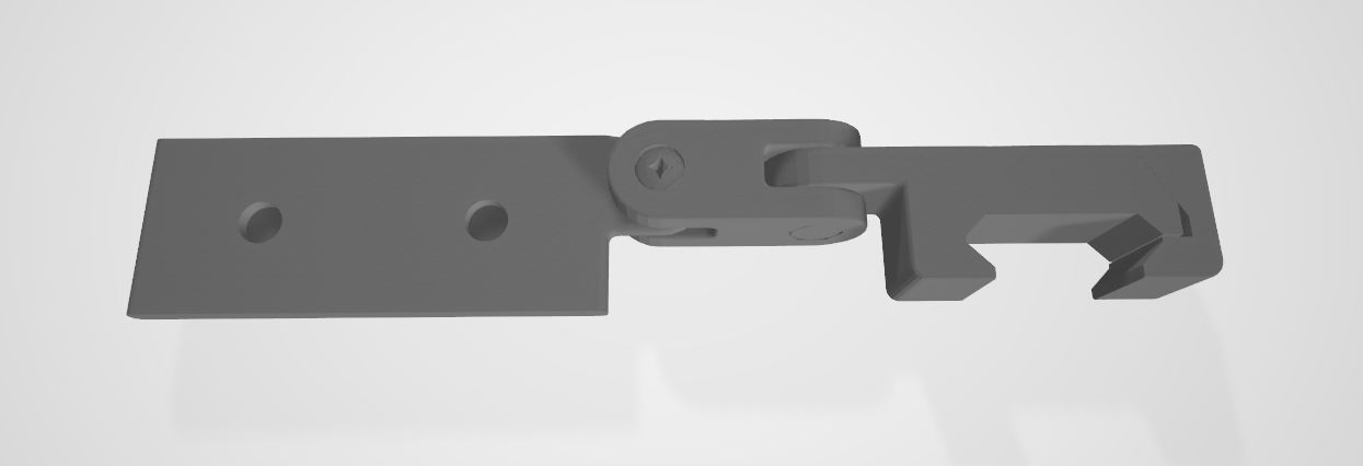

If anyone makes an enclosure, may want to consider some sort of a semi-permanent fold out mount with a couple of small neodymium magnets, because the M5Stick has two built-in magnets in the rear. So you can fold out the mount from the picatinny rail and snap the module on it. And when done, just snap it off and fold the mount back flush with the stock or under/near the scope rings.
If anyone makes an enclosure, may want to consider some sort of a semi-permanent fold out mount with a couple of small neodymium magnets, because the M5Stick has two built-in magnets the rear. So you can fold out the mount from the picatinny rail and snap the module on it. And when done, just snap it off and fold the mount back flush with the stock or under/near the scope rings.
I will definitely try to make something like that!!
Reactions: fe7565
Also, the M5Stick Plus has power input pins on the side. So, if the internal battery gets weak, you can charge/run it externally, may be with a rear mounted additional battery snapped on the back of it, or on its mount.

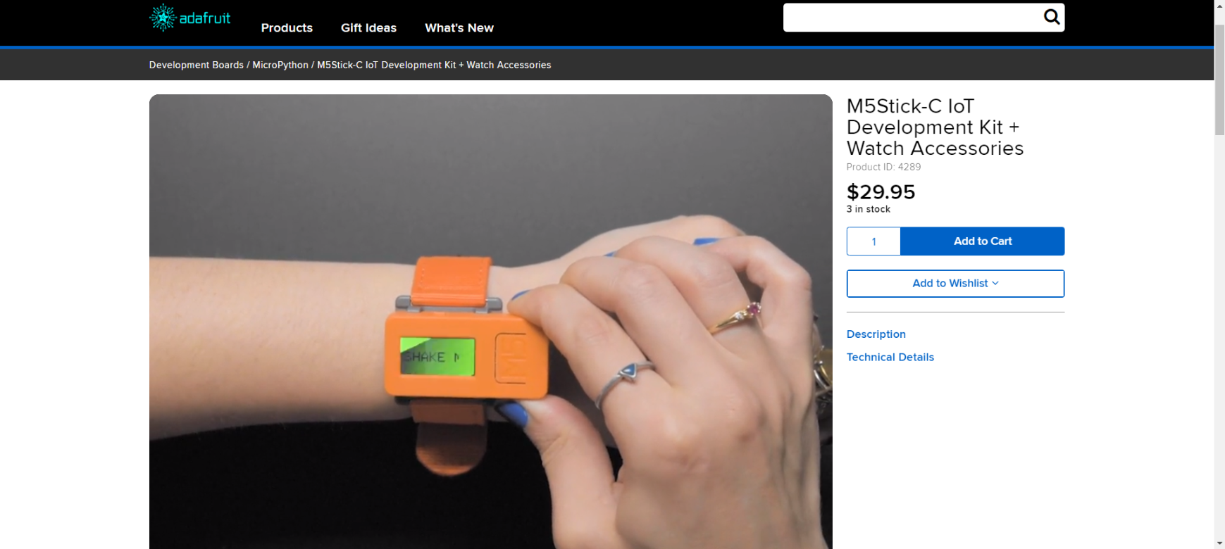

You can also buy a wrist band for it, designed specially for the module. I forgot that mine came with one. It's only $3 more with the wrist mount kit together, at DigiKey:
https://www.adafruit.com/product/42...jfi7-n9ouq1q3cBNyzEV7fw--hMDtHU8aAsN0EALw_wcB
