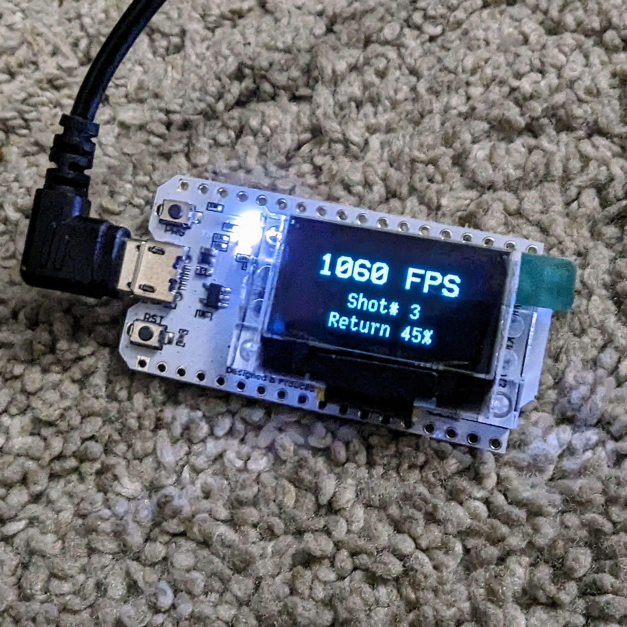

Thanks to DaystateRebel! Managed to port the code to an M5StickC Plus. Still need to add the menus and the other enhancements he did already, but works good. This module is $21 on Digi-Key, and has an LCD, battery, IMU, mic, RTC, PMU, LED, 2 buttons, mounting magnet backing, and a barely audible buzzer.
That's awesome! Willing to share code once finished?

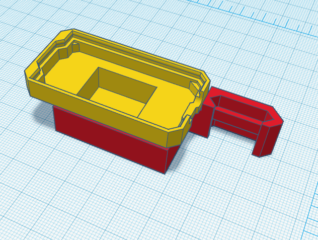

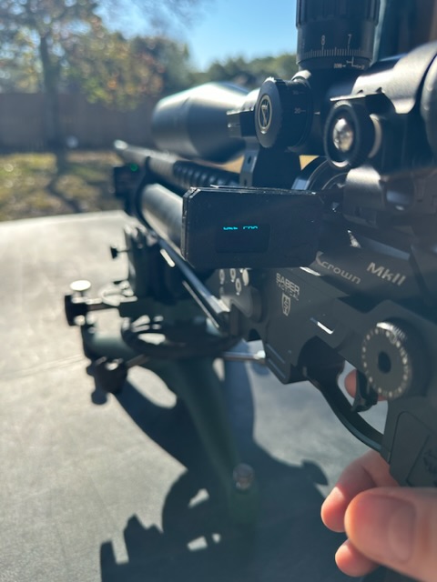

I remixed the rear back plate to hold the tinny 200mah battery I had from a toy drone. Should be an easy remix to size it to a bigger battery. I printed the snap on back plate in PLA+ and the picatinny mount in TPU. TPU gives some flex to press fit the chrony into and also snap it onto the picatinny scope rail. This is sized for my Crown. But I assume it would fit other platforms. It would also be an easy remix in thingiverse.
