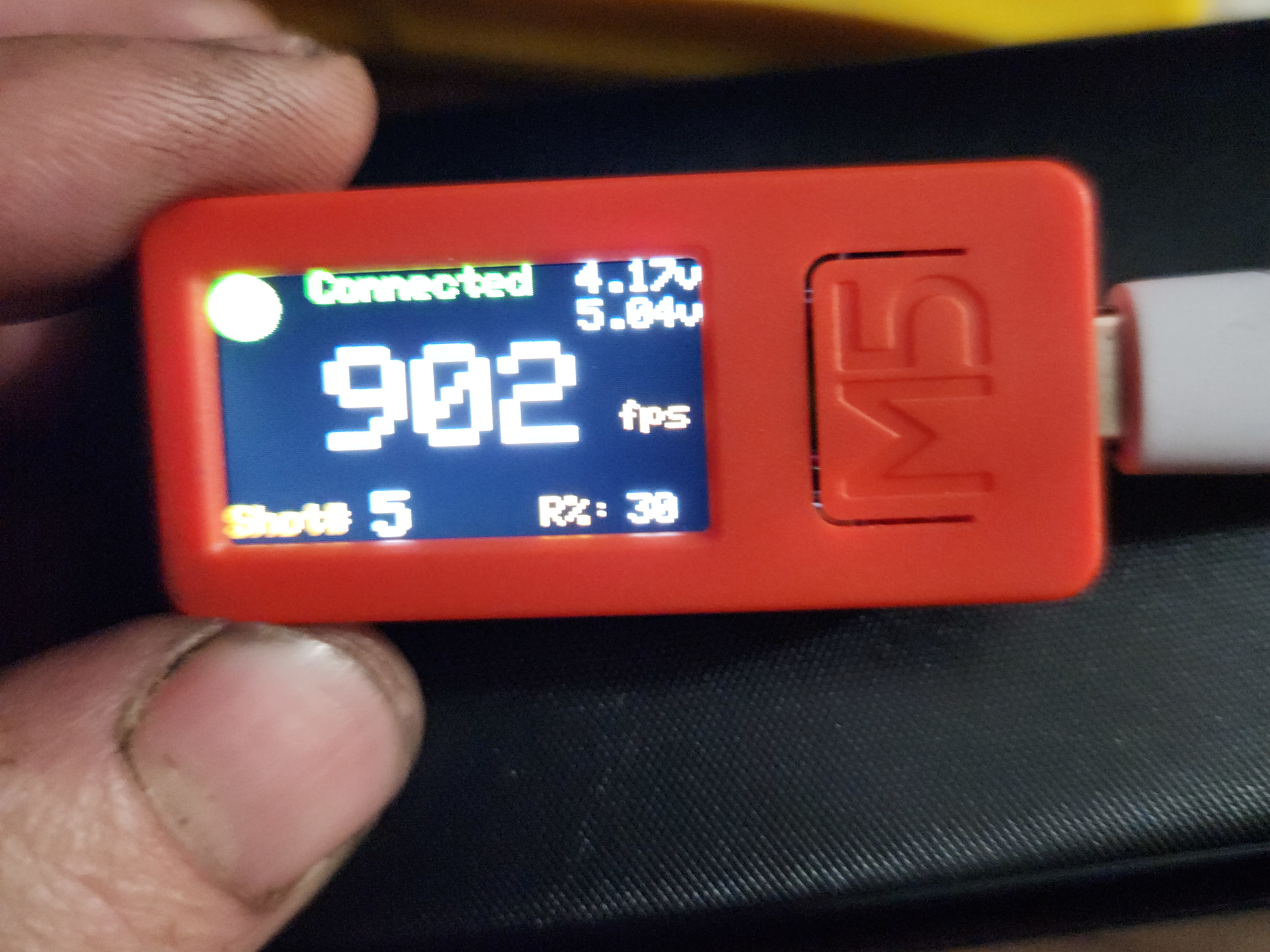

got my m5stickc plus. uploaded and have been able to connect to chrony using version 4 and 6. but neither is registering shots. if i hook through phone app the chrony is seeing the shots taken. i compiled and uploaded to stick using m5stick-c in Arduino. I see no board choice for plus.
update.::
got it working. had to learn how to navigate the menu system with quick double taps to get the program swapped to FAC. now to print up a holder. I also bought a new battery pack and chrono doesn't shut down now and has an extra port so I can power the M5stick as well. awesome work thus far. Running on version 6 of the m5 program as well currently. Now to see what i can do to add more. possibly gun and ammo choices and maybe change out the R% to FPE
