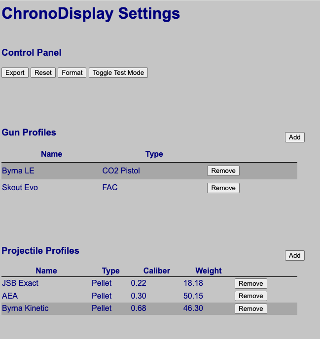

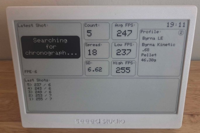

I've been working on a new display for the FX Chrono v1 (the one thats on sale now at UA) so I didn't have to use my phone during range days. I wanted something that was larger, visible in sunlight and could export my data after a session. I ended up finding a newer 7.5 epaper (eink) display from Seeed Studio and using that as the base with a built-in esp32c3.
The built-in microcontroller has both BLE and wifi capabilities so its able to connect to the FX Chrono as well as host a basic webserver for setting configuration:

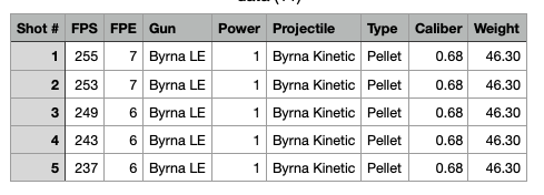

And heres a quick look at the exported csv:
Besides looking for a quick way to reference session data and SD, I wanted the ability to quickly switch between gun and projectile profiles while at the range and see FPE calculations in real time beside the FPS.
