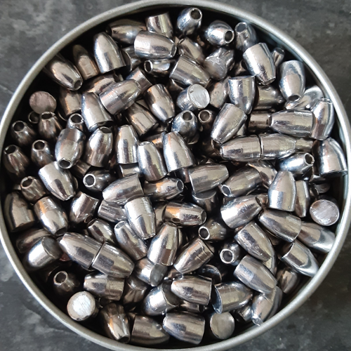

I'm a home caster. These are my .22 cal NOE slugs. HP drop at 23gr average. I run pure lead only. I don't water quench my slugs at all. I also have a few Molds for .25 cal as well. Both pellet and slugs. Love never having to worry about not having ammo. If I'm low, I fire up the pot and get to casting.

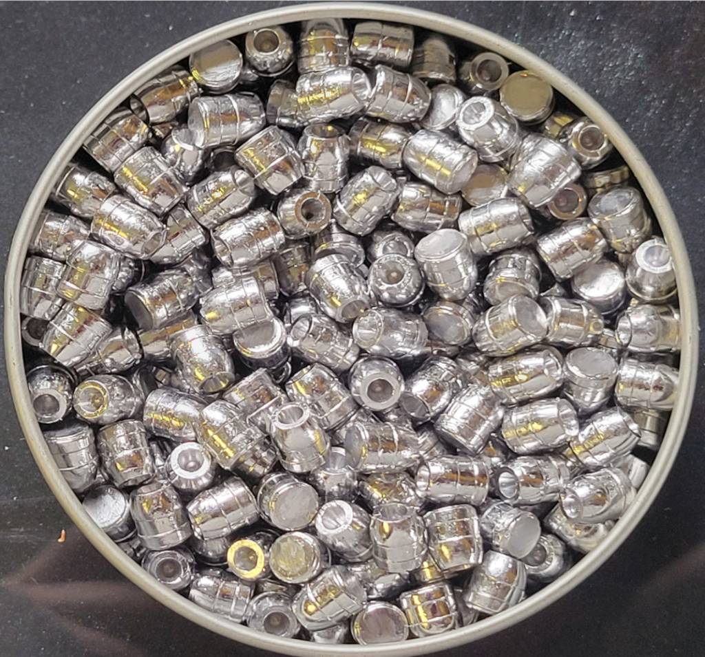

this is MP .22 cal

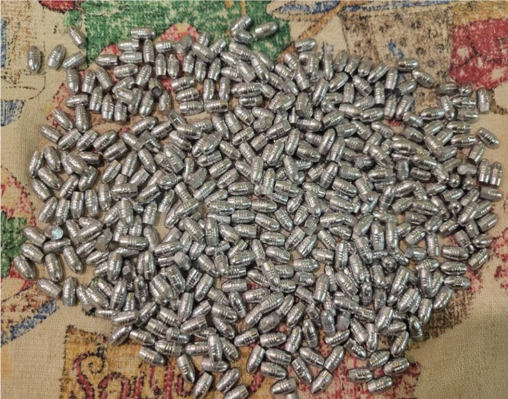

 .25 cal version of the first .22 cal slugs

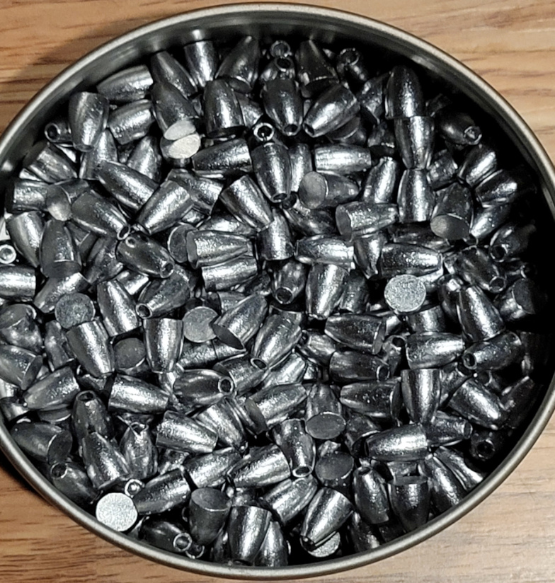

 Custom tailless .25 cal boat tail slug
Man I’m looking at the tail-less 25 and think they may work in my huben. I have followed roachcreek and have had success with shooting home pours out of my Edgun 30.
I was having stability issues with the full boat tail and decided to throw caution to the wind and have the NOE mold decked down after hand shaving a few dozen slugs down for testing. it helped my issue a lot and I went full blown on the mold after trial. They are monsters out to about 85 yards. After that they tend to fall off on accuracy that I'm still working to sort out. The huge hollow point is addictive sounding when it connects with a target. Awesome POP. they weigh in at 34 gr if I recall.
View attachment 198582this is MP .22 cal
View attachment 198589 .25 cal version of the first .22 cal slugs
View attachment 198598 Custom tailless .25 cal boat tail slug

I ’m interested in getting those .22 and .25 noe slug mold’s but im curious how accurate they are. Do you mind sharing what guns you’re shooting them out of and what your accuracy is like?
@dannya1a What’s the grain weight on those MP .22 boattails? Which platform(s) are you shooting/have you shot them from? Those NOE .22 HP slugs look nice too.
I have the same MP. 22 mold on 5,55mm diameter. If I remember correctly it weighs a little under 40 grain. I can check the weight a little later. I use pure Pb and 2% Sn alloy
