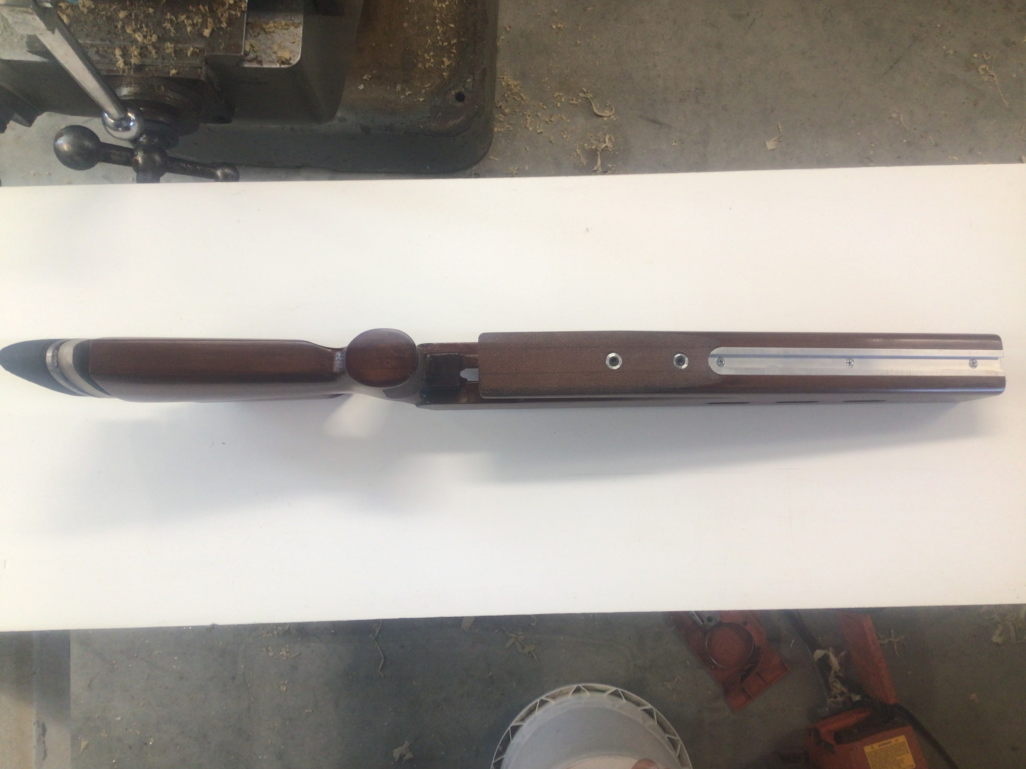

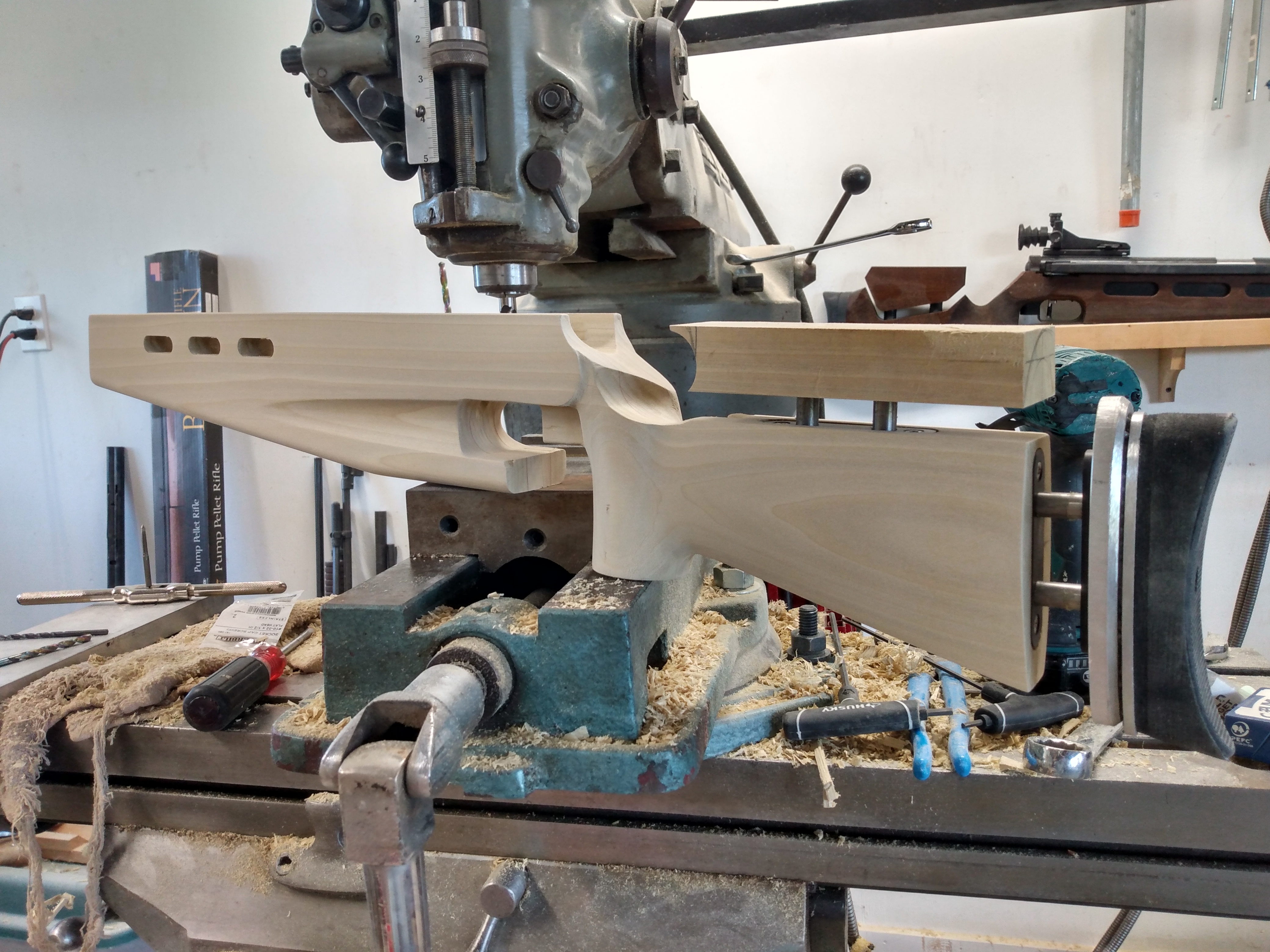

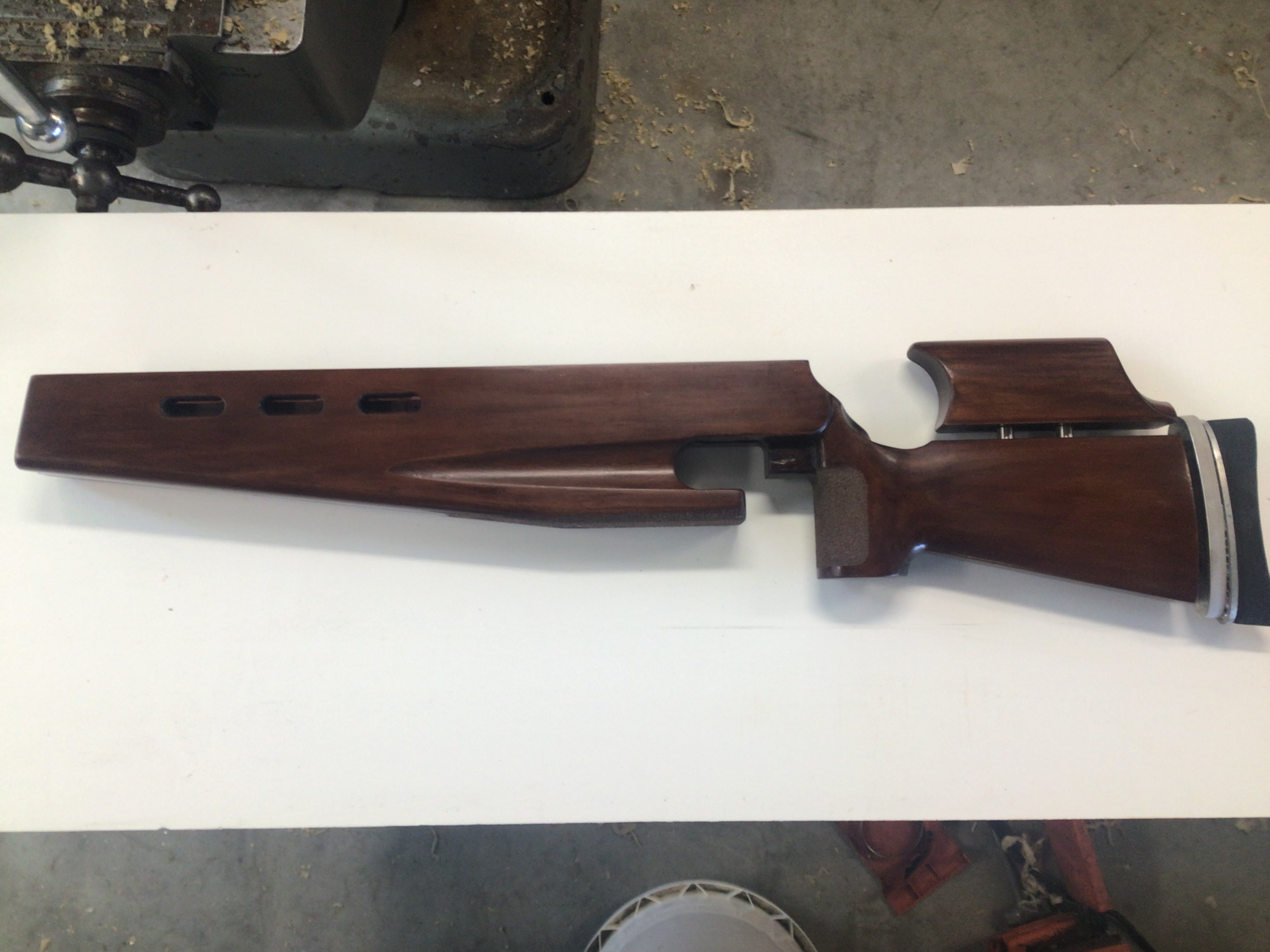

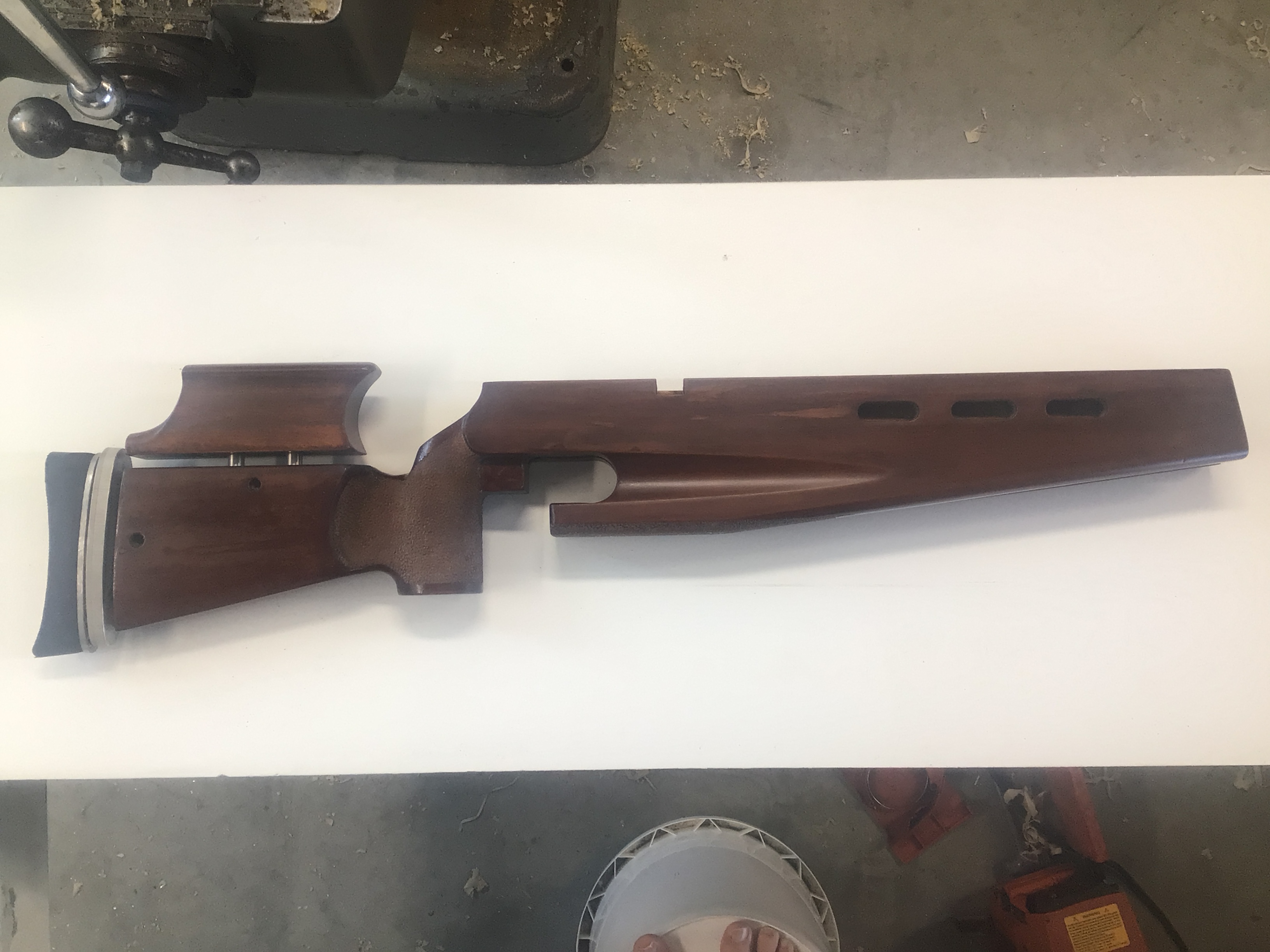

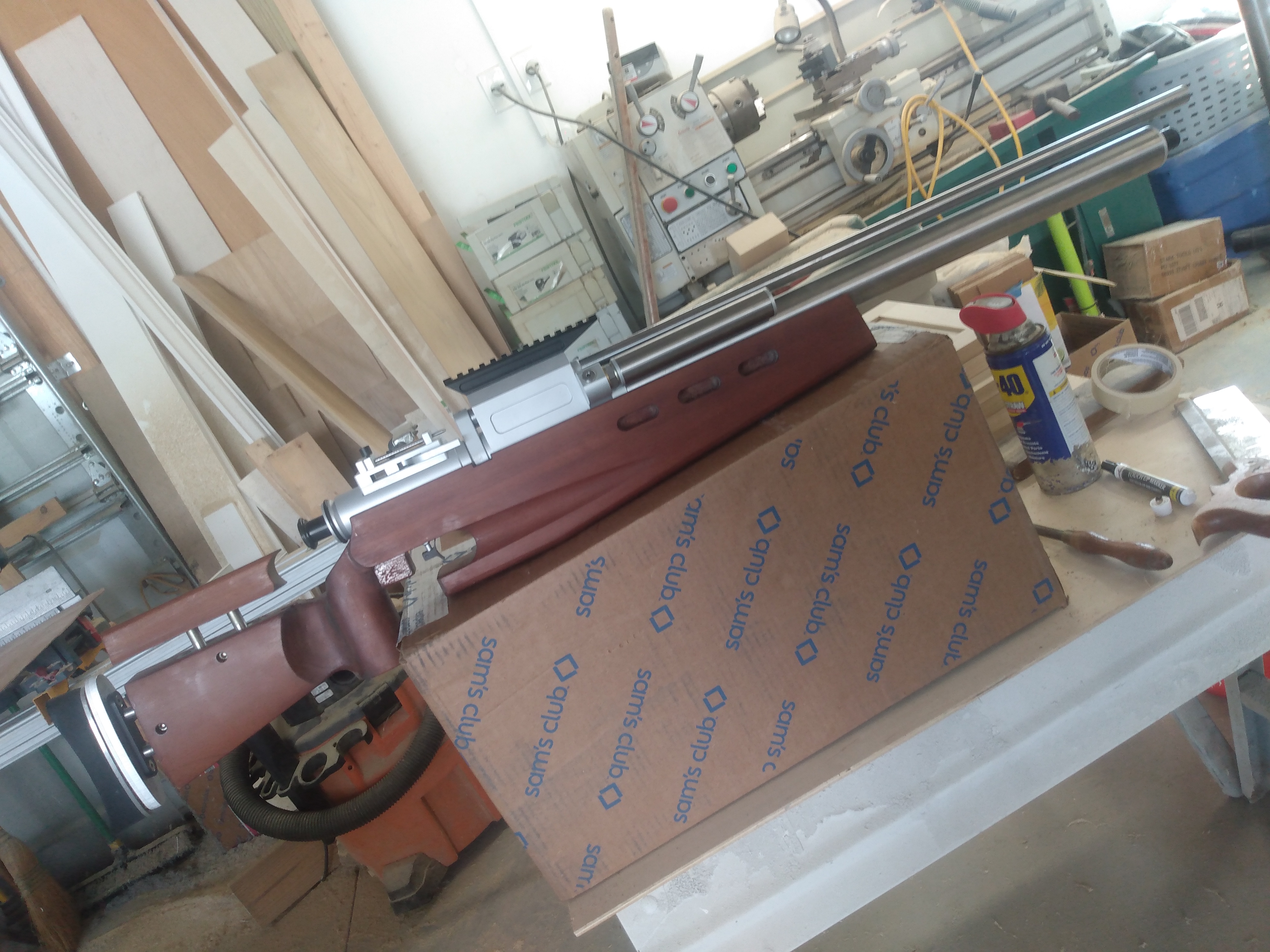

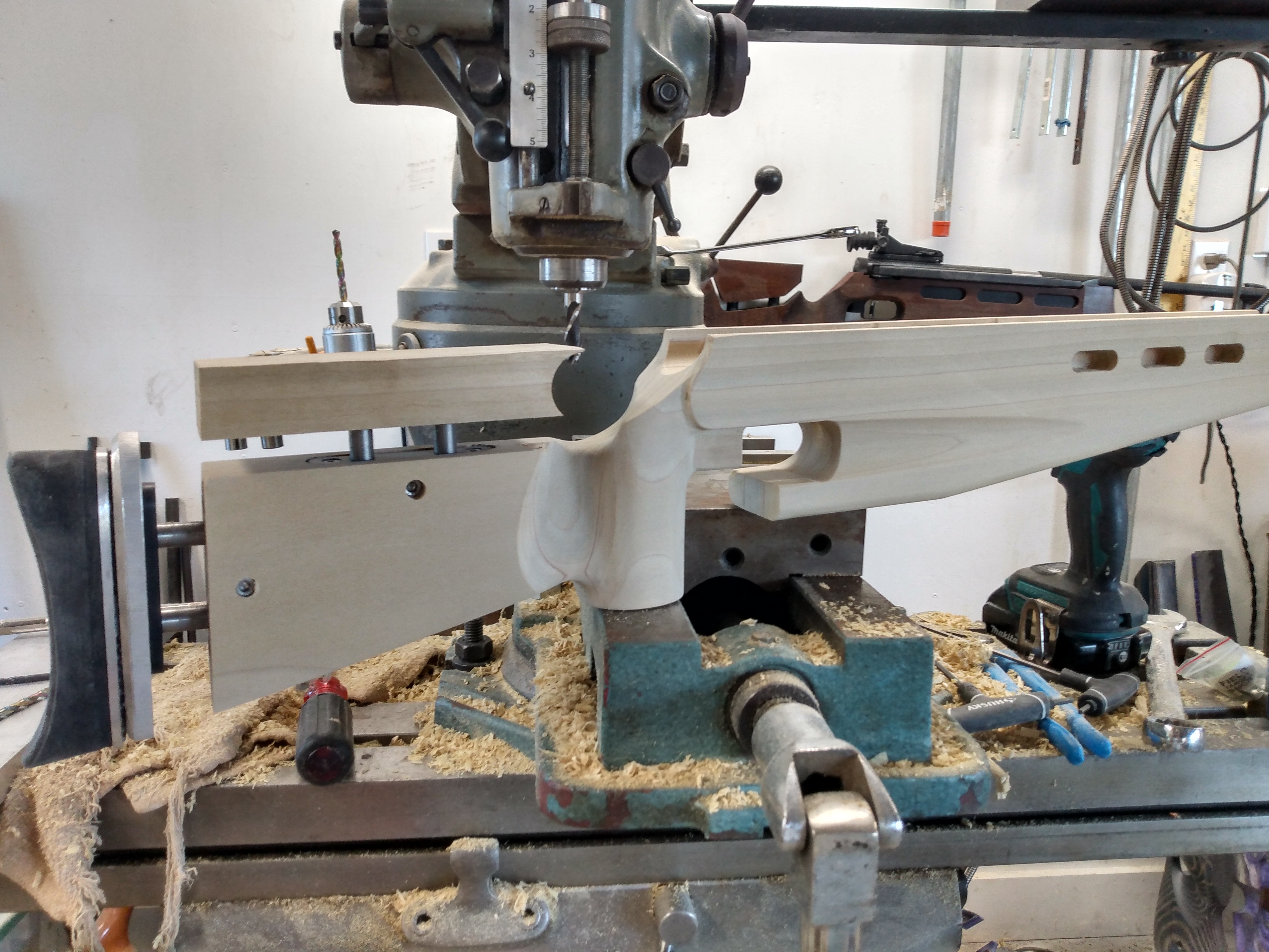

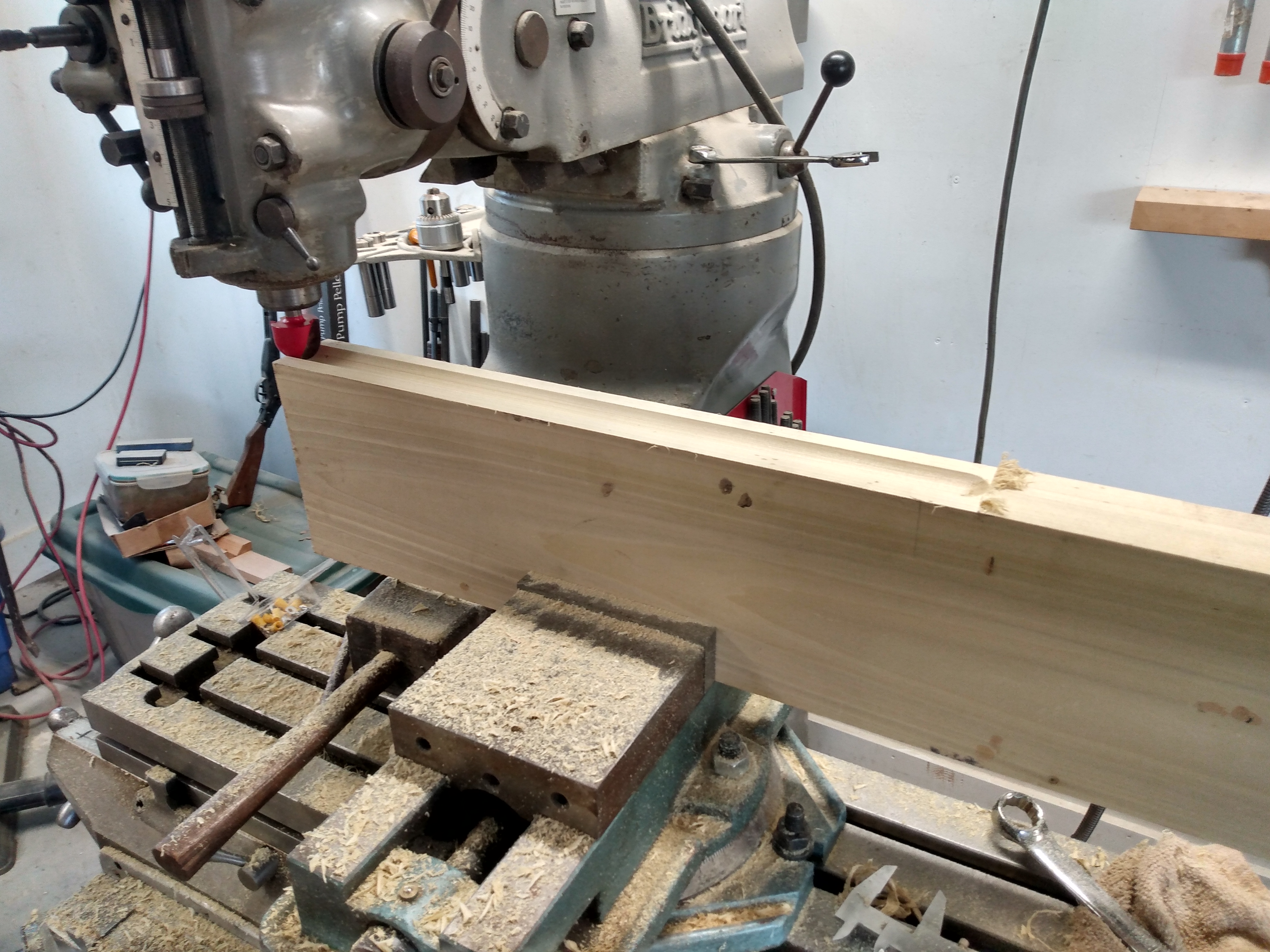

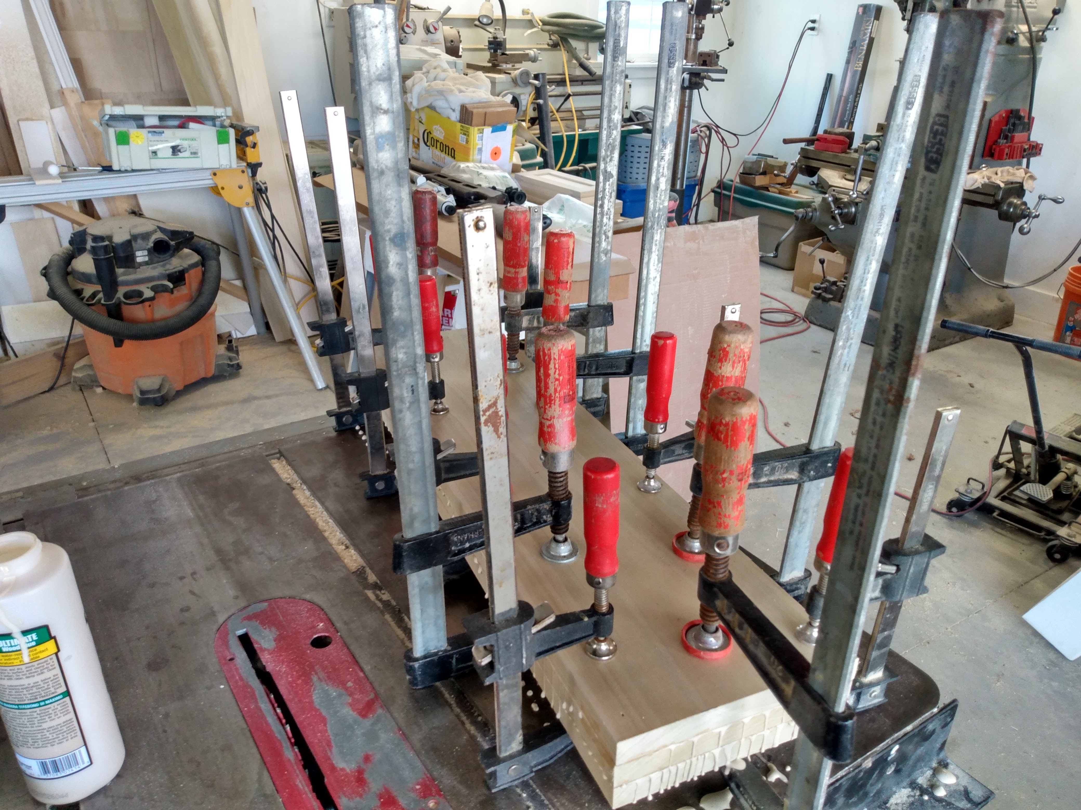

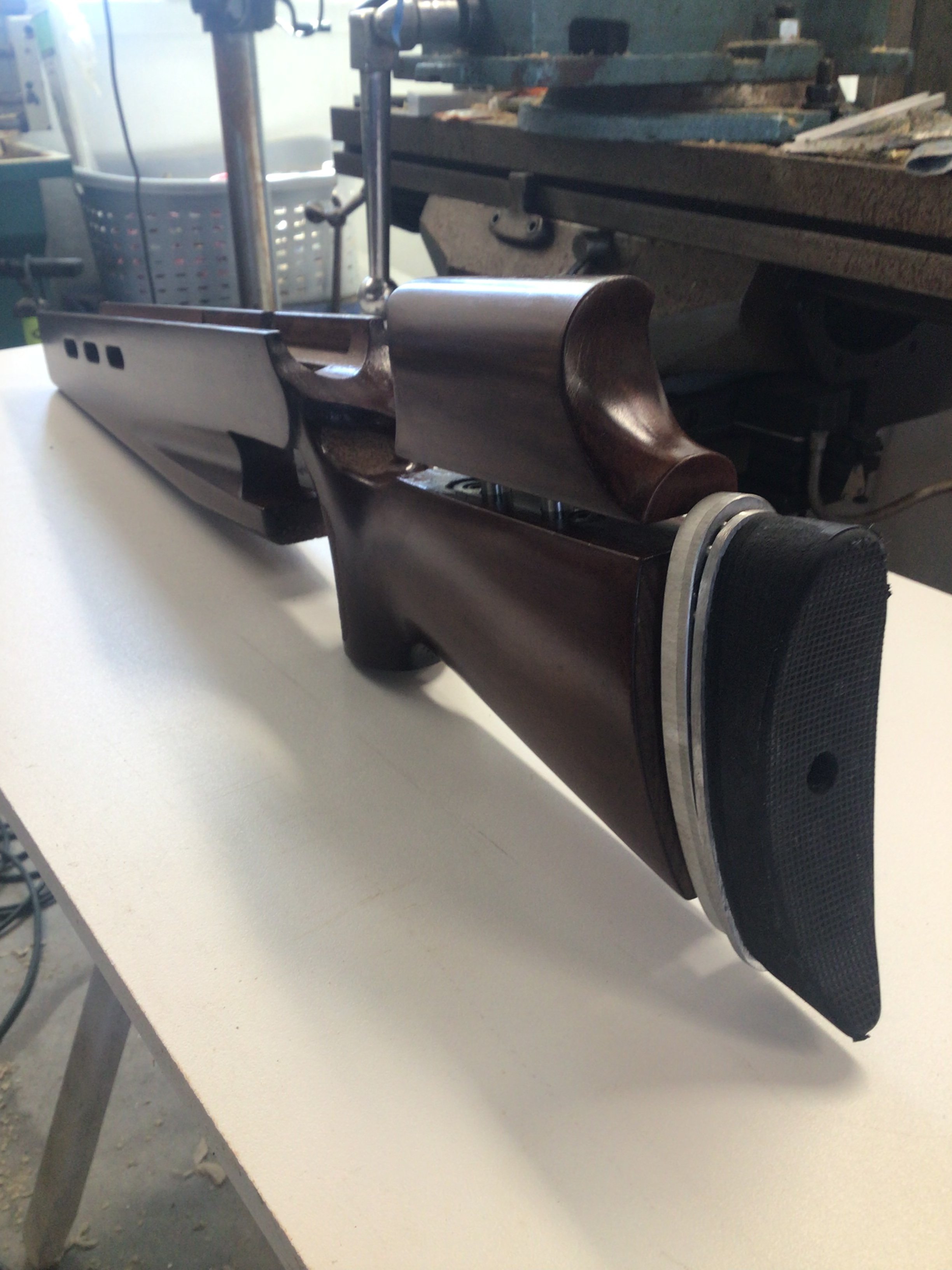

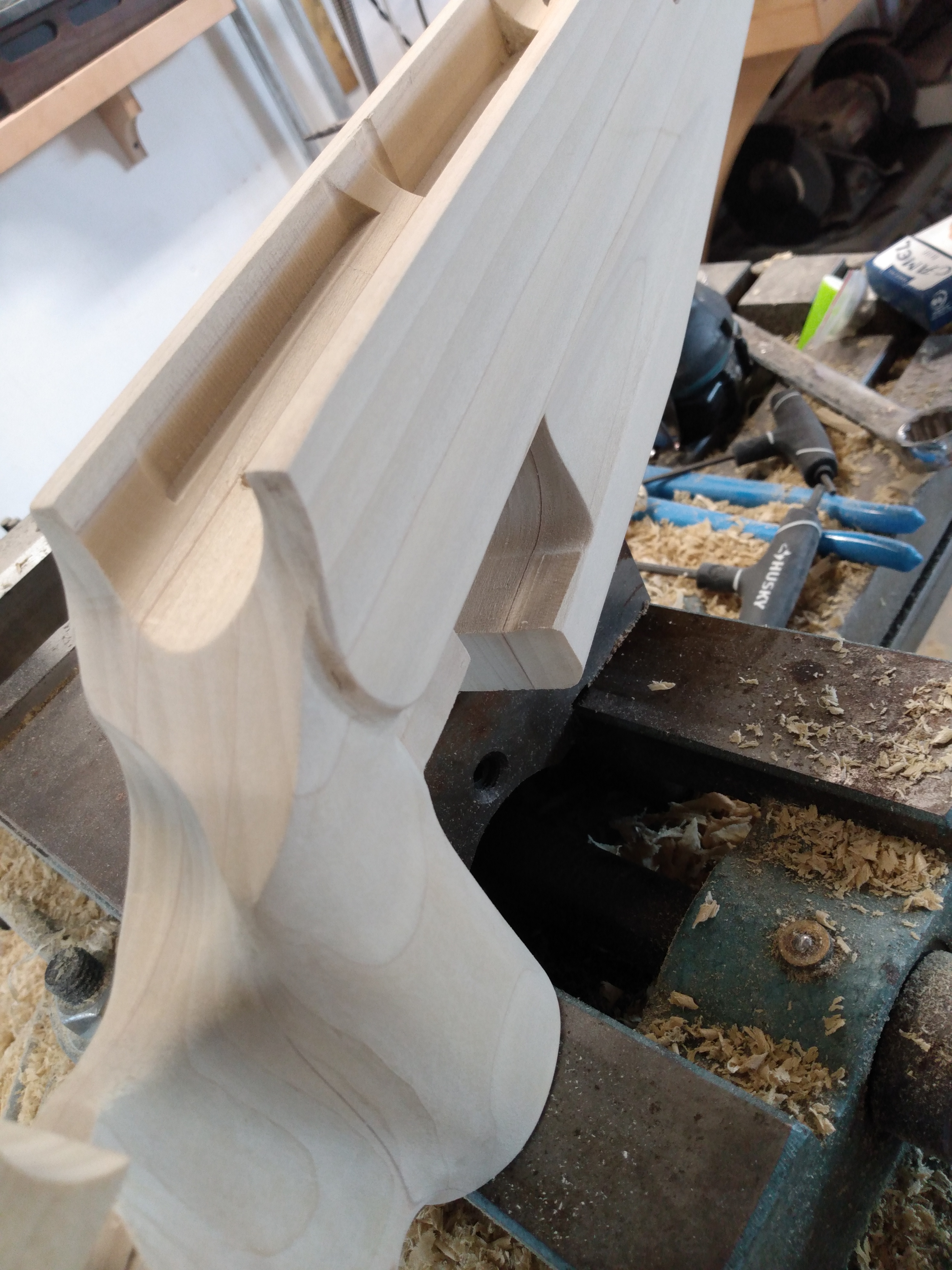

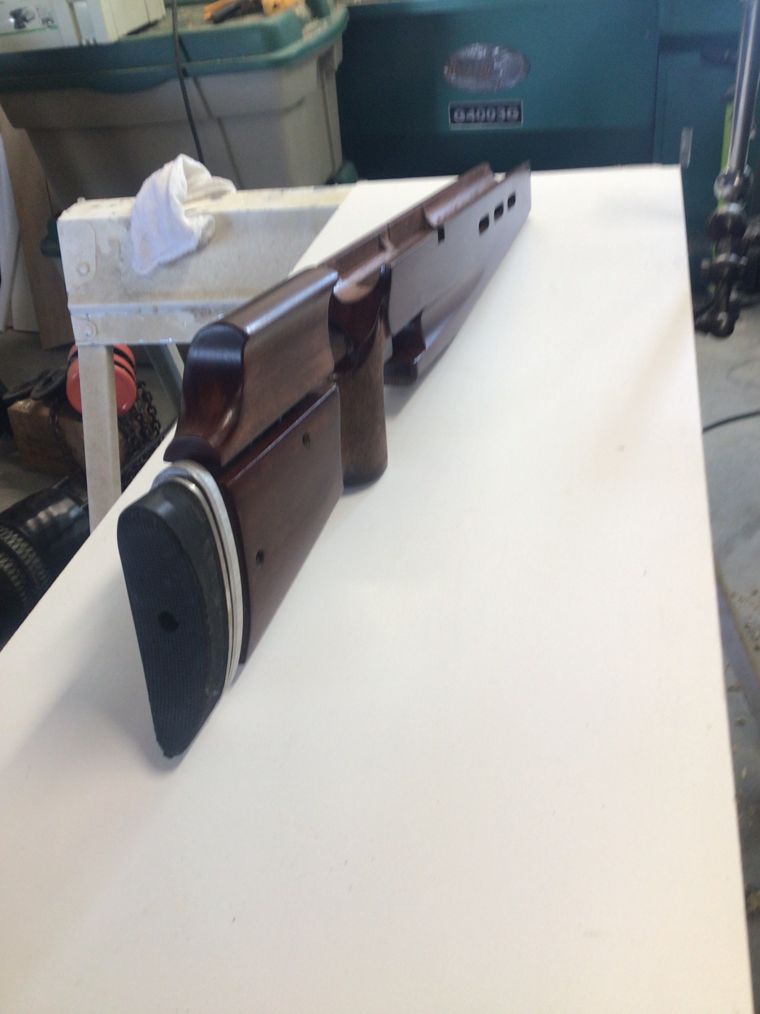

Recently a buddy of mine asked me if I would make him a stock for his Thomas HPX benchrest rifle. His only request was that he could fire it from his shoulder. I had been wanting to build myself a stock for my RAW TM 1000….but never having built a rifle stock before, I agreed, hoping to learn a thing or two before bui one for myself. This is what I came up with……
A quick drawing to have a place to start…

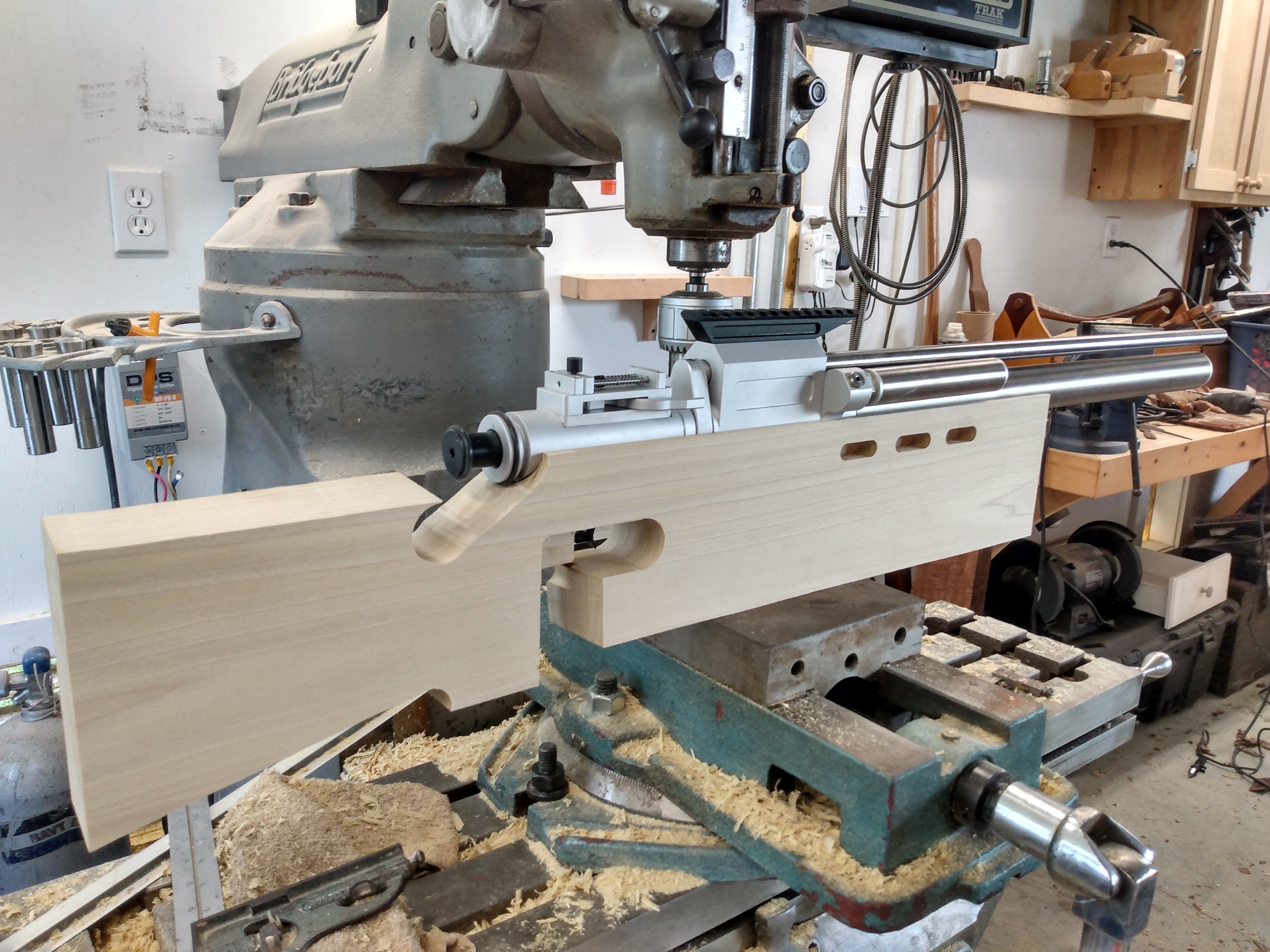

since the only sizable piece of lumber I had in the shop was a 1x8x7’ board…that was it…
set up for inletting…
…..a few hrs later.…
…..a little later…
…..another angle.….…

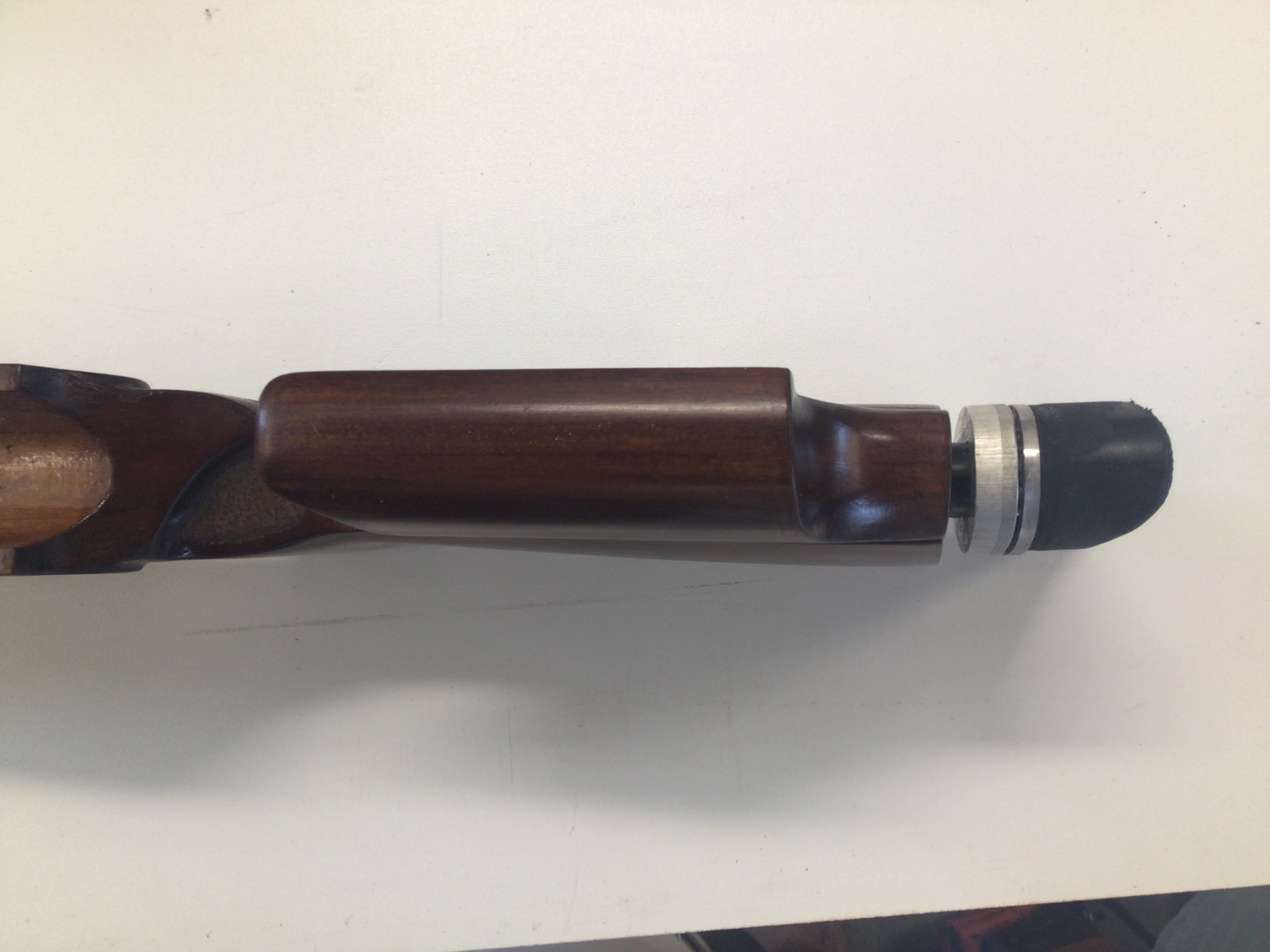

……grip detail…

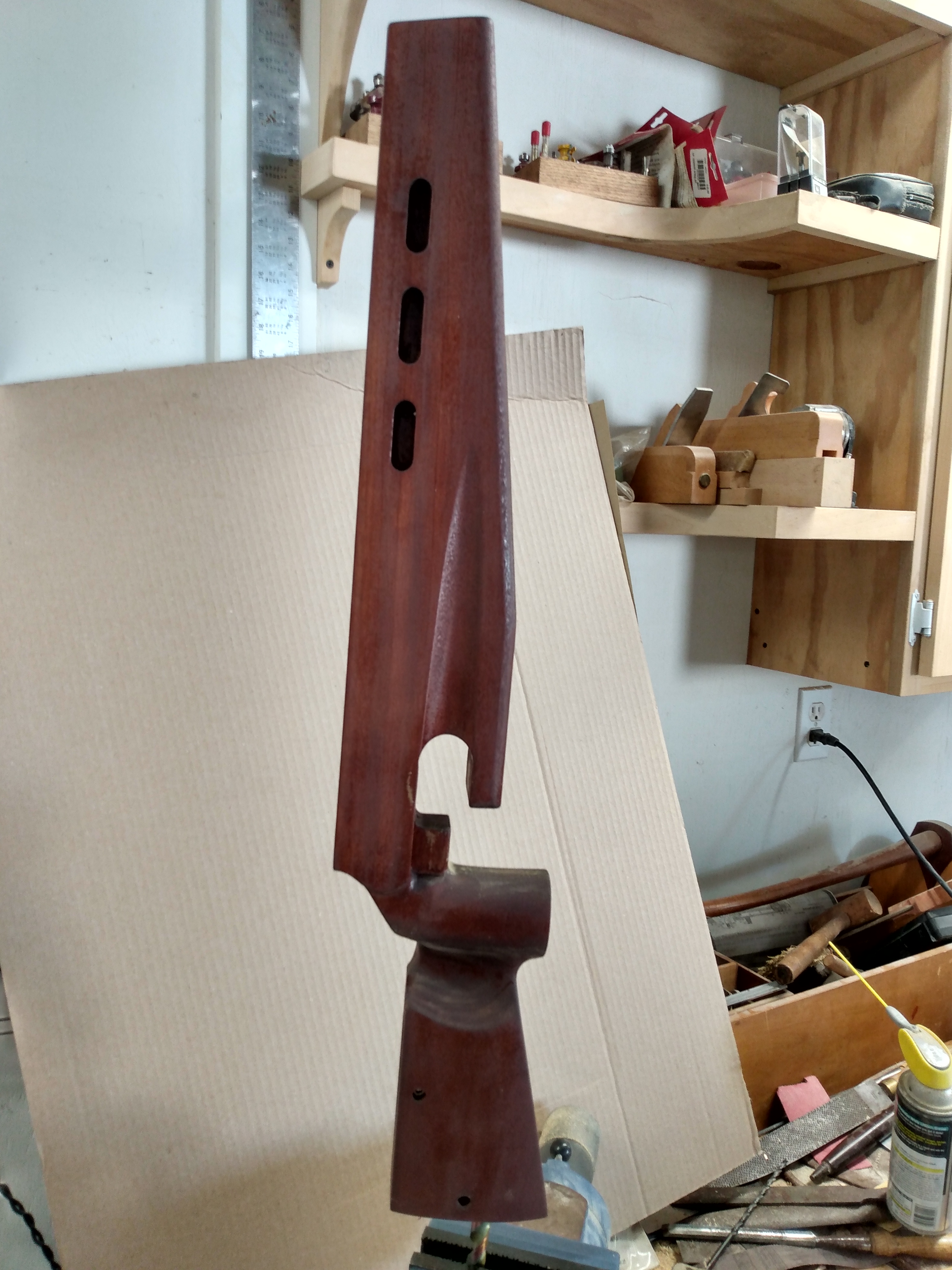

…..my experience staining Poplar is less than stellar..I used L’Oreal permanent hair dye…6RB…went on ok..a little fiddly to even out color.…
….final test fit so I could return the rifle…
….finished stock..
…well that’s it…I learned a lot of what works, what doesn’t..the order of processes..choosing a more stock friendly material…finish over dye requires a sprayed sealer coat.. and finally, how to create a new post on AGN.

@JohnTaylor Are the three slots in the stock a design choice? The target stocks for QB78/79, while a far cry in craftsmanship from your work, have the same slots.
I loosely patterned the stock after a rifle I’ve had forever…a Diana 75.. it has slots in the forestock and I thought they broke up that large expanse of flat nicely, so I went with them. Plus I think they look kinda neat..
