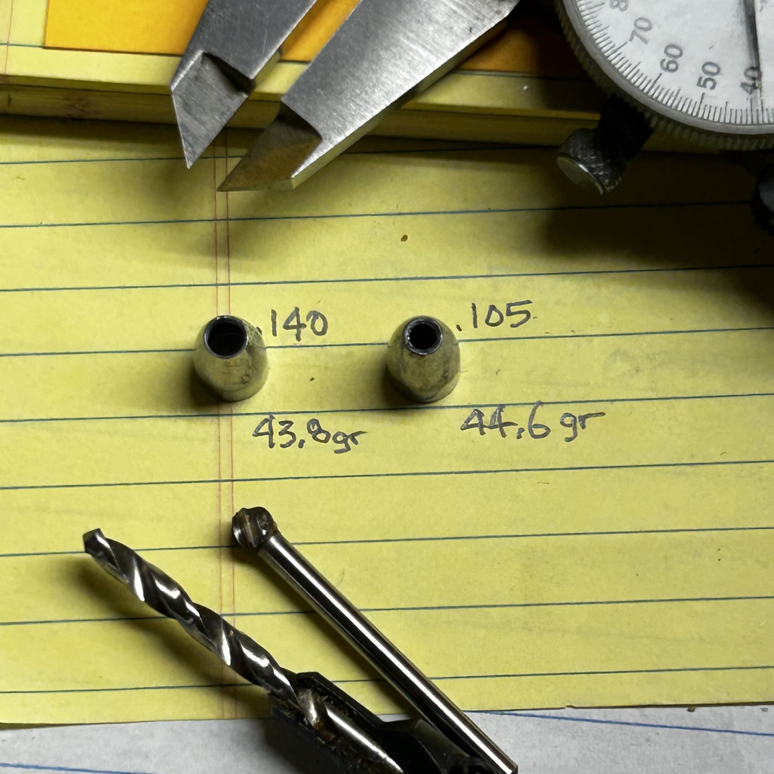

The cavity inside the hybrids actually gets larger towards the base. So there’s more relief that could be done resulting in an even larger HP opening. The amount of lead removed is pretty minimal weight wise relative to the increase in the opening..something like 30%. Testing will determine if it was worth the minimal effort.
