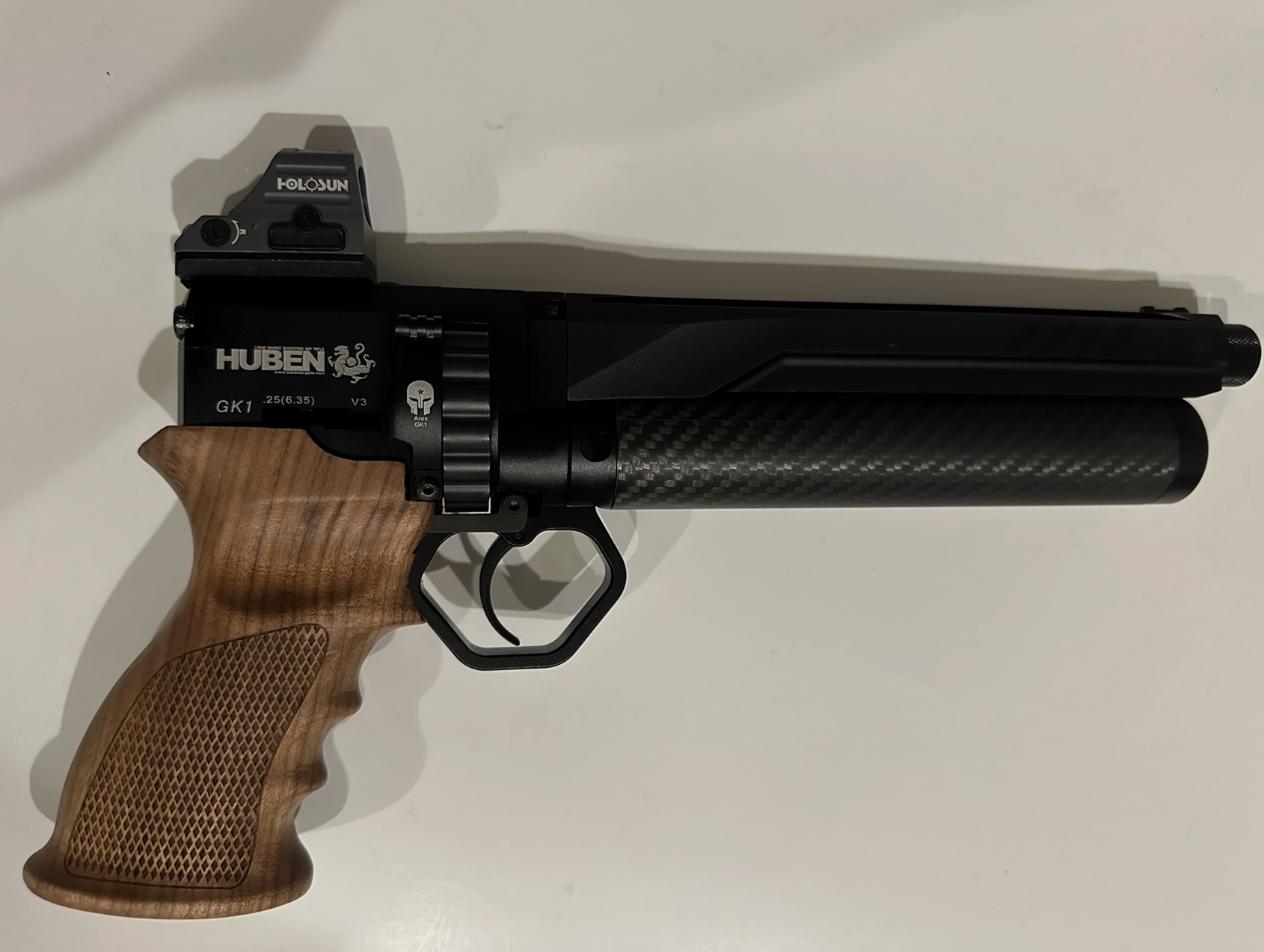

Mounted and attempted to sight in my reflex sight. I started at 10 yards Shooting .25 GK1 V3 with the Holosun 507c mounted using a ReddotMate mounting plate. I shot JSB King Diabolo pellets, 24.39 grains I believe. Anyhow, I seem to have run out of elevation before getting the center dot aligned with my POA The best I got was consistent POI hits about 0.5” - 1” low. Doe anyone have any suggestions on how to get past this hurdle and improve my sight in process with the GK1?

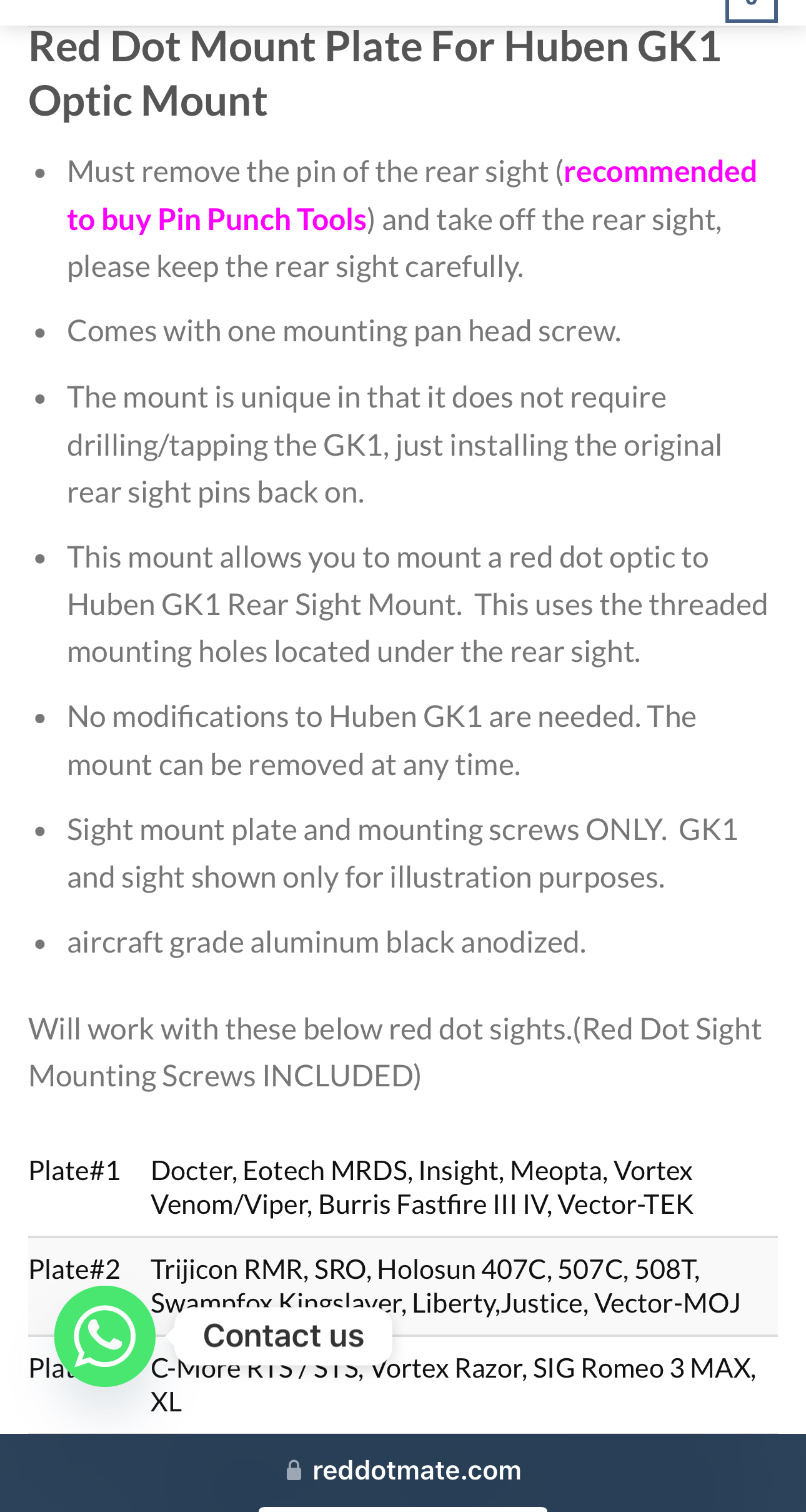

@Michael The only adapter I used is for the mounting plate to affix the adapter to the hole that was used to adjust the elevation with the stock rear sight.you can see the plate between the reflex sight and the top of the receiver in the photo.

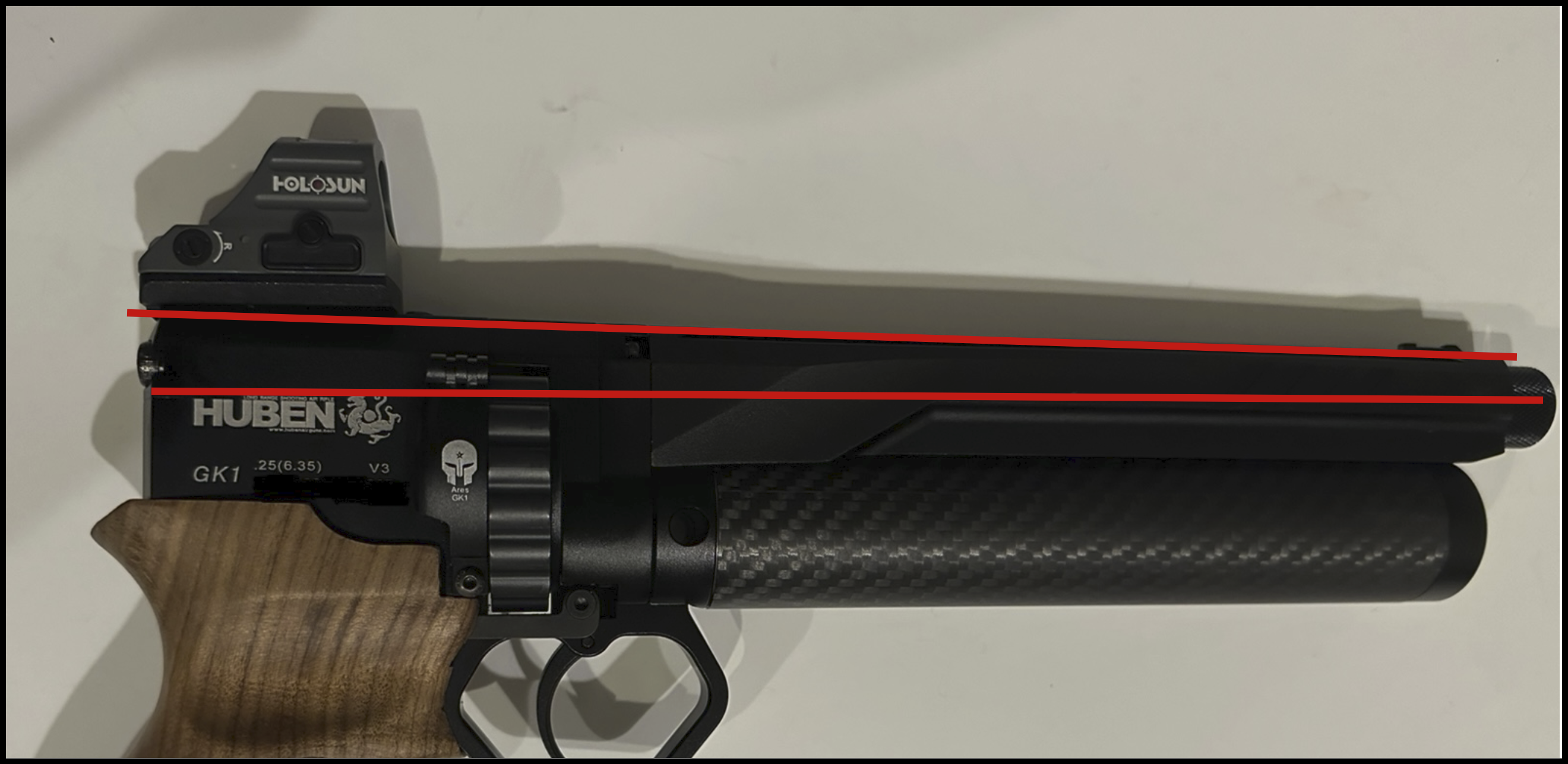

I don't know this gun. And everything's black and lots of shadows. So, I can't tell how it's mounted. But my eyes see a difference in the plane of the base of the optic and the barrel axis. It may be optical illusion due to the all-black / shadows thing going on. But I've drawn this (perhaps exaggerated a bit on the top line) to demonstrate what I think I'm seeing. But if that was the case, you'd more likely be shooting HIGH. So, I'm not sure what's going on.

@Racer88 It's hard to see the barrel alignment because the gun has a shroud and moderator adapter at the crown that cover the barrel. Consequently, none of the barrel is visible in the photo. In addition, the bottom red line isn't flowing the shroud in a straight line.

Yep... admittedly, I was guessing. And I realized that the photo may not really reveal the alignment. Could be an "optical illusion." Plus, if it WAS correct, you'd be shooting high, not low. Soooooooo.... Let us know what you find out!

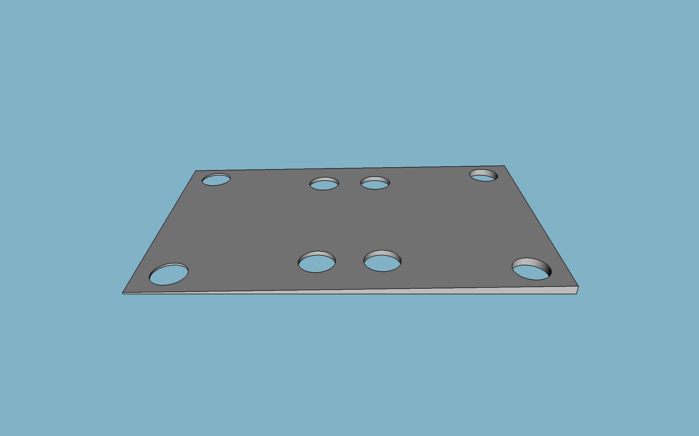

I had this problem. One solution requires a very thin wedge. I printed one. It might have been either 1 degree or 1/2 degreeb(don't remember). I basically copied the RMR foot print. It worked well enough. However, the culprit is insufficient adjustment of the Holosun sight to handle short vs long range and high sightline vs the barrel. So my wedge worked for shorter range but not longer. I'd guess you'd pick the range you want to shoot at and make a wedge that would have the optics centered in the elevation adjustment range?

Getting back to this, I used a 1/2 degree wedge. I put an extra set of holes in it so the wedge can either raise or lower an RMR sight. Printed with 0.05mm layers, it takes 11 minutes to print. Maybe someone will find it useful. I printed it with PETG.

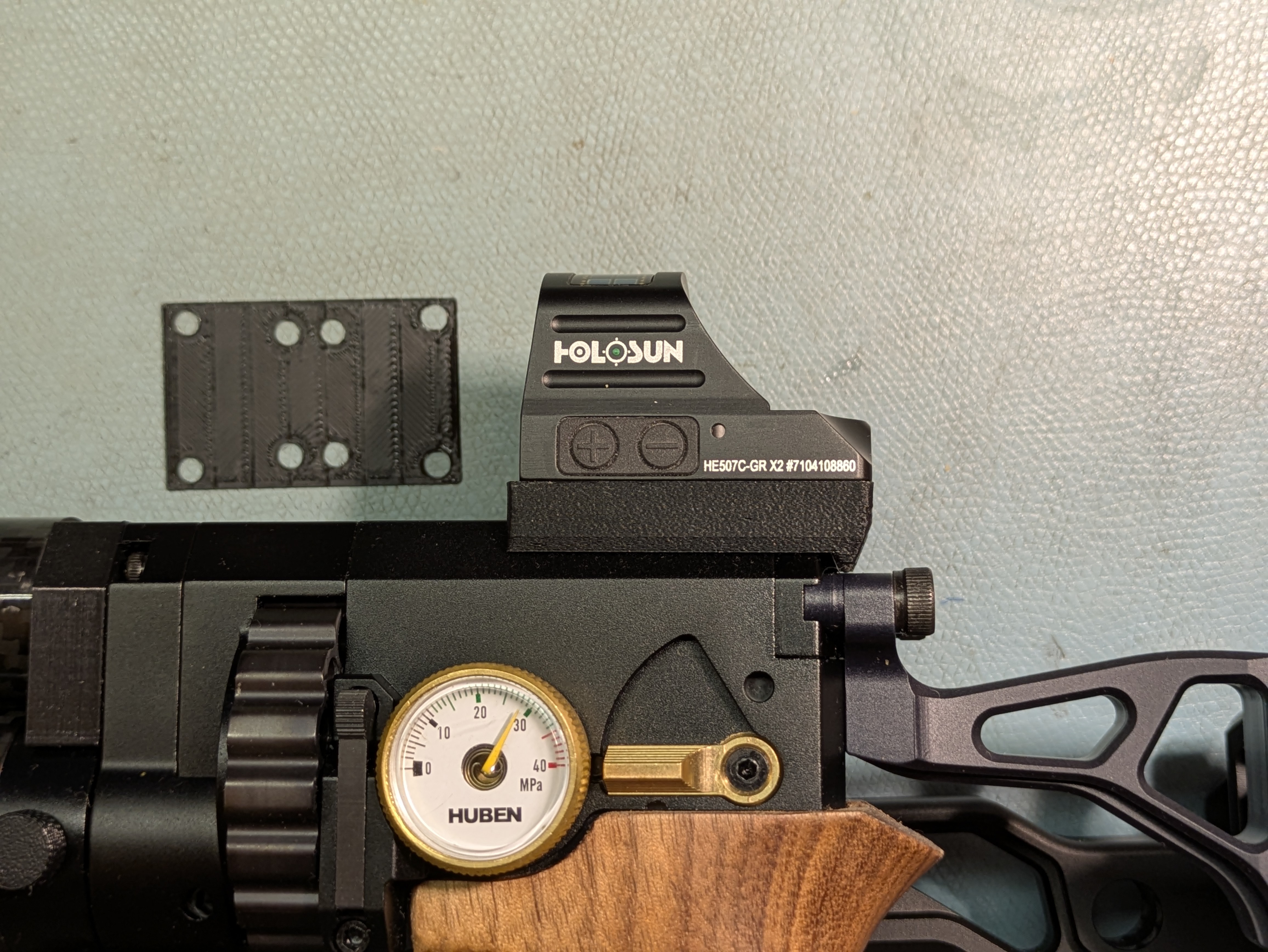

It's kind of funny, the wedge isn't really visible when installed, It's 0.023" thick at the thickest point, and 0.010" thick at the thinnest. Here's a pic of the 1 degree wedge. (Just so the angle is more obvious!)
My Holosun came with an RMR mount. I used the huben3dparts Unimount with RMR. In between the sight and the Unimount I installed the wedge. The holes in the wedge allow the pins to go through, that are required for the sight registration. The wedge is so thin, you don't need to do anything special with the screws, just use what you have.
As mentioned previously, you need to ensure the screws are not so long that they bottom out in the hole before fully tightening. At least for me, the screws were fine.
To show you it installed with my Holosun, I'd need to take off the sight. I'd rather not do that if I don't have to.
The wedge goes between the sight and the Unimount, right where the line is, just under the HE507C-GR text.
Hope that helps.
