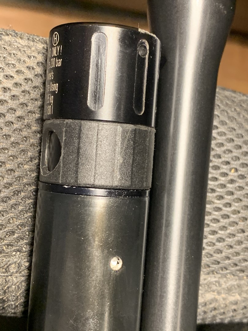

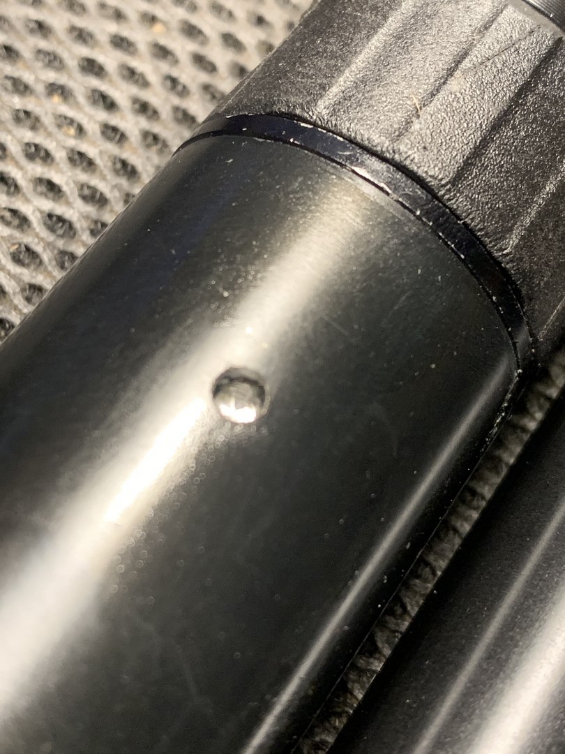

Aloha,
Does anyone else have a small blind hole on the side of the air cylinder? I may have had a pin drilled out to remove the end plug?
Mahalo,
Peep
There was no retaining pin. The hole is there to help prevent a motivated person from earning the Darwin Award.
If the cap is unscrewed while pressurized, the O-ring will pass the hole while there is still plenty of thread engagement, allowing the air to evacuate harmlessly...to be contrasted against the alternative which is to let the user continue until the end cap goes flying at a high rate of speed as it seeks the nearest cranium to slow its departure.
