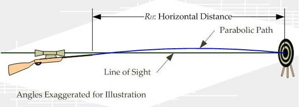

Tom Gaylord explains in pretty good detail what I was attempting to explain in my first post.
He even mentions the rise of the pellet between first and secondary zero isn't much more than a pellet width. Which is why I try to adjust my zero to graze the top arc of the trajectory.
https://www.pyramydair.com/blog/2005/06/at-what-range-should-you-zero-your-scope/
No airgun that I'm aware of could possibly have a close zero at 25 yards unless the scope has differently elevated ring mounts or an outrageous stack of shims, so anything over 25 is going to require some degree of holdOVER.

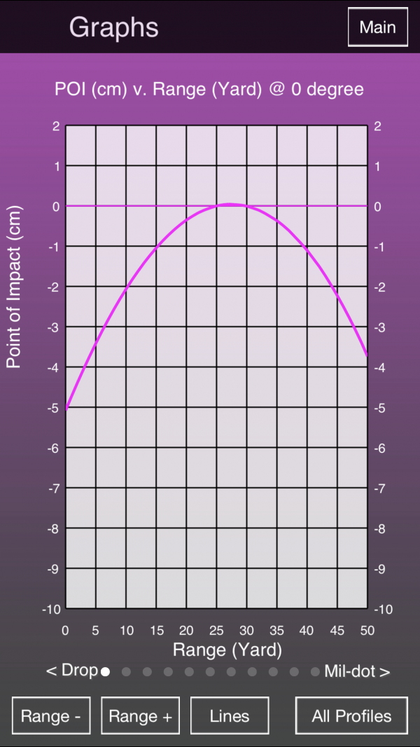

If his gun is what I mentioned (Mrod .22 shooting 18.1jsb at 850fps with his scope 2" above the bore zero at 25yds) then his close zero would be 25yds and his far zero would be 29.5yds.
The pellet would "peak" at 28yds.
Try these #'s in any of the ballistics programs.

If you are shooting at typical velocities (about 850-900 fps), using your provided scope height and pellet you're zeroed very near peak trajectory, so you'll be bang on from about 15-30yards. Other than that, only holdovers
1f44d-1f3fb.svg
How in the world are you 5" low at the muzzle ?
Metric units - 5cm. It is right there at the top of the chart
Oh! Gotcha! LOL
Now it makes sense. 😅
