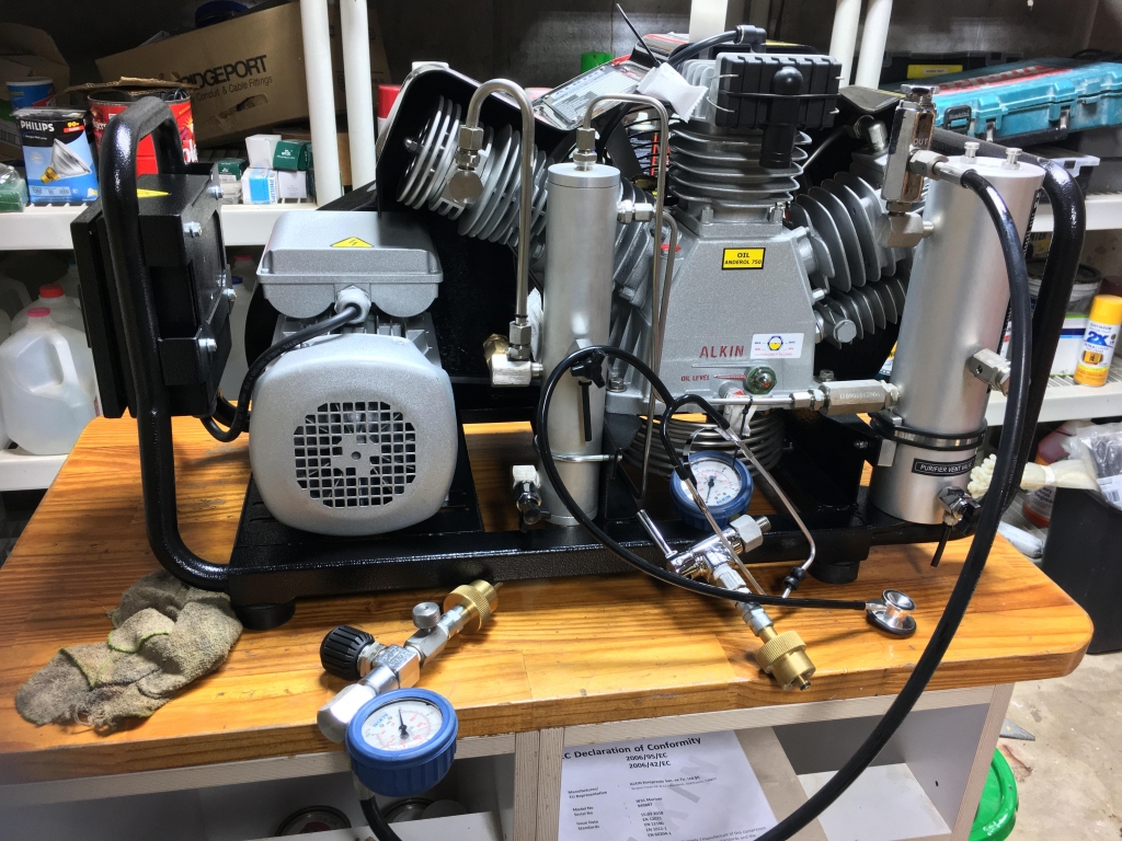

I’m just starting Tech class at Alkin and studying Thermal Dynamics on my own more in depth.
I went with Alkin for several reasons.
1. 2 year full warranty buyer pays shipping but I’m 1.5 hours from plant.
2. Alkin has The US Navy contract and Alkin is who donated compressors to Search & Rescue for boys trapped in flooded cave system.
3. 100% cycle duty time. I’m never going to be running it 10 hours straight; but good to know it’s backed by guarantee to do so for at least 2 years or they wouldn’t have it.
4. lowest, coolest runner at 1050rpm’s. I have the 220 3 stage and it’s quiet. I’m gonna do a video in 4th week of this November when I complete Technician school.
I wasn’t aware of Daystate/Coltri offering a 4 stage. I looked at Arctic 4 stage. That’s a $20K block alone. Their 3 stage is $9K. In the highest end of compressors you have In alphabetical order Arctic, Bauer, Eagle, Mako. Older Walter Kidde & Ingersoll Rand were tanks but today, those 4 are usually considered top.
I’m close enough & opportunity knocked. I’m disabled and can only do so much. I represent Alkin but I don’t have a web site. I’ll be listed on theirs come 2020. Being limited by income I’m only allowed to list MSRP. I’d rather sell more, make less, and if within that month my limit is reached, any further profits will be divided between Valor House, AGN & GTA.
Honestly I don’t miss hand pumping and still love spring guns. I’m interested in long range slugs, which pretty much would require a compressor, step down in-line reg for the type of shooting I’d even want to bother with if at all. I don’t blame anyone for going for less expensive. If I compare my Mid to high end guns, I used my mids more. $30K since 2011. I would have been better off with a decent machine shop. So I’m trying to do that now and help my 9 children and guys that want a dependable affordable compressor. Oh, and I can finance if you wish to apply. Anything else you must contact by phone# given via PM.
I hope I’m not violating anything but I’ve publicly declared I’m trying to help Vets & donating to our forum & GTA who’s got a huge kick in the cojones as web host is hiking price 600%. Advertising was/is free there. I don’t advertise but want to help anyone this hobby helps by proxy in any way.
Also any Vets, Police, 1st Responders and Disabled persons get an extra discount through me. I’m giving back as some gave and helped me, or I wouldn’t be here now.
Heat is your biggest enemy next to catastrophic structural failure should anything be faulty such as safety valves. They’re there to save you from hydro lock should it occur. I went “cheap” and got the W31E Mariner instead of the W32E Mariner that has auto everything & gauges on 2nd, 3rd stage. I’m not worried because it’s set to drain every 5 minutes. My 44cf is topped off from 2500-4500 in 3 minutes. I warm up 1 minute and pressure builds. I watch tank gauge climb, then close off main valve & bleed. I’m done within 5 minutes. That’s good and bad as this compressor is meant to run at temp for long times. Even to fill banks of big 220-440cf Nitrogen size cylinder banks. So I look at it as overkill I didn’t need but as a Deaker/Technician I have to have one.
