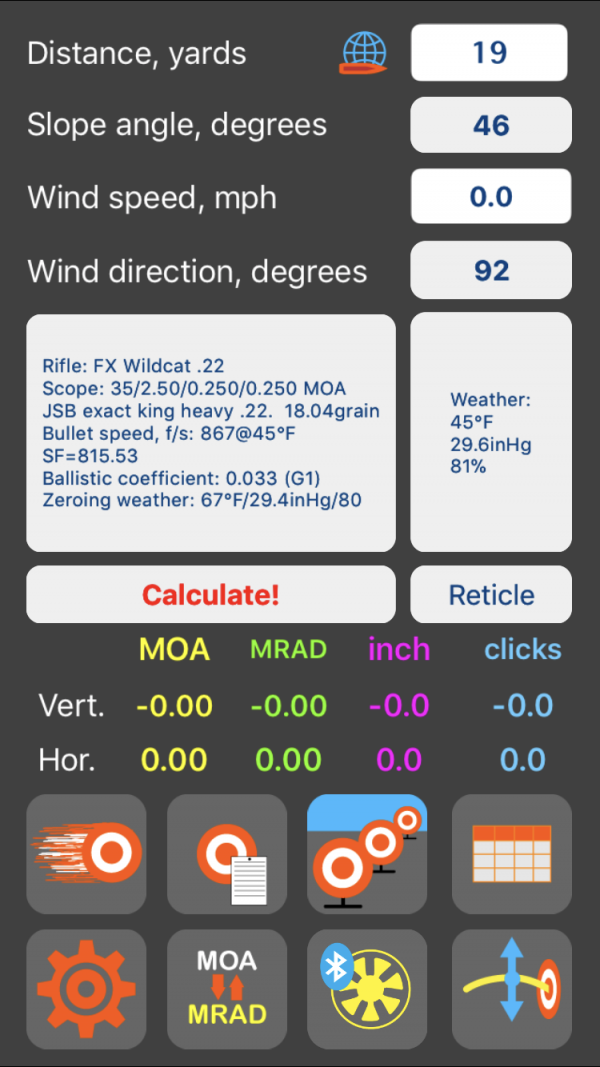

I use StrelokPro and I am confused on hold over/under for targets that are at extreme angles. If I am shooting upward at 45 degrees is the distance to the target the actual distance or is it the closer horizontal distance?
Strelock has input fields for both distance and angle. Not sure which distance to input for an extreme angle target.

After playing with Strelok Pro, it appears you would lase or estimate the range along your line of sight to the target, whatever the angle, and use that figure in the app, then inputting the shooting angle, Strelok makes the required calcs for hold over/under. Part of that calculation most likely being what the 0* horizontal distance along the ground is.
And the app shows changes in hold with as little as 10* angle for my rifle/ammo configuration.
I'd say the actual distance to the target as you're looking at it. Your line of sight. It seems to me that the app would do the trigonometric calculations once you input the true distance and angle. It already knows your pellets ballistics, your zero, etc..
I don't see it being the other way around, as in, you having to estimate the true horizontal distance along the ground, to the point below your target and then inputting angle and the app doing the trig calc from that. Seems to me that would be much less accurate, because you're trying to estimate a range to a point in empty space directly below your target.
