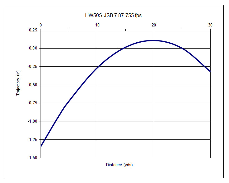

There is no right or wrong way to do these things, all I can do is tell you what I would do given your situation. As I understand it, you want to sight in at 10 yards in your basement, then be able to take game humanely from 10 to 20 yards. For hunting, I try to set up so that all I have to do is point and shoot at any distance I expect to encounter game (point blank range). For your gun and pellet choice, and assuming your scope setup is the same as on my R9, if you sight in 1/4" low at 10 yards, you will be within 1/4" from 10 yards to almost 30 yards. Although it would be better if you could just sight in at 25 yards, but as I understand it that is not possible right now. You really should evaluate your own setup using ballistic software of some kind, but this chart gives you the idea of what I am suggesting.
I suppose I should mention that to create this chart I did actually enter 25 yards as the zero distance, then just noted where you would have to zero at 10 yards to be on target at 25 yards.

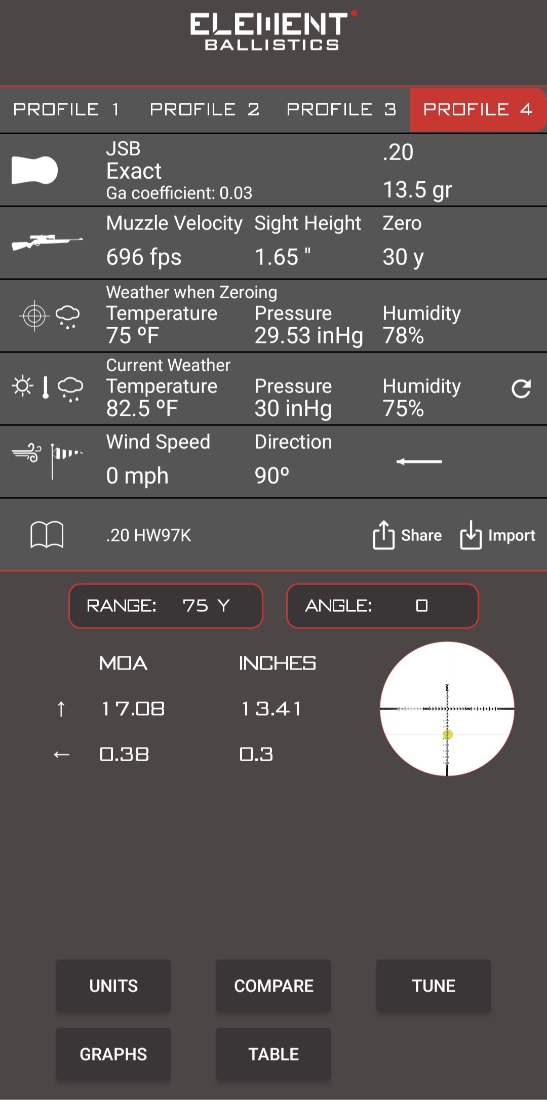

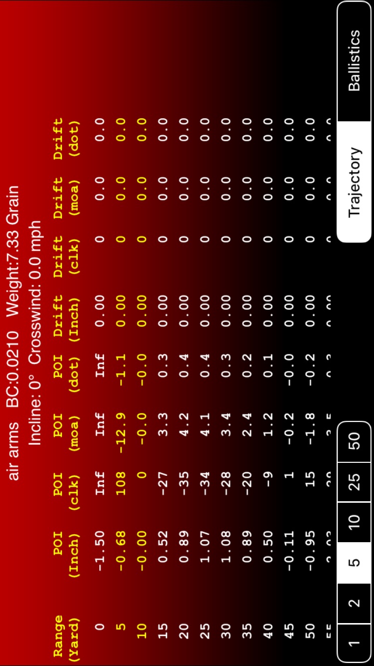

I use the ChairGun app to play with different things. I don’t know how accurate the app is but it’s fun to play with.
I use Chairgun as well its pretty accurate but using the right data is critical. Garbage in = Garbage out. You need the right scope height. Especially for near targets. The right velocity and BCs for further out. Unfortunately the provided BCs aren't always correct. BC changes with velocity and even between barrels.
Using two chronoraphs I've attained actual BCs and found that they didnt always match published BCs. Sometimes they were a little off, other times, they were a lot off.
