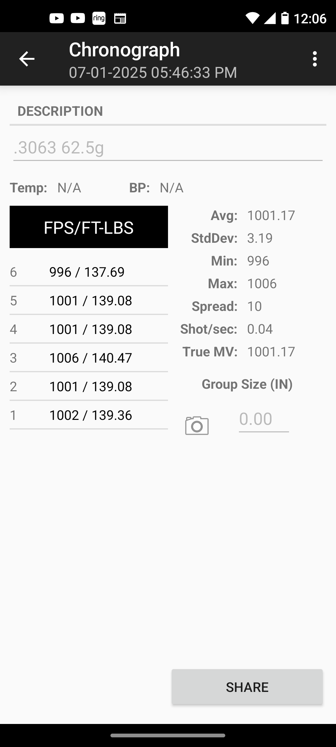

I have a Vulcan 3 in 30 cal with the new HP regulator and I'm shooting 62.5 grain slugs at 1000 fps / 139 fpe ... Sub MOA at 100 yards, love it. I've had it almost a year and a half and zero complaints

I have a Vulcan 3 in 30 cal with the new HP regulator and I'm shooting 62.5 grain slugs at 1010 ft per second, almost 140 fpe ... Sub MOA at 100 yards, love it. I've had it almost a year and a half and zero complaints

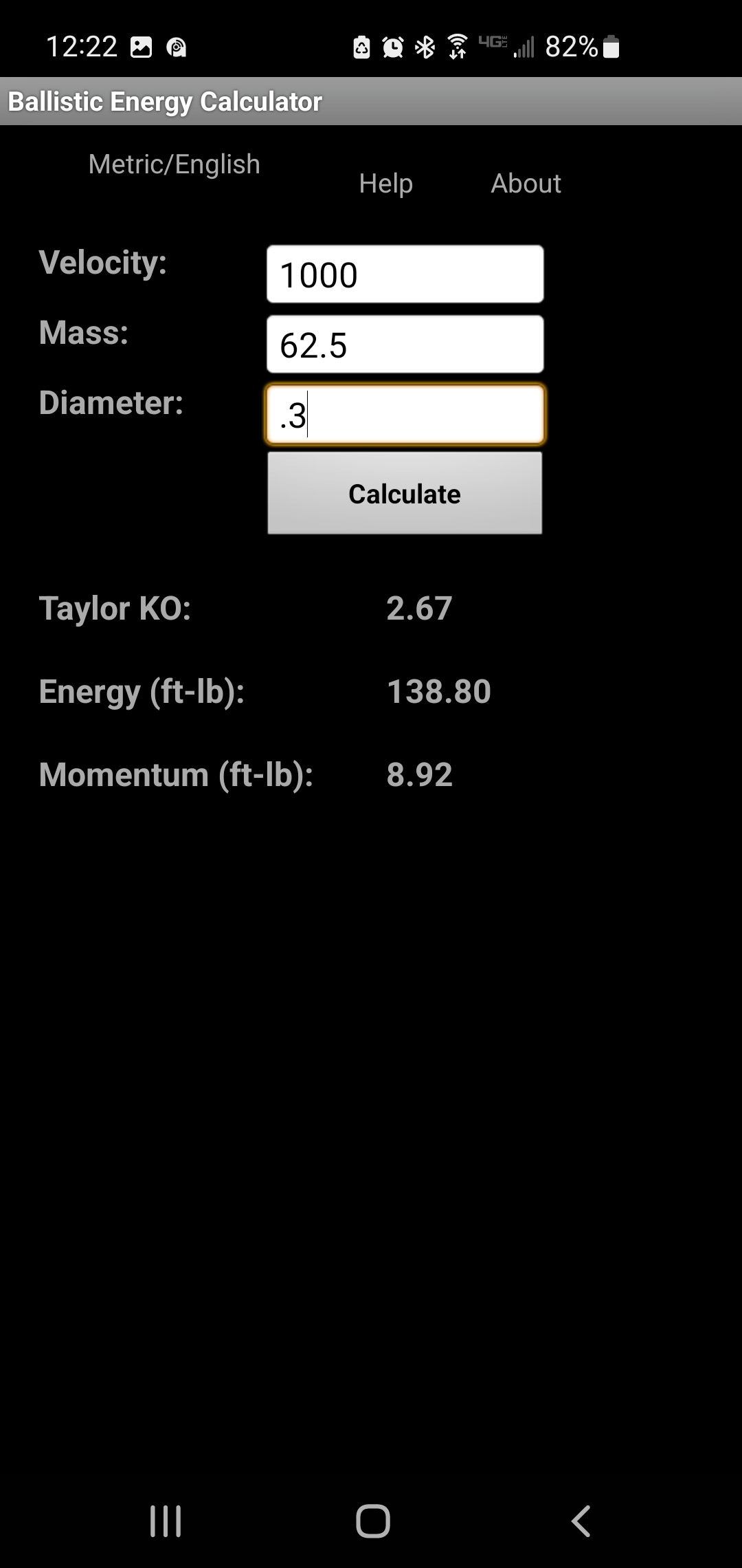

I have a Vulcan 3 in 30 cal with the new HP regulator and I'm shooting 62.5 grain slugs at 1000 fps / 1439 fpe ... Sub MOA at 100 yards, love it. I've had it almost a year and a half and zero complaints
I know it was a typo, but i did it anyways to give you a Taylor number.
