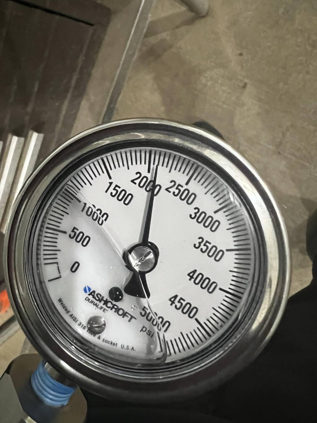

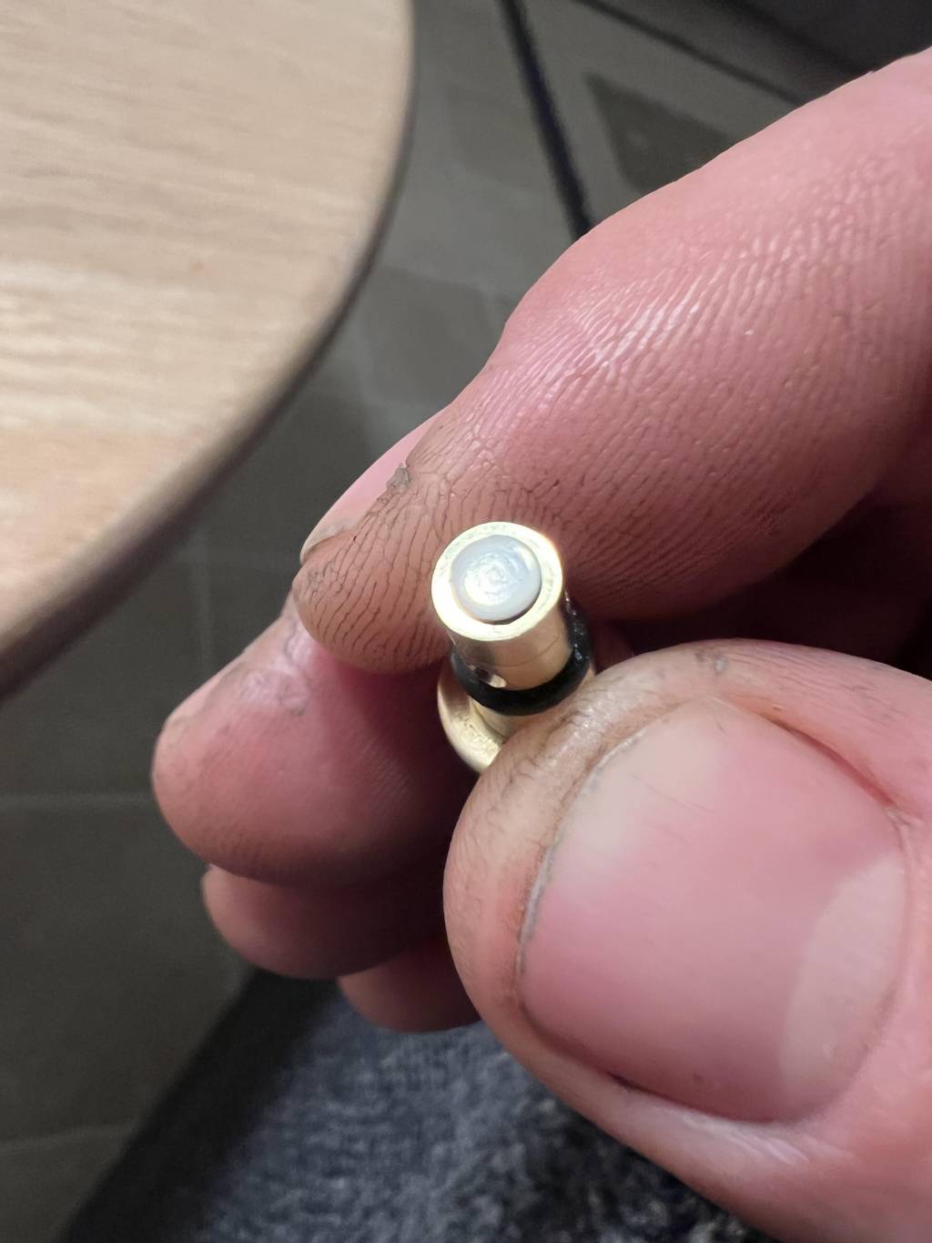

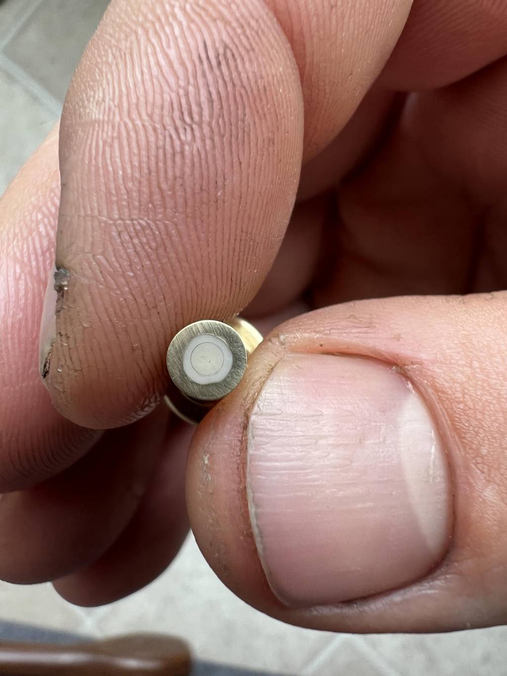

So…after spending considerable time on my leather strops with the piston head. I seem to be getting far better results. Reg refresh seem slower on the lower end of the spectrum, but it’s coming back really nice.
