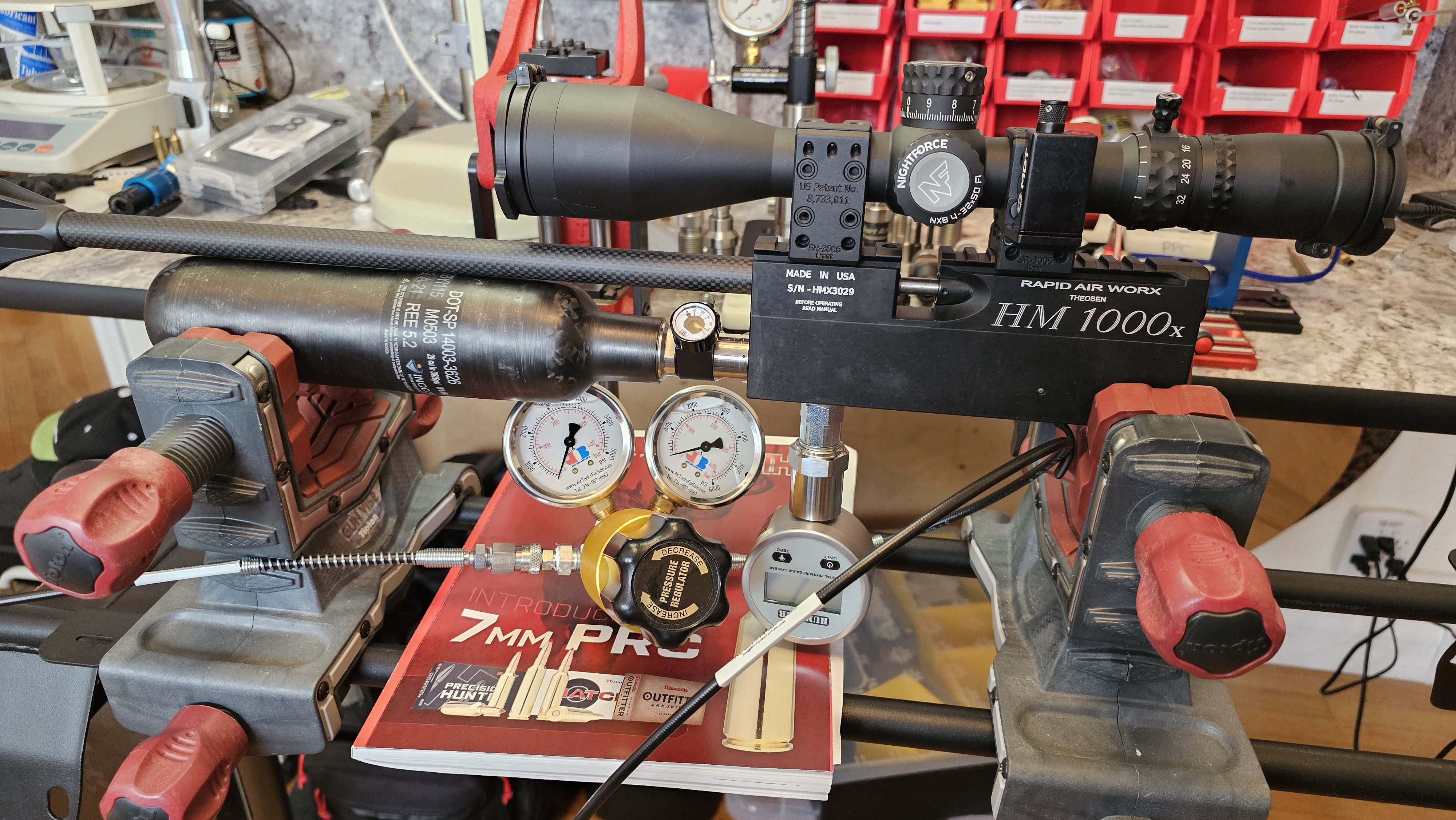

Those that have said the HUMA regulator does not hold or is less accurate than the RAW, how has this been confirmed? The gauges on air rifles are not accurate and this test should be done using accurate gauges.
I have not installed my HUMA regulator yet, but it is easier to adjust and I'm told its design will add slight volume to the plenum.
