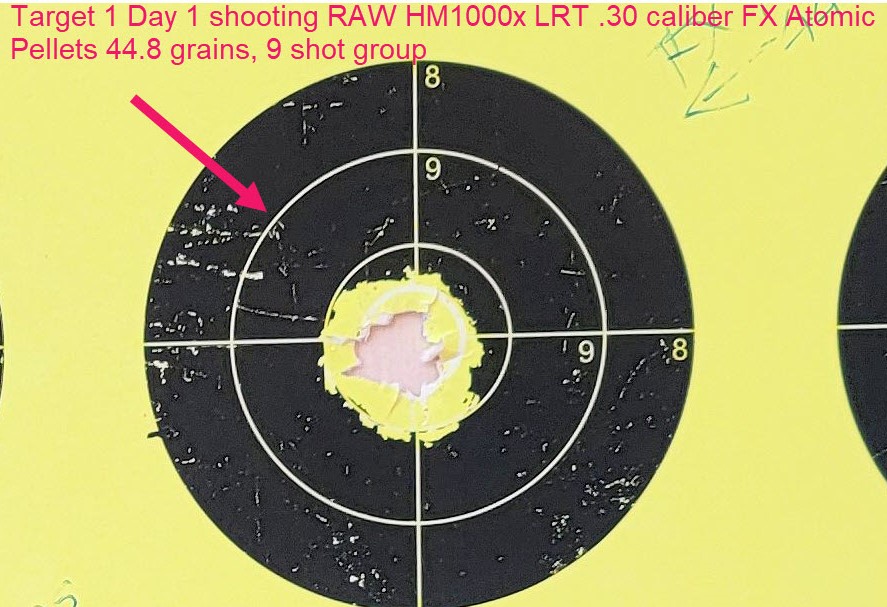

Since 2018 the RAW HM1000x's all came with the larger plenum from the .35 caliber version, probably a cost savings in manufacturing, There RAW HM1000x LRT I purchased last month shot the following nine shot group while I was zeroing the rifle at thirty-six yards on a day with a moderate breeze using FX 44.8 grain Atomic Pellets not known for their accuracy. This was group was shot with fewer than fifty pellets down the barrel.
It wasn't a great day as I had little sleep, didn't catch my setting error in my LabRadar and didn't get any velocity readings and was only able to test two pellets and one slug before the wind made shooting useless for testing for precision. I'm not sure how the latest HM1000x's will shot slugs, but I've purchase a wide assortment of pellets and slugs spending close to $350 on them to see which ones my rifle will like.

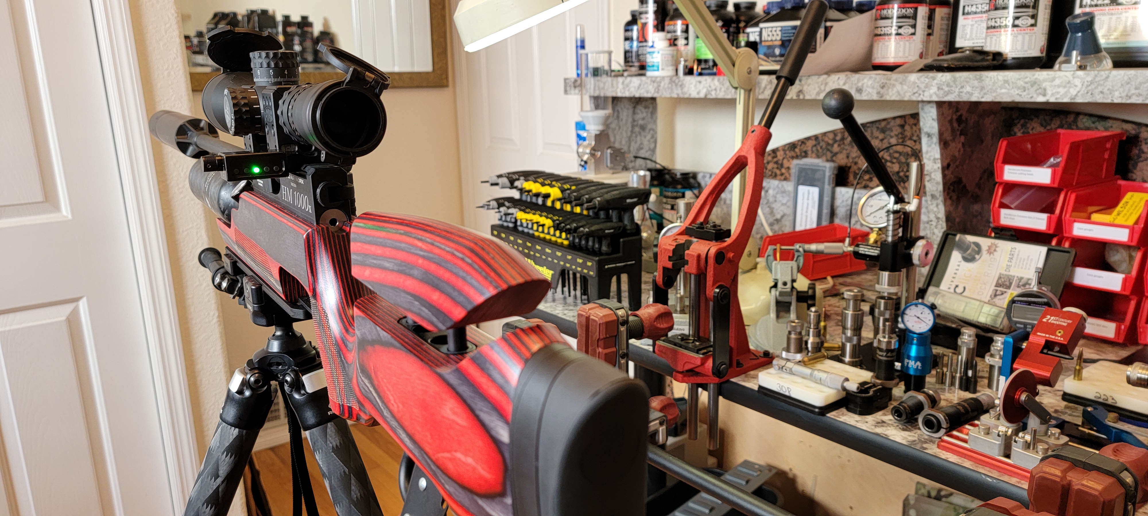

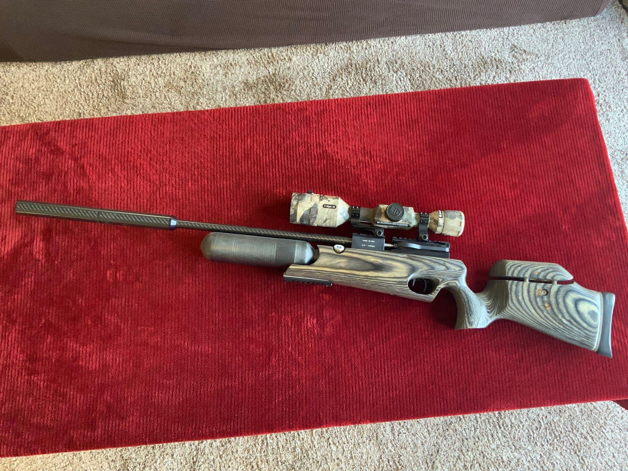

View attachment 294714Awesome group! I think and from what I've seen, the larger caliber RAW's (.25 & .30) are less slug fussy than the .22. Enjoy shooting it and I hope your barrel likes a few of the slug offerings!
