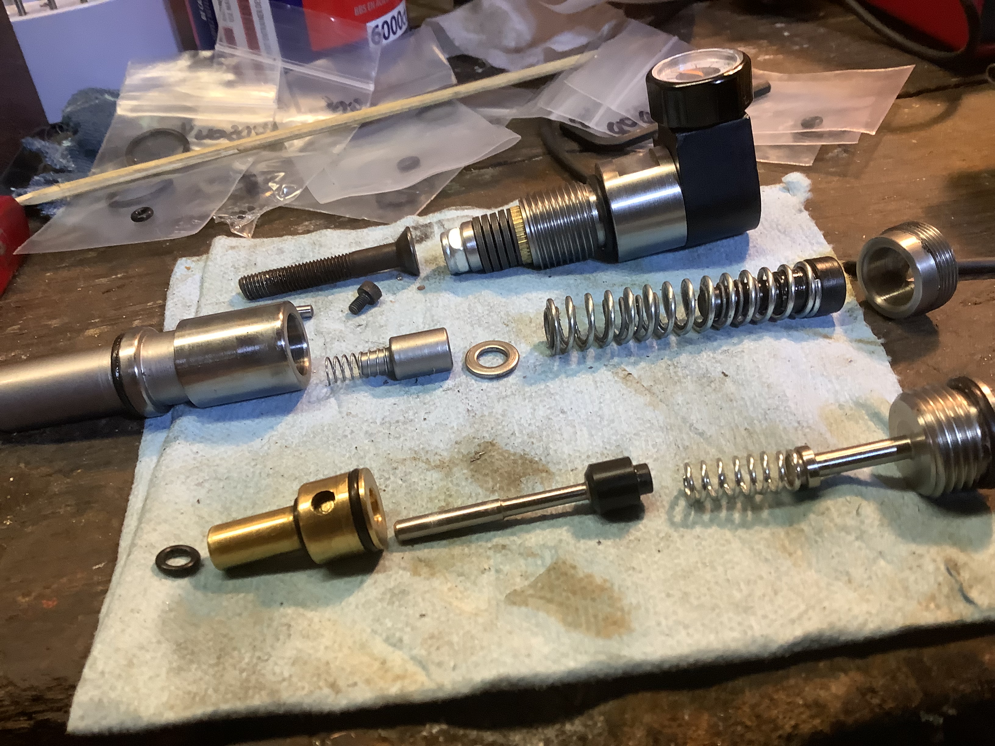

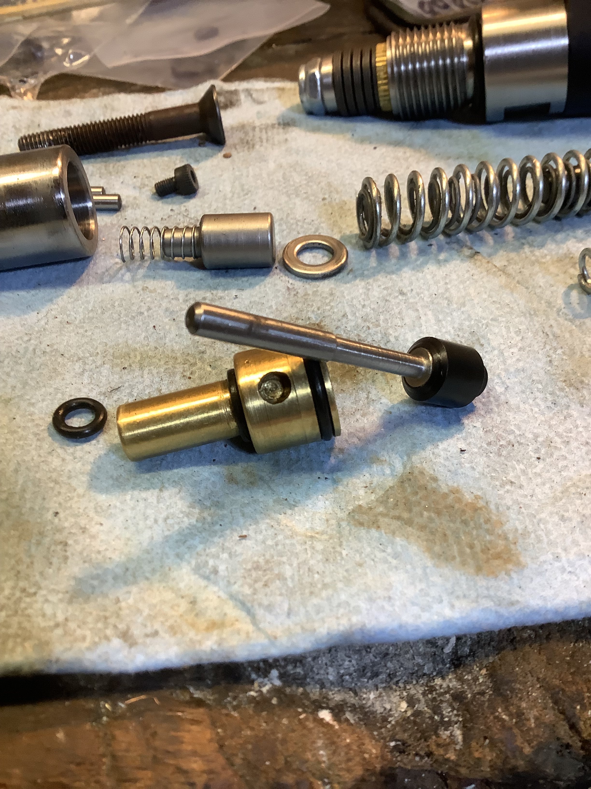

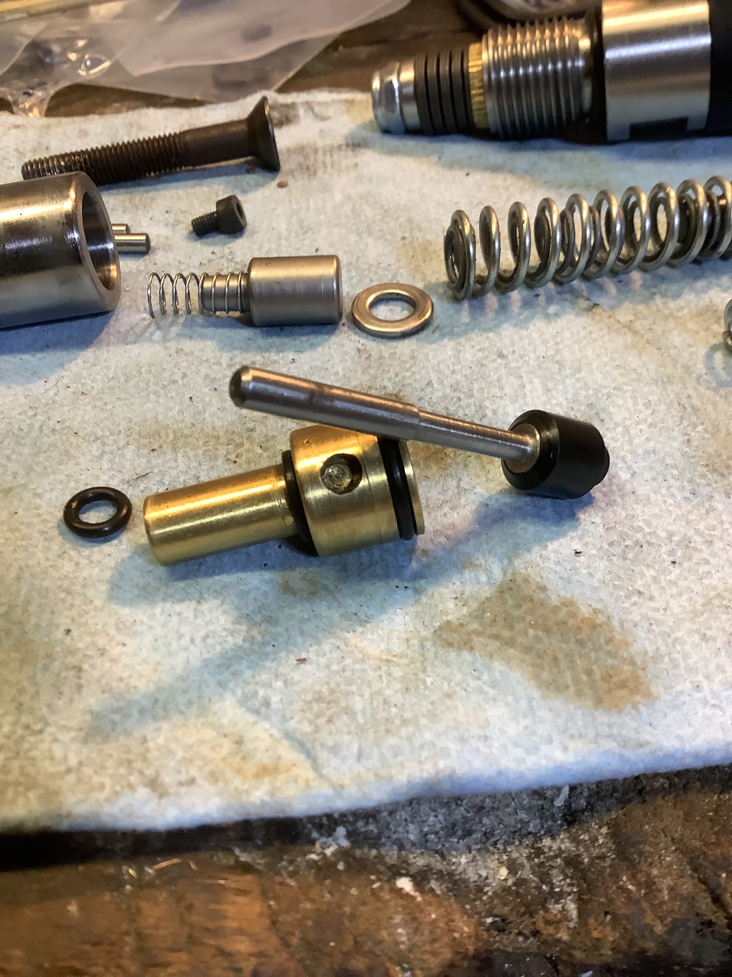

These are the parts, I have them layed out in the order they should be, I think. The regulator was rebuilt by Martin, I have not done anything to it . I didn’t have the smallest o ring installed. I hope someone will advise me if this looks correct. I have not done anything to the air bottle .

I might try replacing the o-rings on the valve again, being extra careful not to get any lint or other foreign material on the o-rings, and then give this another shot. If this doesn't work, I think I would check in with Martin about getting another valve body and stem.
One weird thing - I notice an o-ring on your hammer. Why is that there???

I think it would be helpful to keep the conversation here, just so others can benefit from learning how to resolve a similar issue with their RAW. As we know, there isn't a great amount of detailed information on resolving issues with the RAW's other than what's on the forums. If there is something you want to talk about offline about this, we can do it over email, PM, or I can give you a call (y)
I would make the suggestions in my post above, in addition to thoroughly cleaning the hammer of any lubricants (and remove that o-ring! 😁). You should also do your best to clean the inside of the chamber that the hammer slides in. You can use a dowel wrapped in a rag or paper towels moistened (not dripping wet) with isopropyl alcohol. Ideally, both the chamber and the hammer should be completely free of any lubricants, so the hammer flight is consistent. Feel free to give this a shot and post your results back here.
