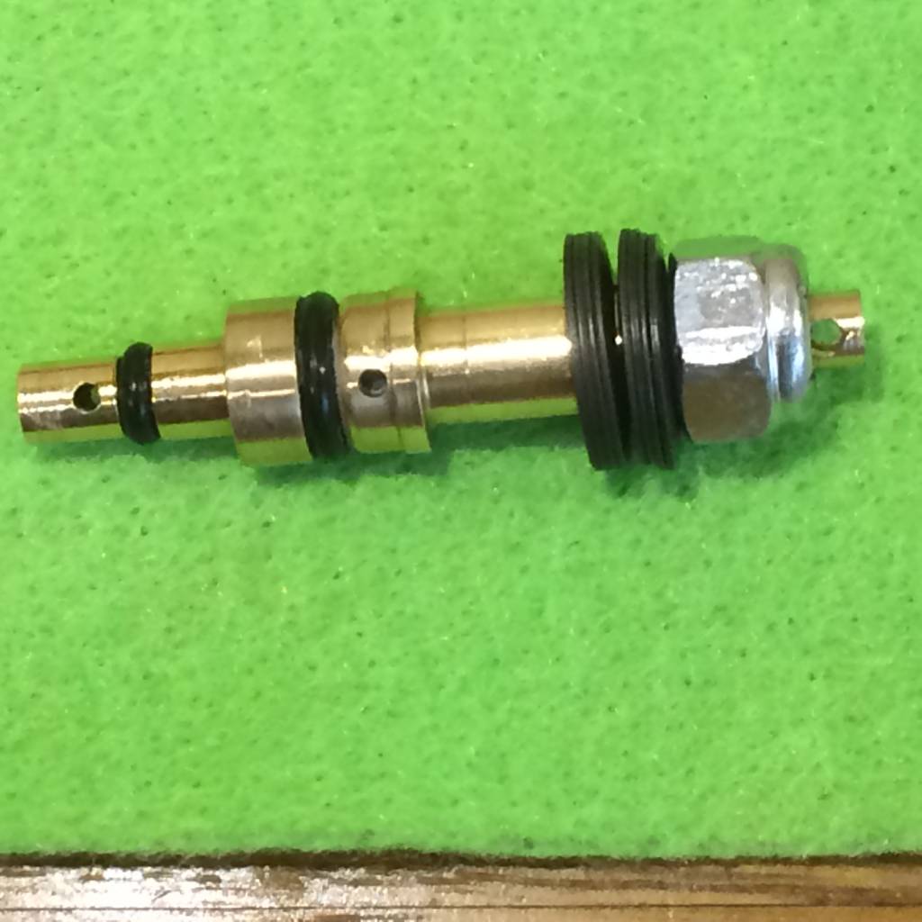

I consider it a big shame for all better manufacturers who do not have balanced valve as it has FX Airguns (Daystate Delta Wolf) or anti bounce hammer system (SSG). Balanced valves (FX) is a better option because there are much less impact forces on the valve, less trigger load and total reduced material wear. They need to be mailed this information because it is a great shame for this time and their prices...

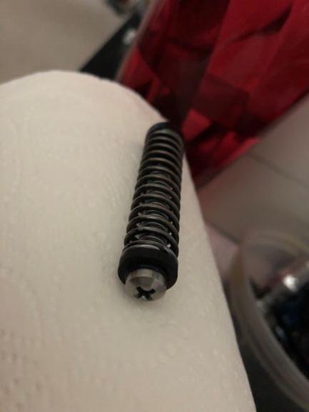

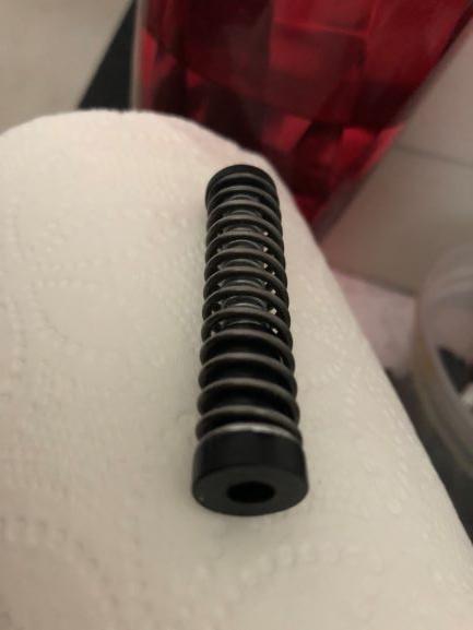

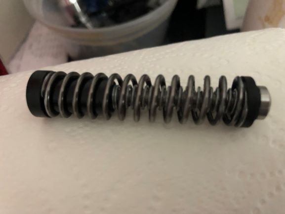

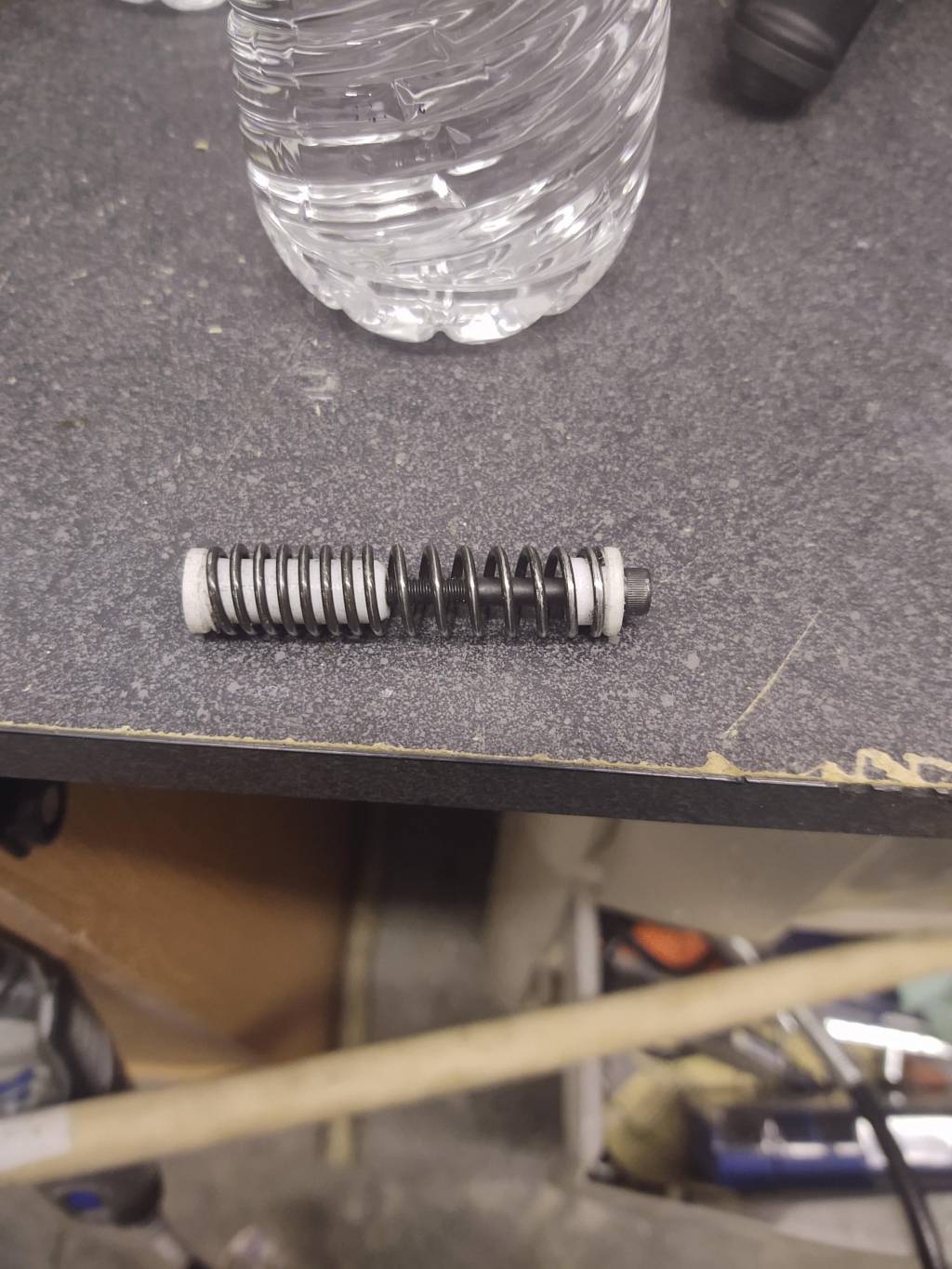

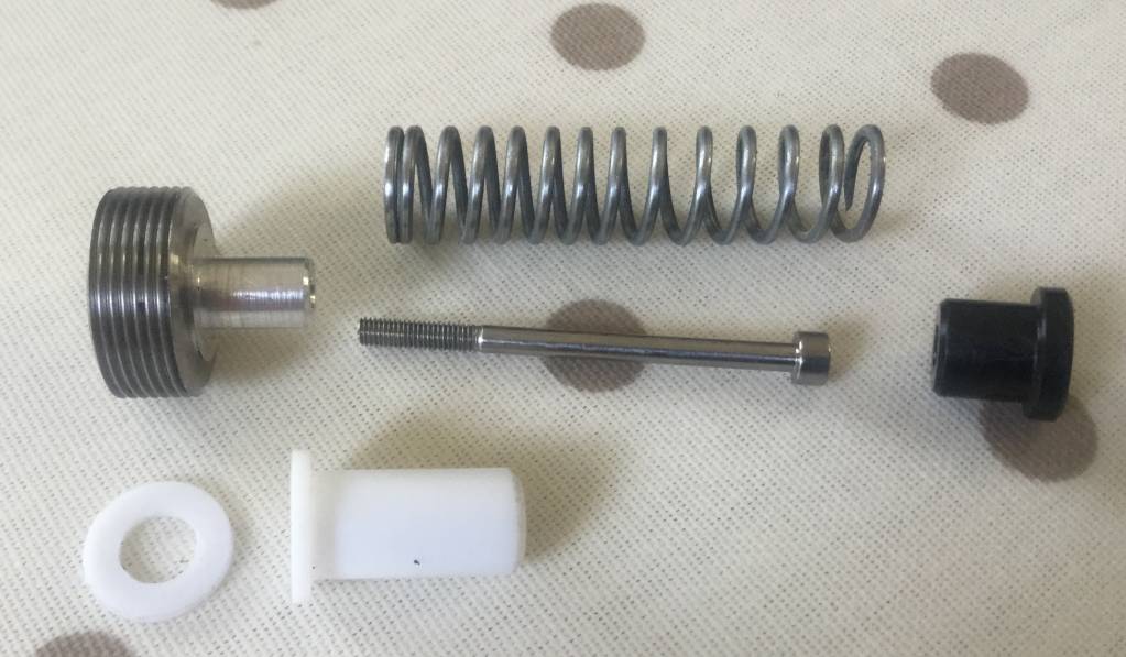

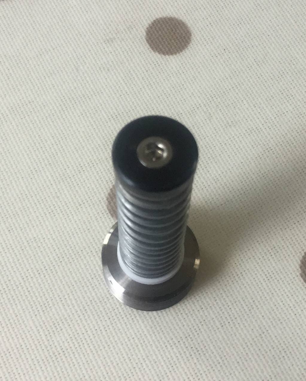

The RAW has an anti bounce device, it’s a separate weight inside the hammer that strikes the bottom of the hammer after the hammer has struck the valve. This inertia weight drastically reduces hammer bounce and increases consistency. A heavier inertia weight can improve things further, almost to the efficiency of an ssg but without the hassle of the setup.
heavy through spring inertia weight

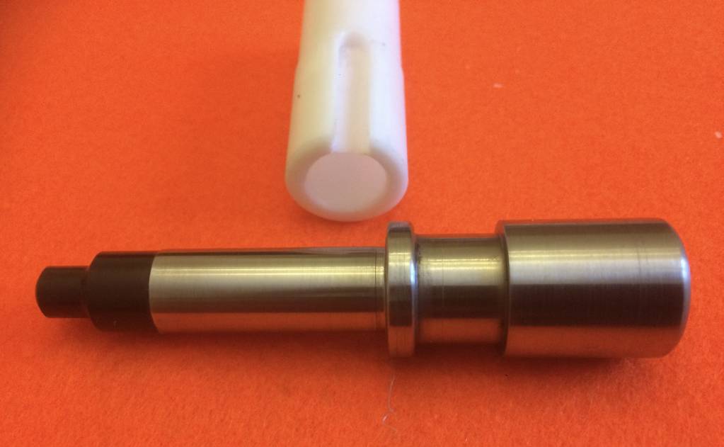

Another option for the RAW is a modified through hammer slingshot striker, this is super efficient but only in lower powered gangs due to the relatively light striker
