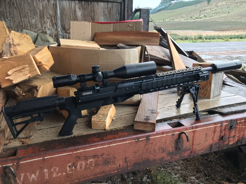

Tuning Hill's Airgun Performance Kits for Armada .22 ?
I have been talking to Tim at Hill's Airguns about modifications to an Armada .22, raising the FPS to 900+... and get rid of the PING that is driving crazy !
I have been told that his products are high quality and I can't go wrong with getting his parts to modify my Airgun.
I feel by getting Tim to do the complete job, using all his parts will allow the gun to work better, I am leaning towards having him do the work.
Any comments

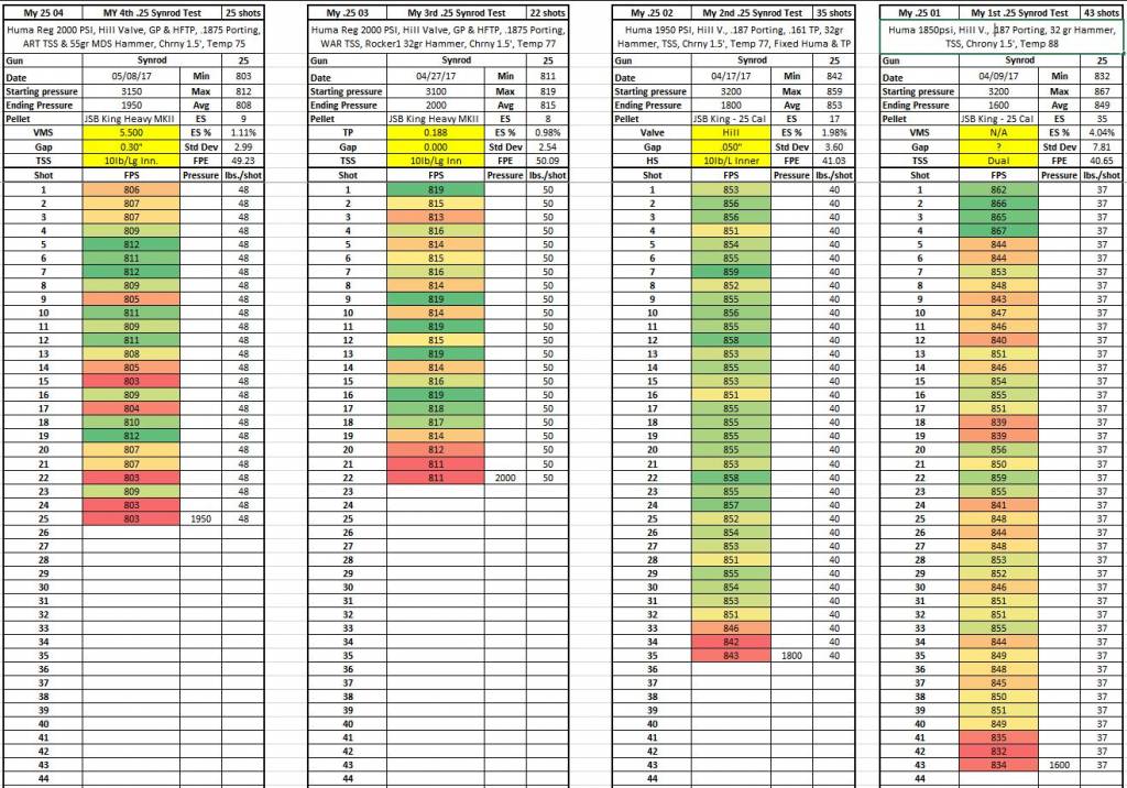

I believe that Hill would be a good choice for you. Many good reports about his parts in the past. I played around with his valve for a while in my .25 Marauder and liked it. Attached are some tunes I did with the Hill valve and Hill gauge block only. I always wanted his peek poppet, but started messing with other parts, which are not available now, but the Hill still is. I found this pic from my past tunes. Hill's tune will probably be even better with the full matched Hill kit.
