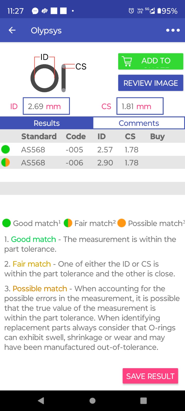

you mean dash sizes 5,6 or 7?.a new o ring with me measure OD 5.85,CS 1.69 and ID 2.34 mm using a electronic vernier which frankly doesnt fit the dash sizes mentioned?
Those dimensions are a close match to a -005.
Basing that on the cross-section being very close to 0.070", which excludes the metric families of 1.5mm and 2mm since they are each about ten thousandths smaller or larger, respectively. So with it established as being in the "dash" family of standard O-rings (-00x), the closest match is a -005.
i think you are right...this is the approx size courtsey the OLYPSYS android free app...0005 size is the nearest best measure.are these NBR 90?

compression?you mean inside the pump
Just referring to the compression of the rings between the ID and OD, not air compression. Slightly larger (1.78 vs 1.69 as measured above your post) would be preferred rather than slightly smaller. Obviously, the measurements need to be fairly close all around to do the job properly and allow the O-ring to last.
