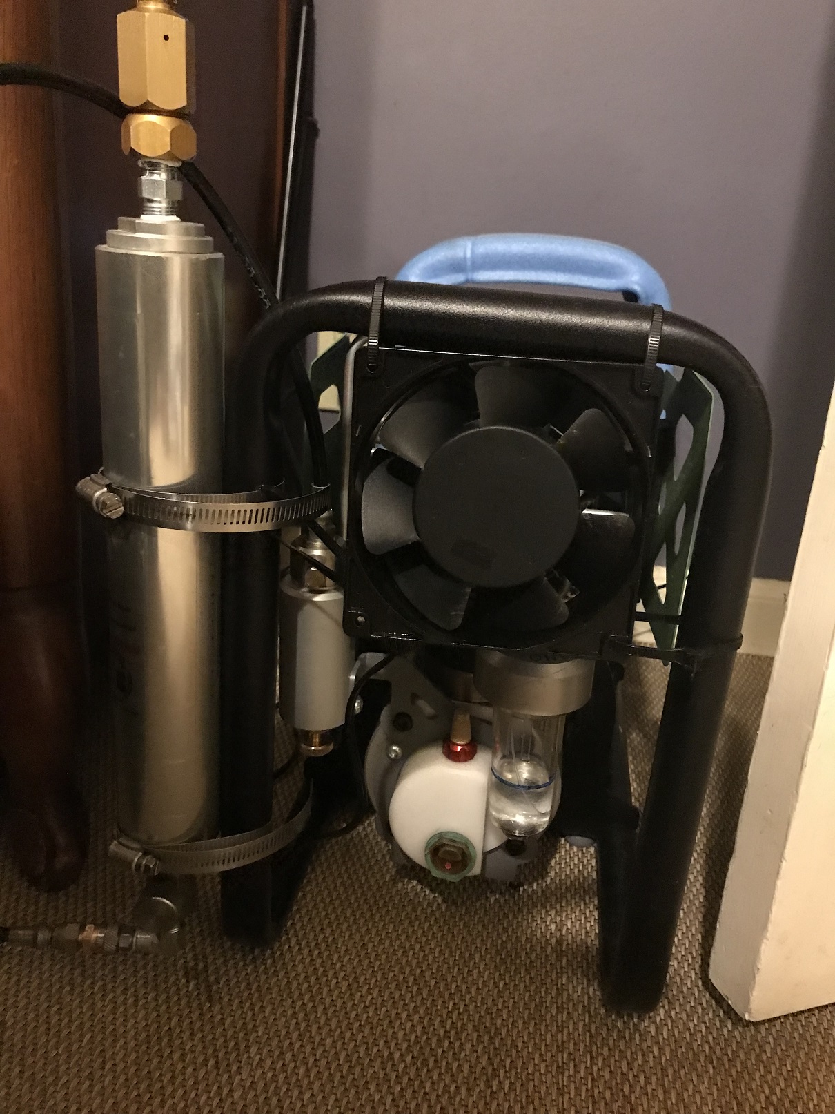

Reading through this thread pleasantly reaffirms for me that Hill EC3000 is a good compressor for me. I especially like the concept of installing the cotton filter at the end of the fill line. I have a desiccant filter on my intake and between it and the intake a small cotton filter to intercept any desiccant particles that may enter the intake. Living in Colorado I pick low humidity days to fill air guns. I have thought to get a small tank for topping of 480 to 580 cc bottles. I also have begun using a fan to help cool the compressor.
I have been thinking about an air dryer filter on the intake side of my Hill compressor. Can you describe your set-up? Did you tie into the threads used to connect the stock filter to the intake check valve, or did you keep the original filter and Rube Goldberg the dryer in front of it? If so, what was the thread size? What size piping so as not to restrict flow? I'm leaning to a double cylinder system, each filled with desiccant beads and tied together with a "Y" (to not restrict flow) and going into a particulate filter (an inline $15 cylinder type) before screwing into the pump intake, similar to what you describe.

I have added the alpha filter on mine and have no moisture in any of my guns. I don't use it to top off tanks, so I can't say but the combination has been working very well.
