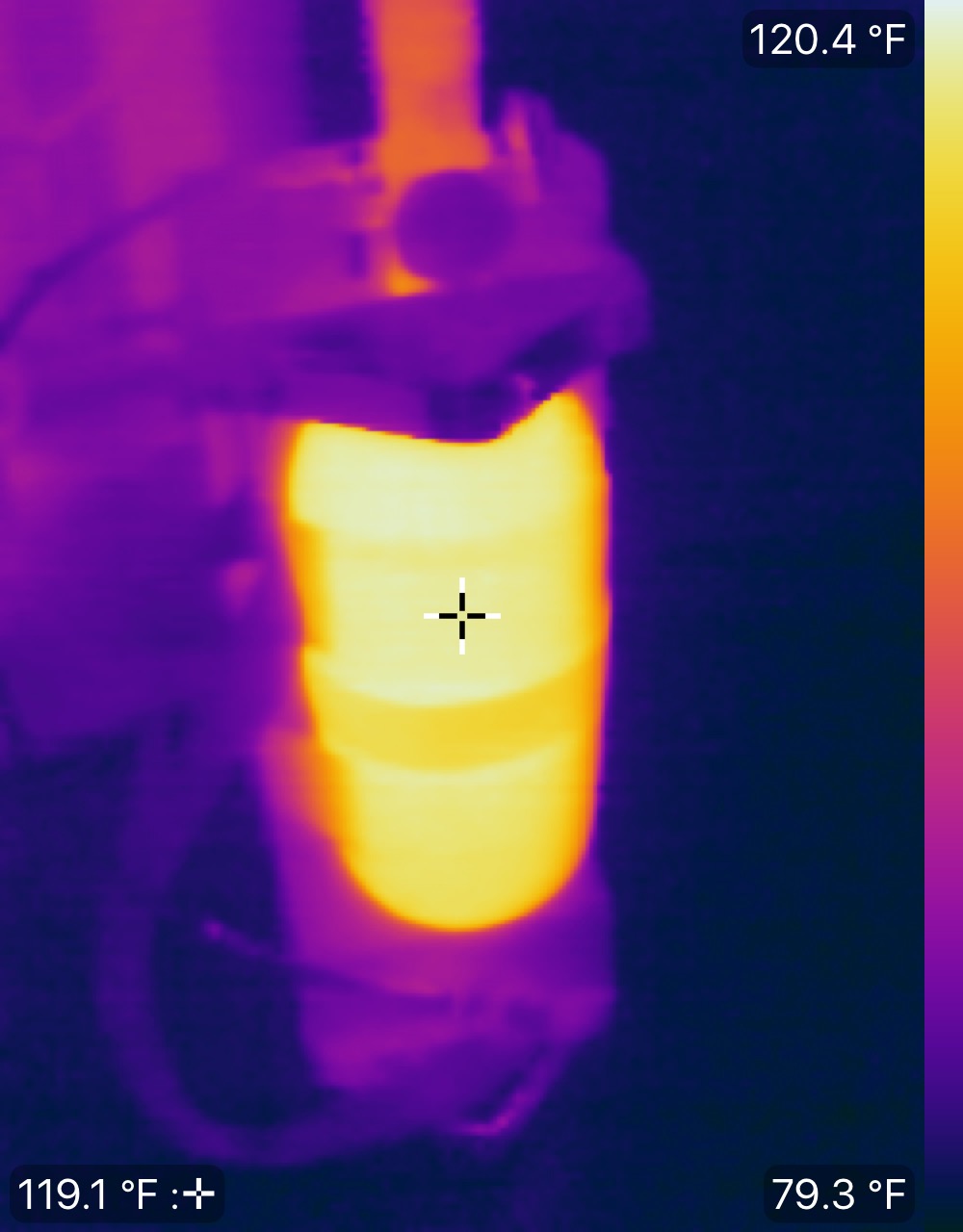

2 hours run time.... about 25 fills each on two impacts and 25 more on a Crown Continuum... thus far I am impressed.. my only complaint is it fills too fast.... fill to 250 bar when the dust settles is really 230 bar... due to a "hot" fill... this unit goes from 150-250 bar in about 2 min..... whatever they changed with the recall when these first came out they have fixed in spades.... this fills FAST

Yep, gas laws in action. Has nothing to do with "time" unless you expect the rifle or receiving vessle to act as a heat sink :) :p

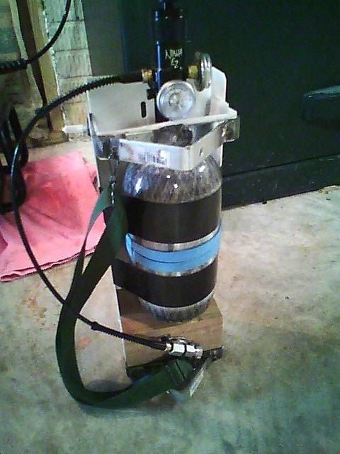

One thing, if you gents are using the EC-1000, you definitely need a good water/oil separator. I opened mine up and tons of moisture was at the intake end.
I set mine to 260 bar (for a 250 fill) to skirt around the pressure drop (heat) phenomenon.
