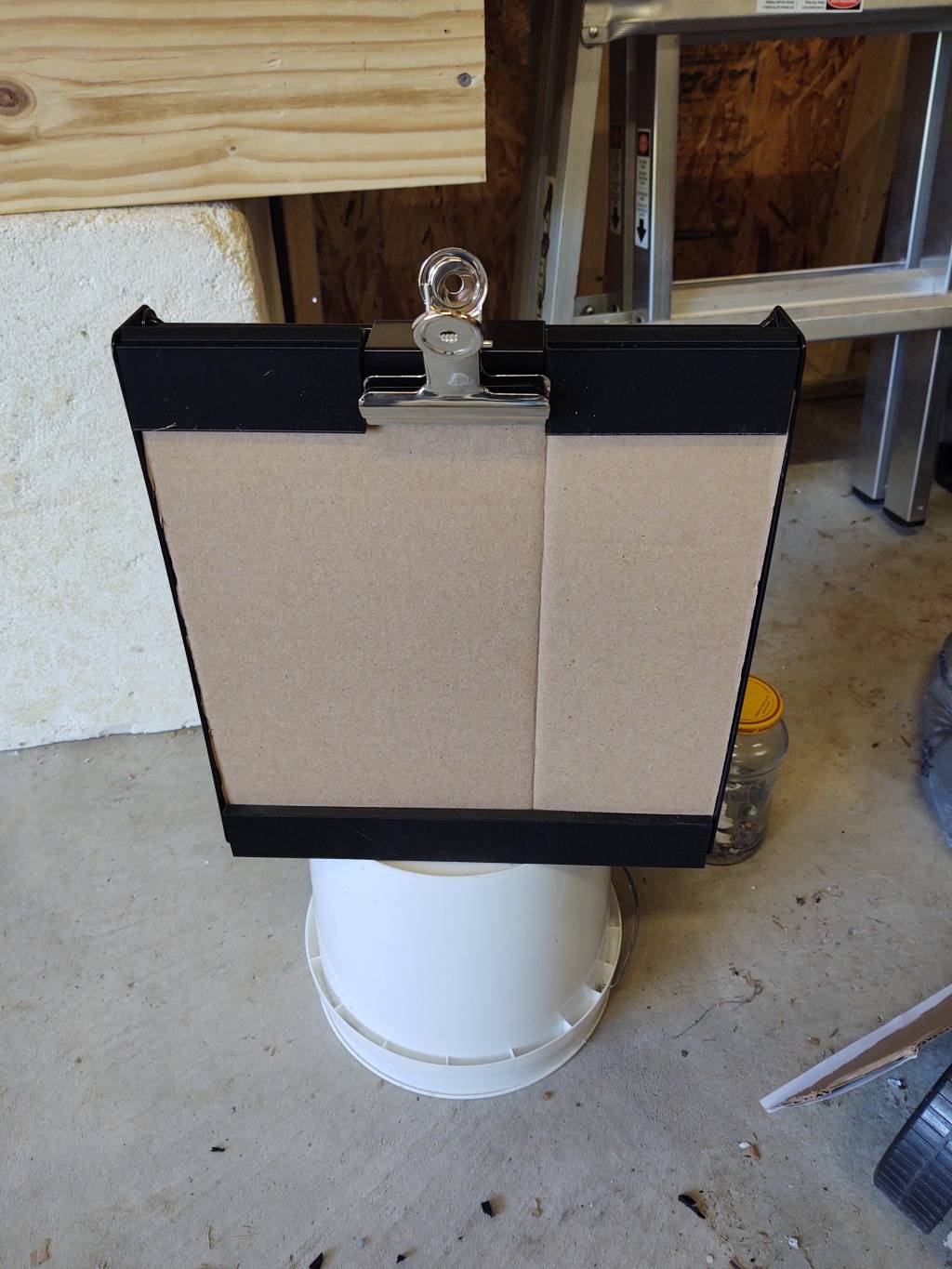

FWIW, the plastic parts I printed and cardboard have pretty much kept anything from coming out of mine.

Cover the entire face of the trap with cardboard and stick your targets to that. I have an old trap like that from I believe Outers. It actually stated to cover the opening completely to eliminate lead spatter. Try it, it works great and you can see how much spatter there was as it cuts into the cardboard. The more power you have behind each round the more spatter. I wanted a wider trap at one point so I bought 2 bolt together traps and welded then into one large trap.

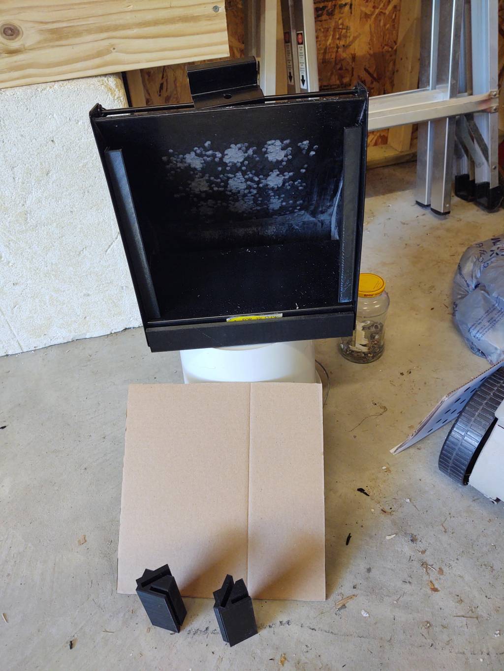

That is a big part of it. Here's a picture of mine which has been in use for a few months now. If you look at the sides along the back plate you can see the fine white lead powder from the splatter as the pellet breaks up when hitting it. I think the bigger problem is a shot goes off the back plate, hits the vertical back, and then hits the bottom at the back of the thing at close to 90 degrees, at which point it has lost enough energy that it bounces instead of deforming or breaking up more. It's the only way I can explain a relatively big piece of lead coming out over the top of the target/cardboard.

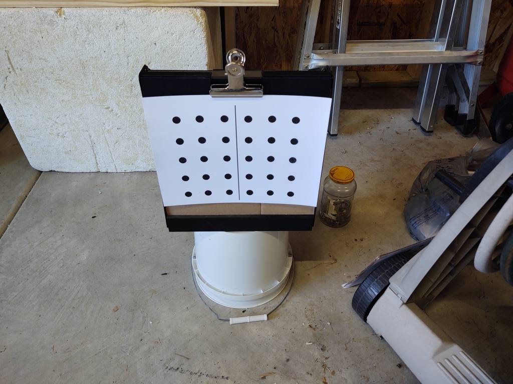

This is my final solution to the problem. 3d printed 2 pieces for the top that have slots for the cardboard and the stopping plate, a pair blockers to stick on the sides to keep stuff from getting past the cardboard there, and another piece to hold the bottom of the cardboard. I have different pieces of cardboard for the different targets I use and really only have to replace the one that's used when sighting stuff in because of the random groups that eventually merge and create a bigger hole.
I can send you the files if you want them to print out. The side pieces are a little too long but since they're plastic it's easy enough to just cut them to the correct size.
